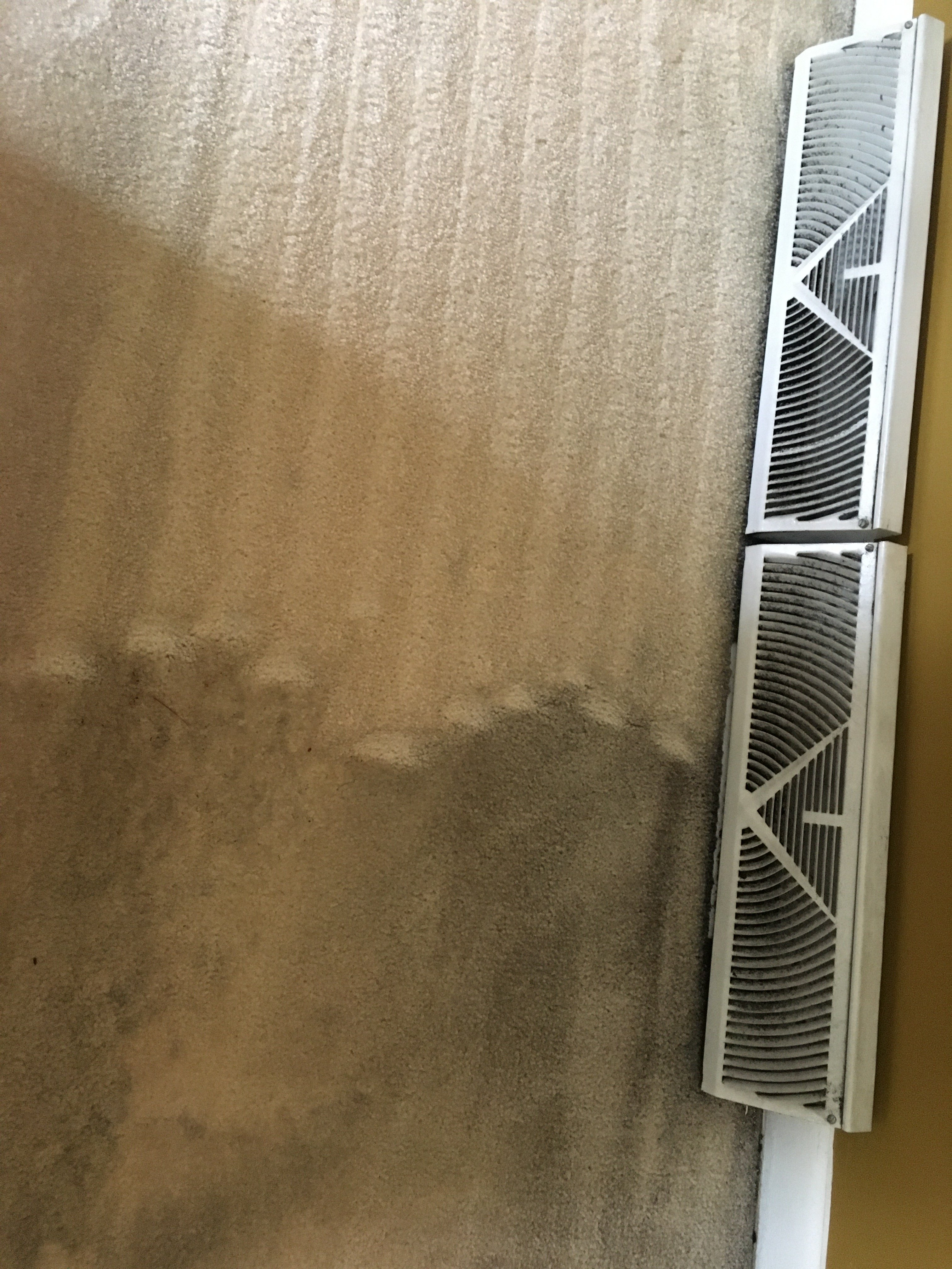

But, One customer for whom I clean fairly often has some dandy's. High end home.
Ultra clean house. ( Bolden, underling, italic the ultra clean part.) But,
White , tufted nylon.

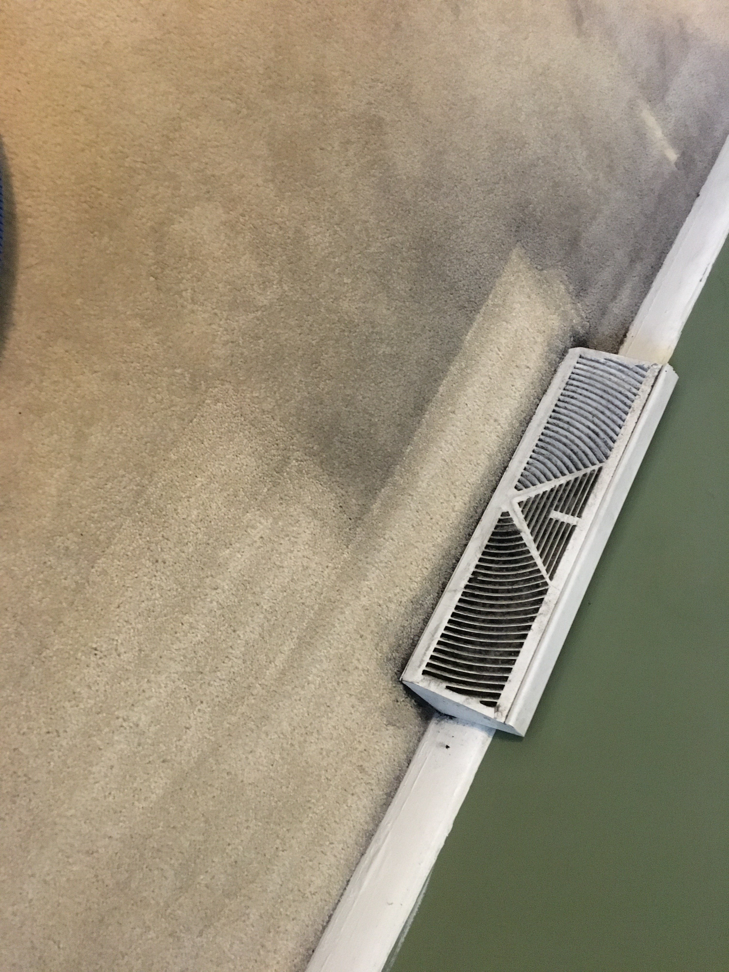

Terrible filtration throughout. walls, doorways , all the usual.. In the upstairs, the one time I cleaned up there( as they never go up or use it) it was awful. One chair with a skirt that hung had the perfect down to the floor had a perfect outline of the skirt when I moved it.
Anyhow, on the main level, in the living room where they never walk there are lines. Perfectly straight lines . squares , that correspond to the walls in the finished basement. Every time I go, ,I work on them. Because it bothers me that I can not improve . Have not gotten them out yet. All the usuall recommended stuff. and aggressive. Even OPed with aggressive bonnets, and various juices. after HWEing with tools.

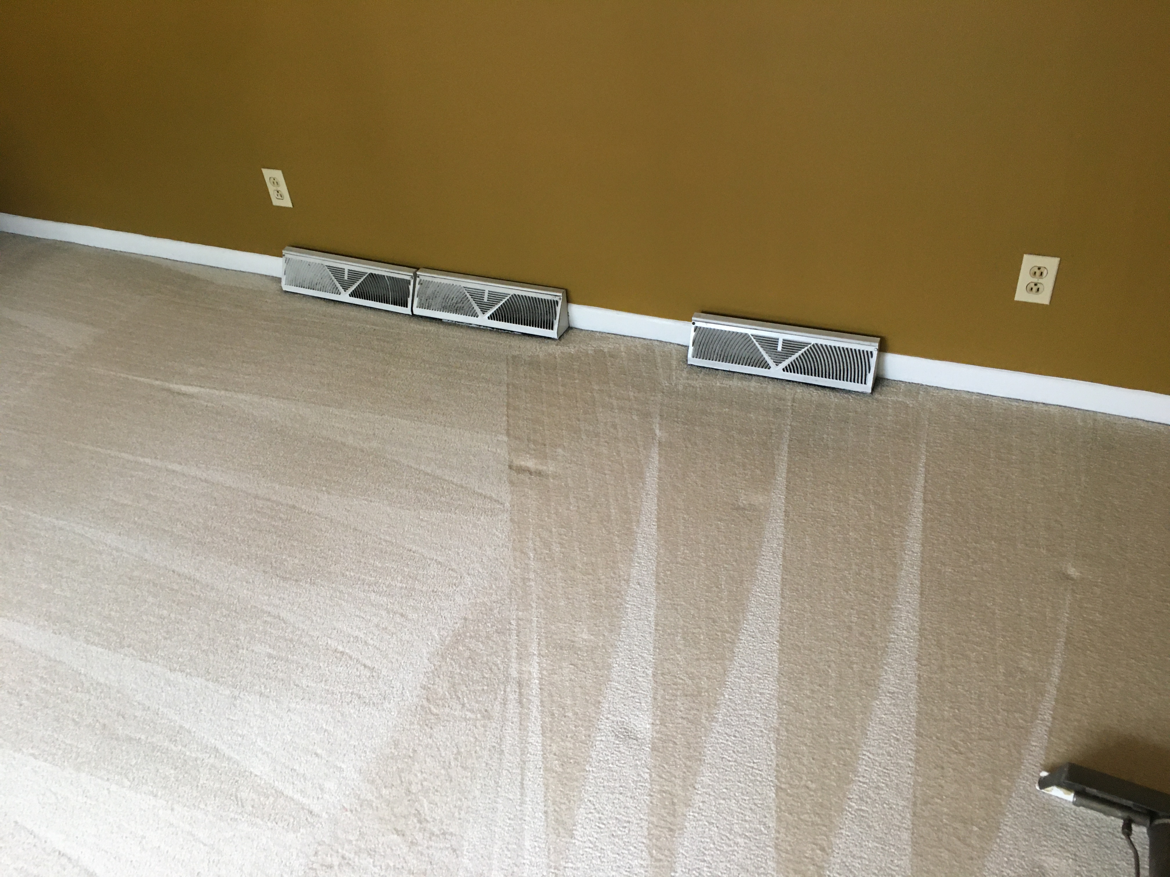

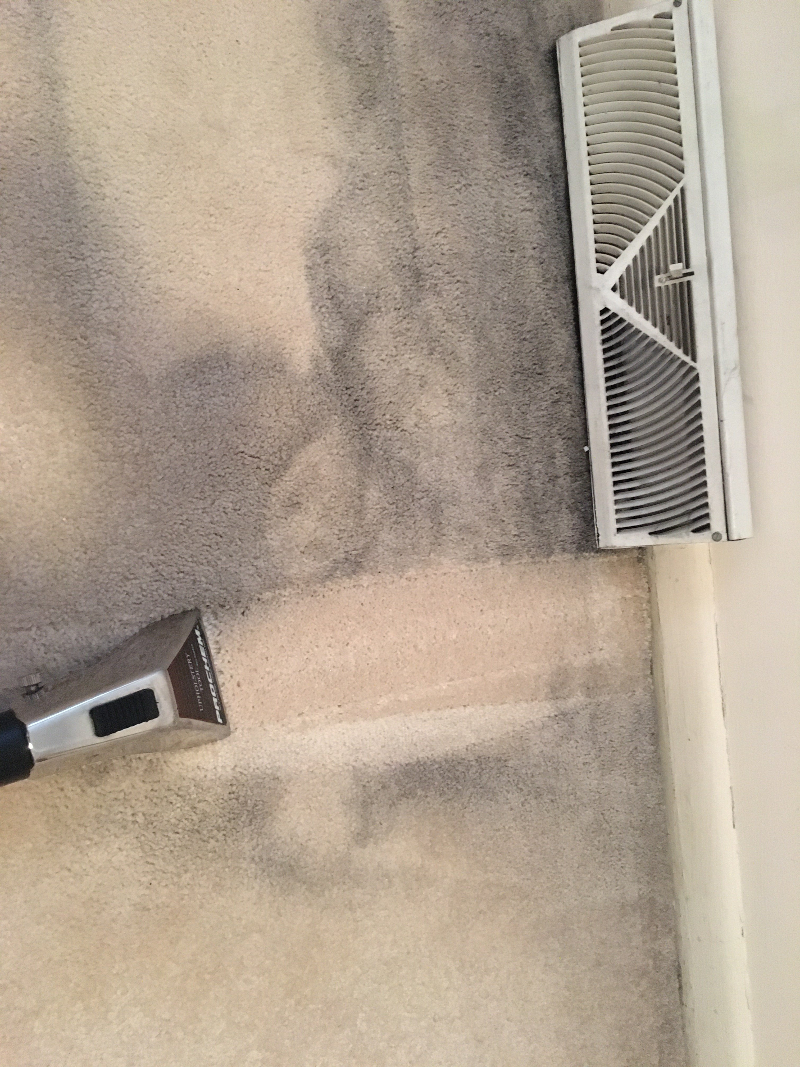

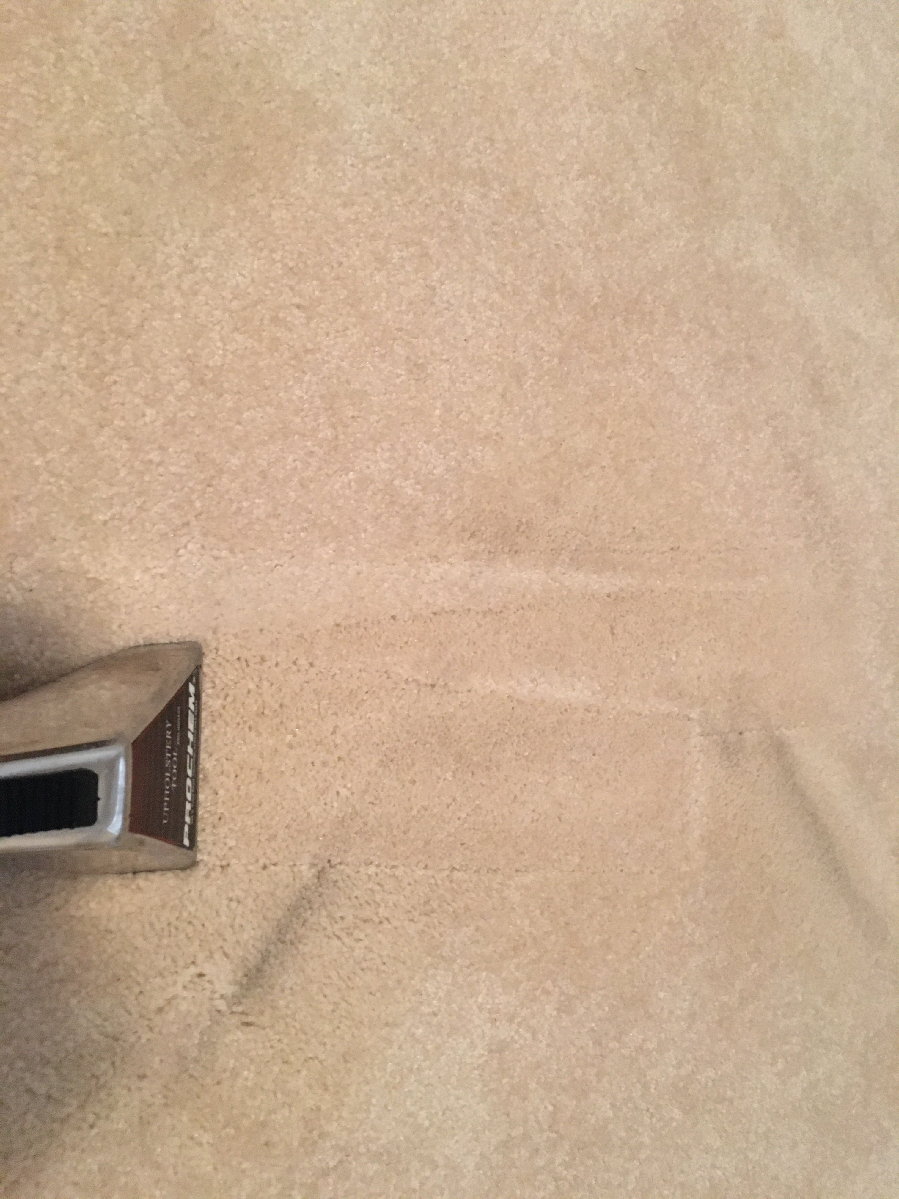

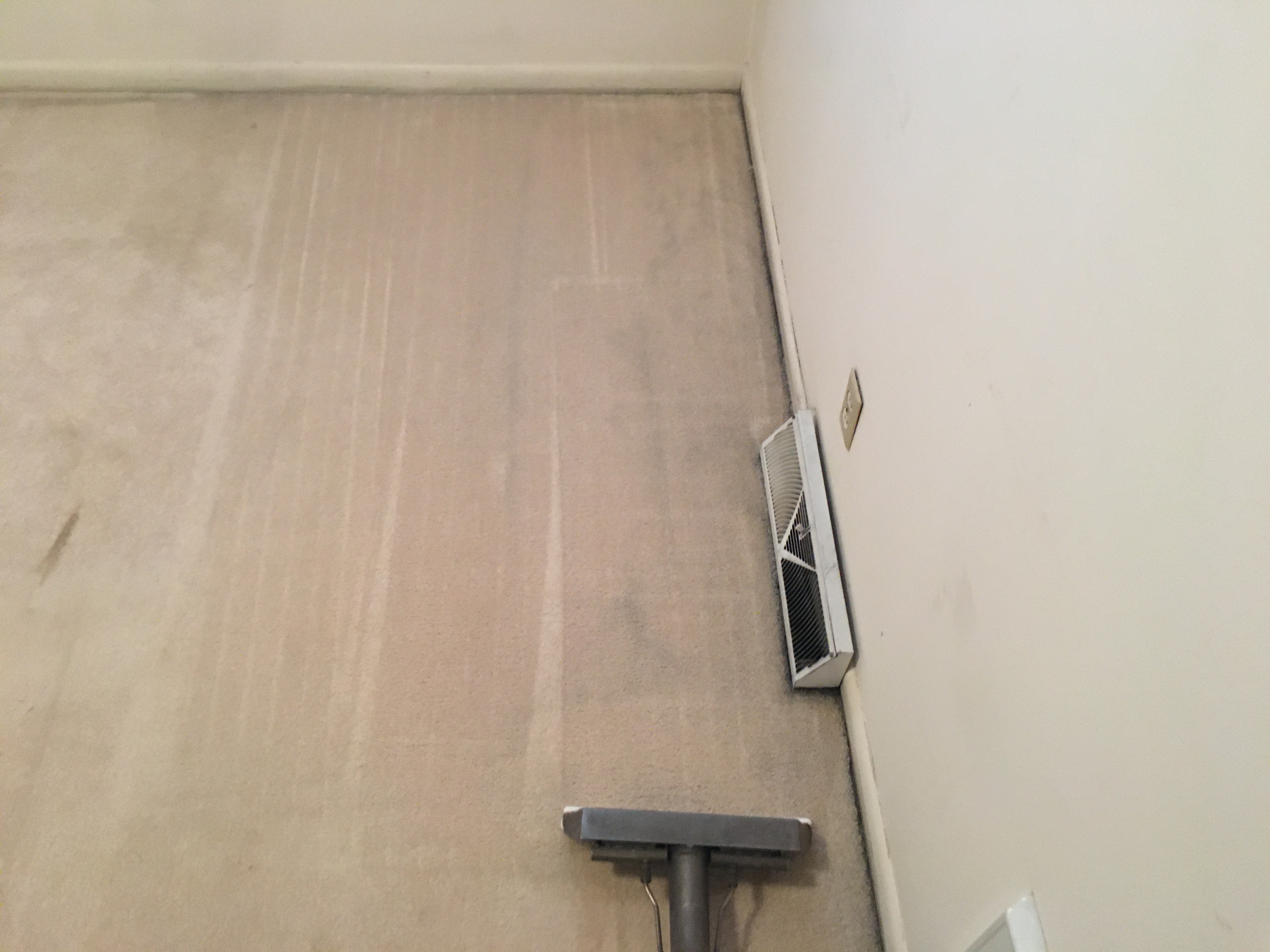

I’m very pleased with Prochem ultrapac renovate
It didn’t come out perfect, but it was presentable
