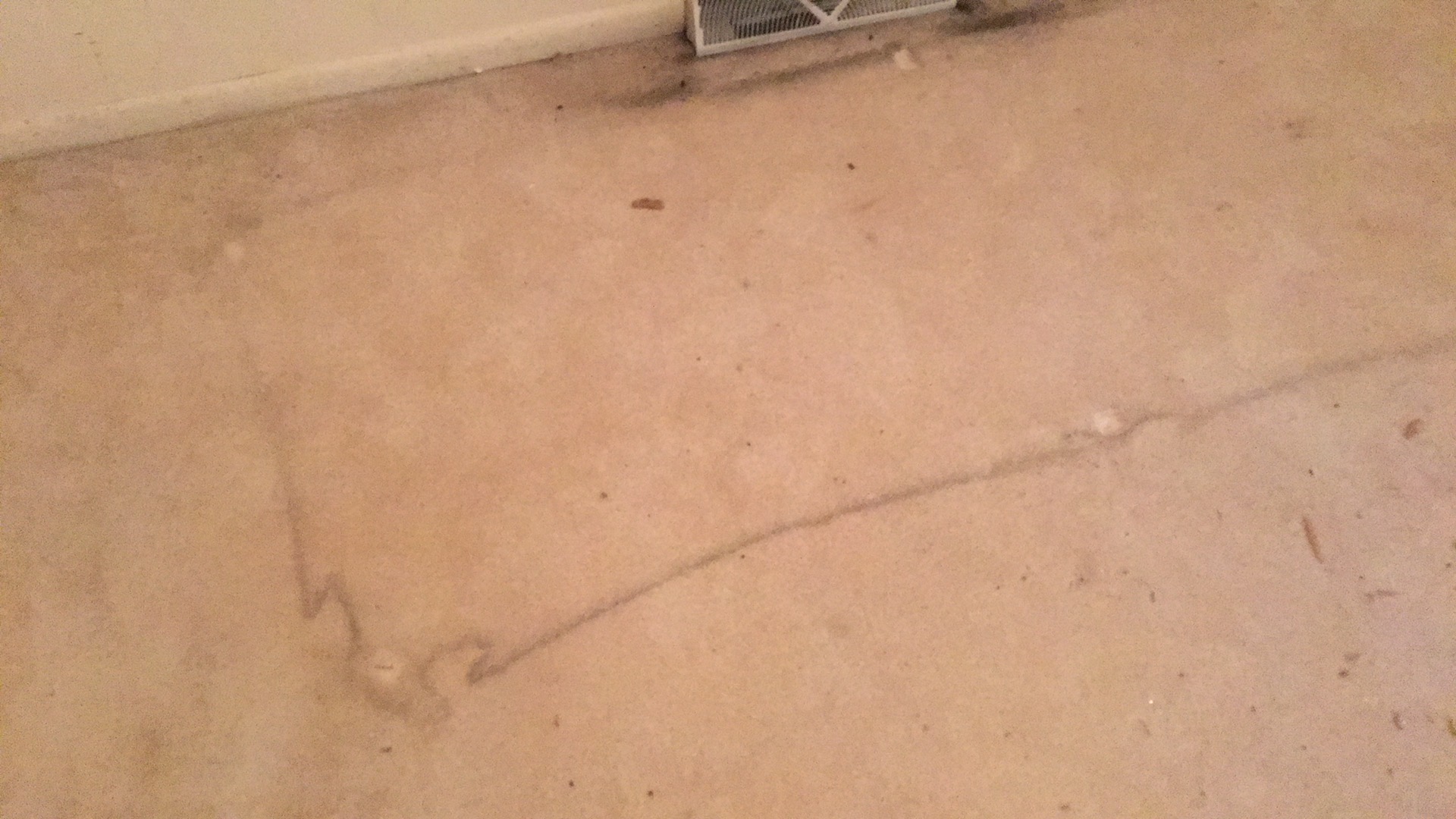

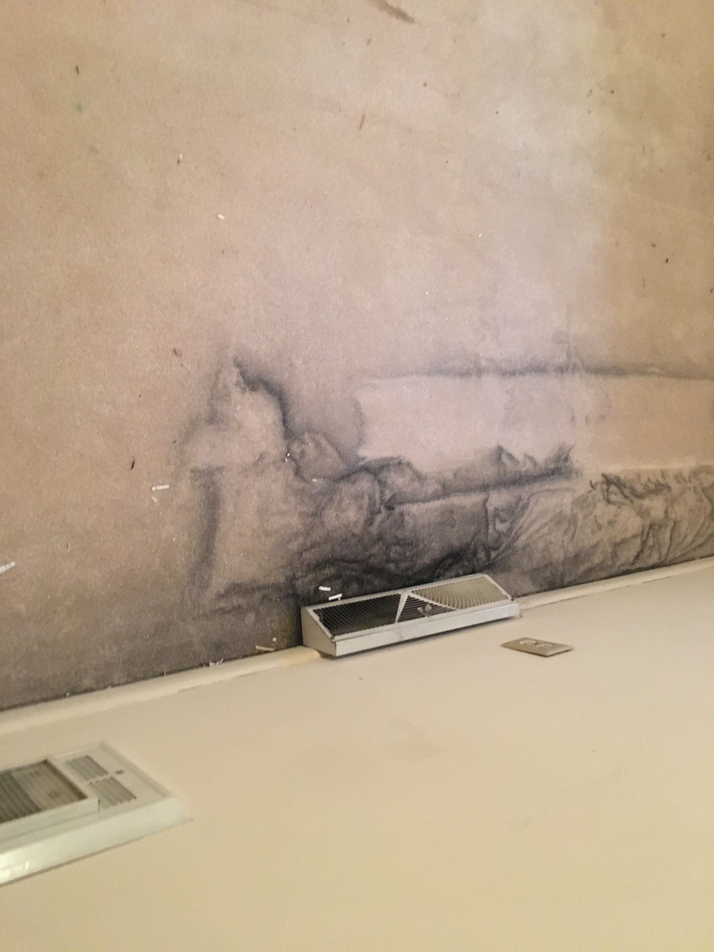

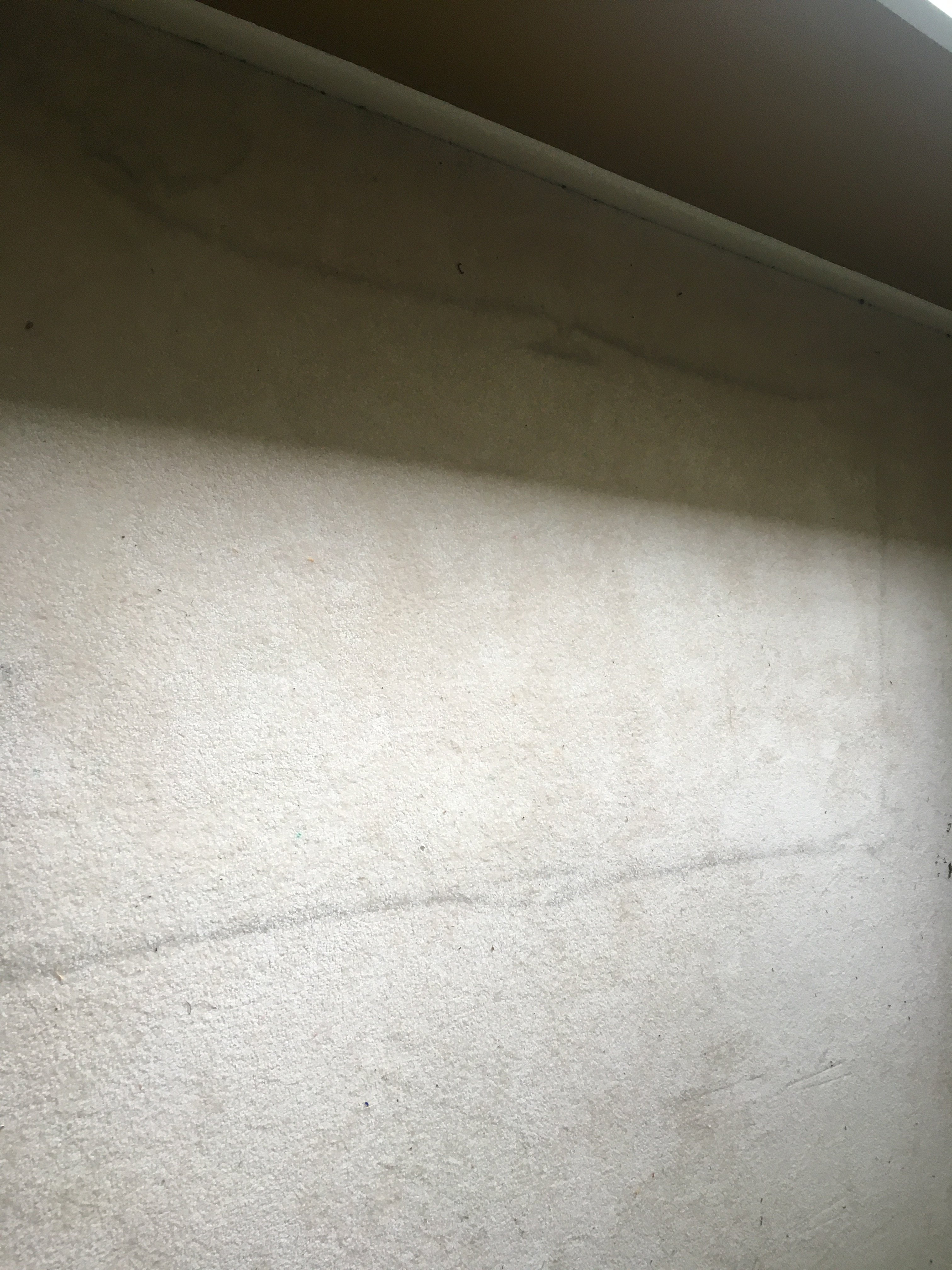

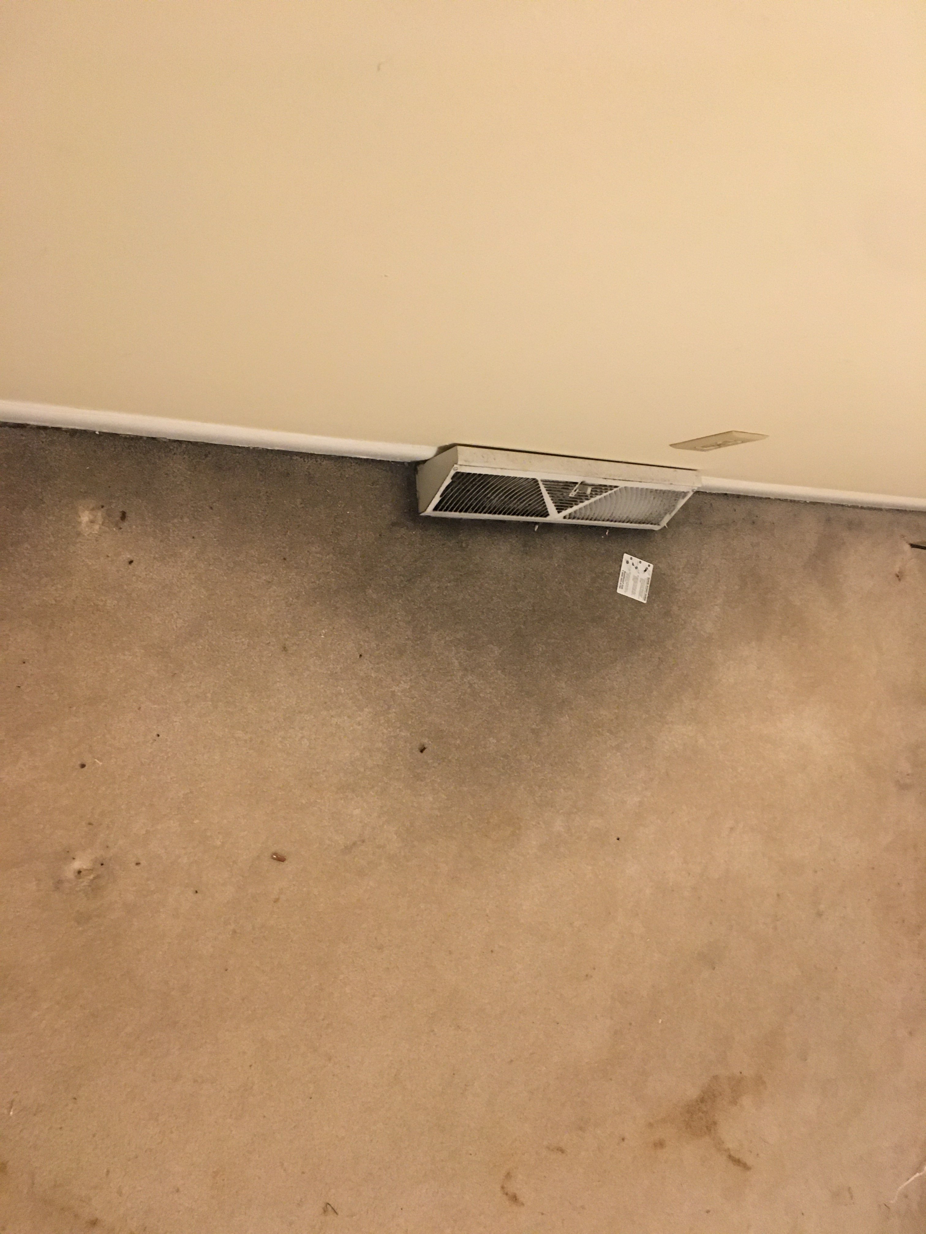

Worst air filtration I’ve seen yet
14,634
What should I attack it with?

Anyone on here ever used this on my type of situation?
The renovate is a powerful solution and should help. It needs to be scrubbed in and in this case, rinsed with an alkaline rinse like dry slurry. You can always bring the ph down later with some browning treatment if that's a concern.

I've had good results with Prochem Filter Out, but on that one, I would be sure and let them know to not expect a miracle. I screwed myself this summer by not letting the customer know that it ain't all coming out. It wasn't quite as bad as that one, but it was close.

A new utility Blade in your knife.
Cut into 2 ft wide strips so it's easier to roll up and carry outside.
Seriously I would boost whatever spray you use with citrus and scrub.
Give below the knee expectations

Yeah, if this job gets approved, I think I'll use my prochem upholstery tool 500psi on a spot first.
And if no help, I'll just use my wand
