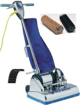

Heavy pile brush (Like a Certified pile brush) and vac is quickest way

rent a Cert pile brush to rip it off the fiber to the base
Follow up with a good upright vac

I'm with Larry. Don't get it wet anymore it needs to be vaccd out with a pile lifter or equivalent.

A pile lifter on CGD? Rots of ruck!
Pile lifters would work good on pile! Duhhh
They ain't shit on glue down!. 🙄
Reactions: Mark Saiger
Pile lifters would good on pile! Duhhh they ain't shit on glue down.
you're in the right job NOW cleaning toilets and flirting with gehy chics
if a CRB was heavier, that would work pretty quick too.
The Cert pile brush can get more weight on the brush though by lifting the wheels off the carpet

It could be from an encap type product. I cleaned a place that sells woman's wigs and nail products. Next day he called with areas of white powder. I went over it with my pile lifter for about an hour before I got it all out. It was an area that was real dark when I started.
The pile lifter has a vacuum the crb doesn't so it won't pick it up as well I would think.
And to the toilet cleaner the pile lifter is made for glue down commercial lol.
A good vac like the oreck would probably work too. Just need to be patient either way.

as most experienced vets like you know, that powdered CRAP sticks to the fiber pretty tenaciously when wicked and dried on...it's the roll bush on the vac that shears/removes it .
The more weight (and bristles) on the roll brush, the faster it comes off
only caution is that the operator has enough sense not to linger too long and heat/distort the pile with aggressive brush on heavy pile lifter

We owned a dozen pile lifters. Hild, Certified, Chemspec, nice for SHAG rugs in the 70's but didn't do dik with commercial.
Ohh they looked good and sounded powerful BUT they were ineffective, inefficient outdated machines...much like Pooper Hero. 😉
They were at their best removing sand and grit from door entryways when a vacuum couldn't did that deep. IF it could would well enough on CGD the recovery system is a joke and it would redistribute the power throughout the airspace because its wasn't designed to capture particulate that fine.
Everyone can come up with Theory, having experience attempting these things is called reality. Today's vacuums work far better and will recover the powder better. Leave Larry to vacuuming his shag with his pile lifter. 😁
Reactions: Steve Lawrence
they're junk for vacuuming
POS Dirt Devil is better
for shearing that powder residue off, they'll kick azz
regular upright vac to finish off
Haha so the pile lifter is only good for what a vac can't get out.
Pile lifters are sweepers not vacs. They clean only when you pull them backwards. They white stuff will float around but it won't be in a pile on the floor anymore.
I have had this same issue and am speaking on my experience. It wasn't some powder dumped it was large dark oily looking areas that turned to powder. You need a stiff brush to dig it out.
I had recleaned mine and it was better but still there. The store owner and myself tried several vacs that barely touched it.
Thinking about getting a new pile lifter. Tossed my old one when I got the crb.
