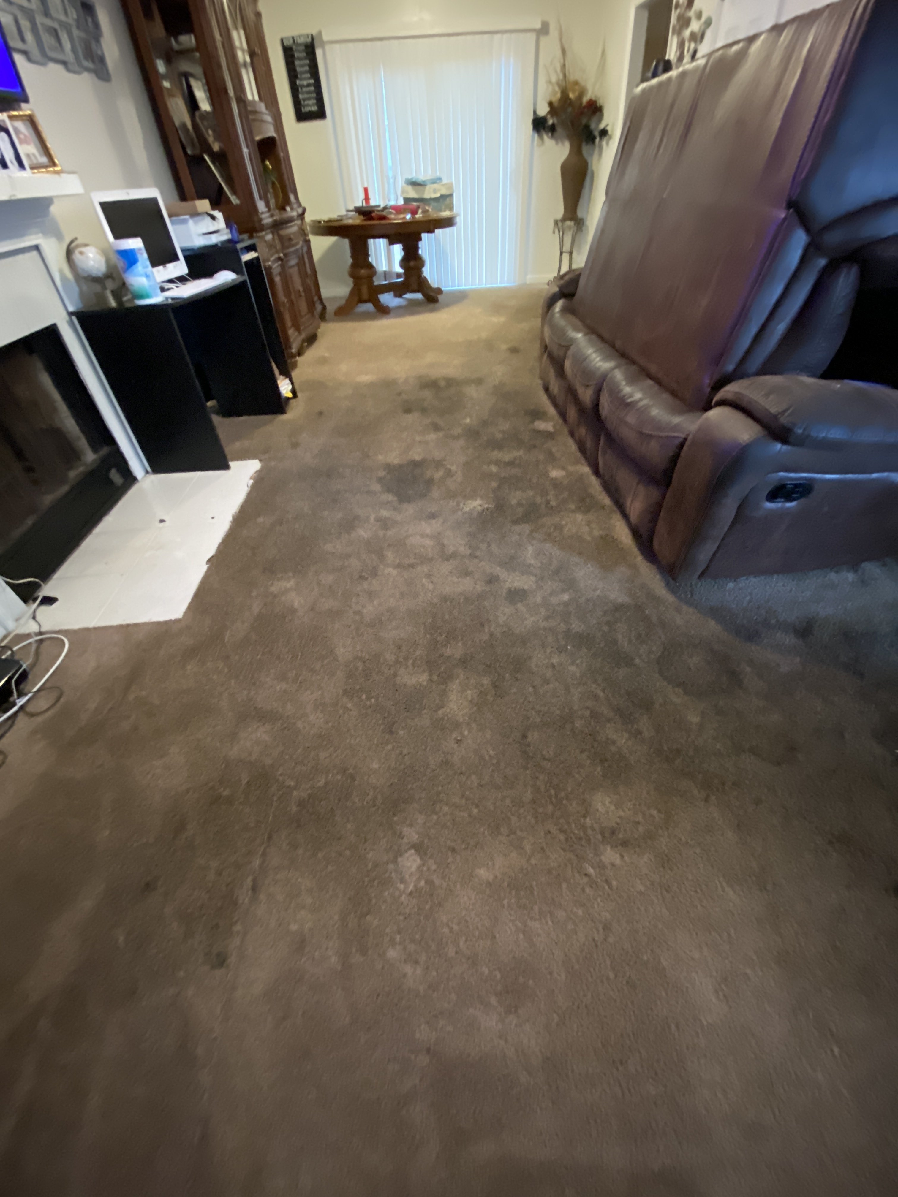

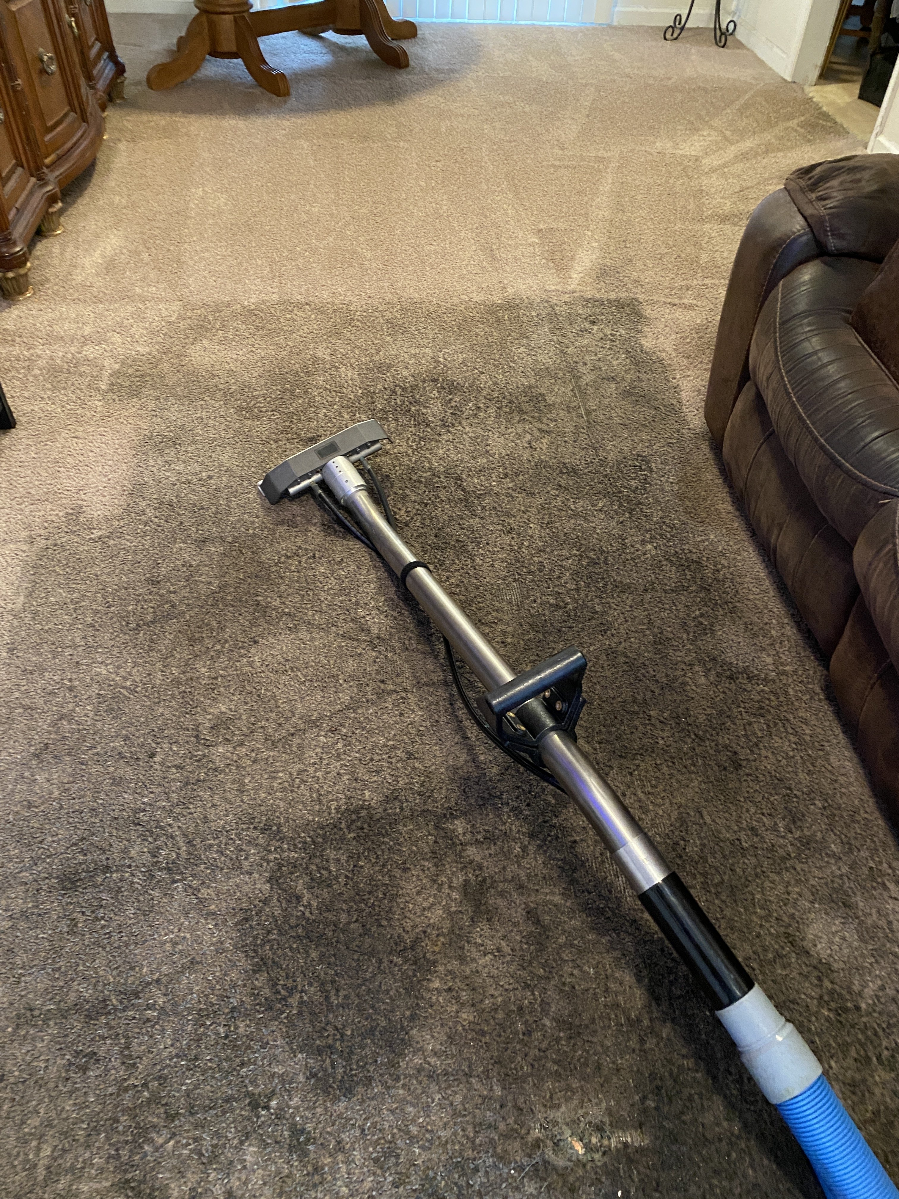

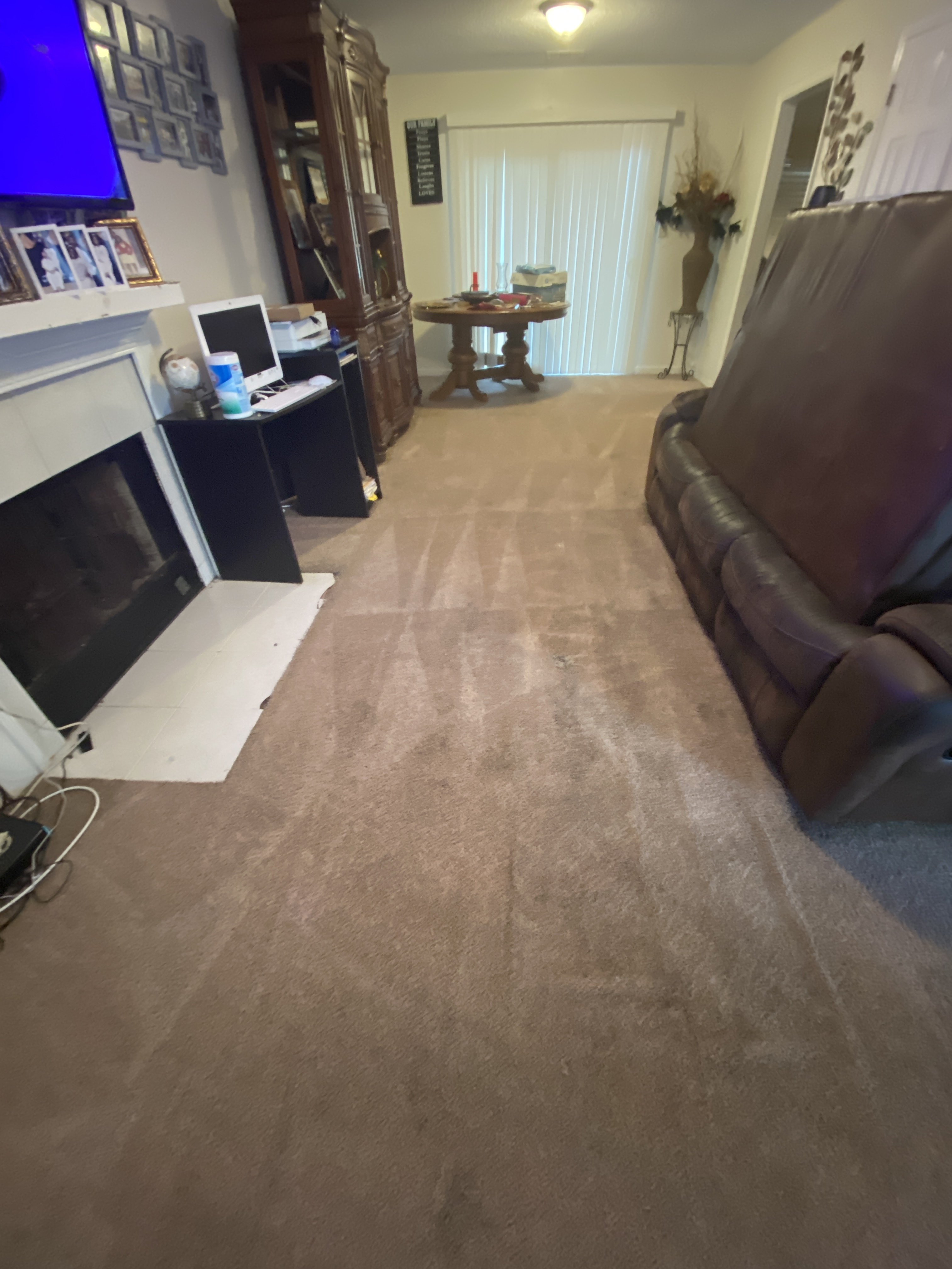

Rotary would have yanked this one apart. It needed a rotary though.

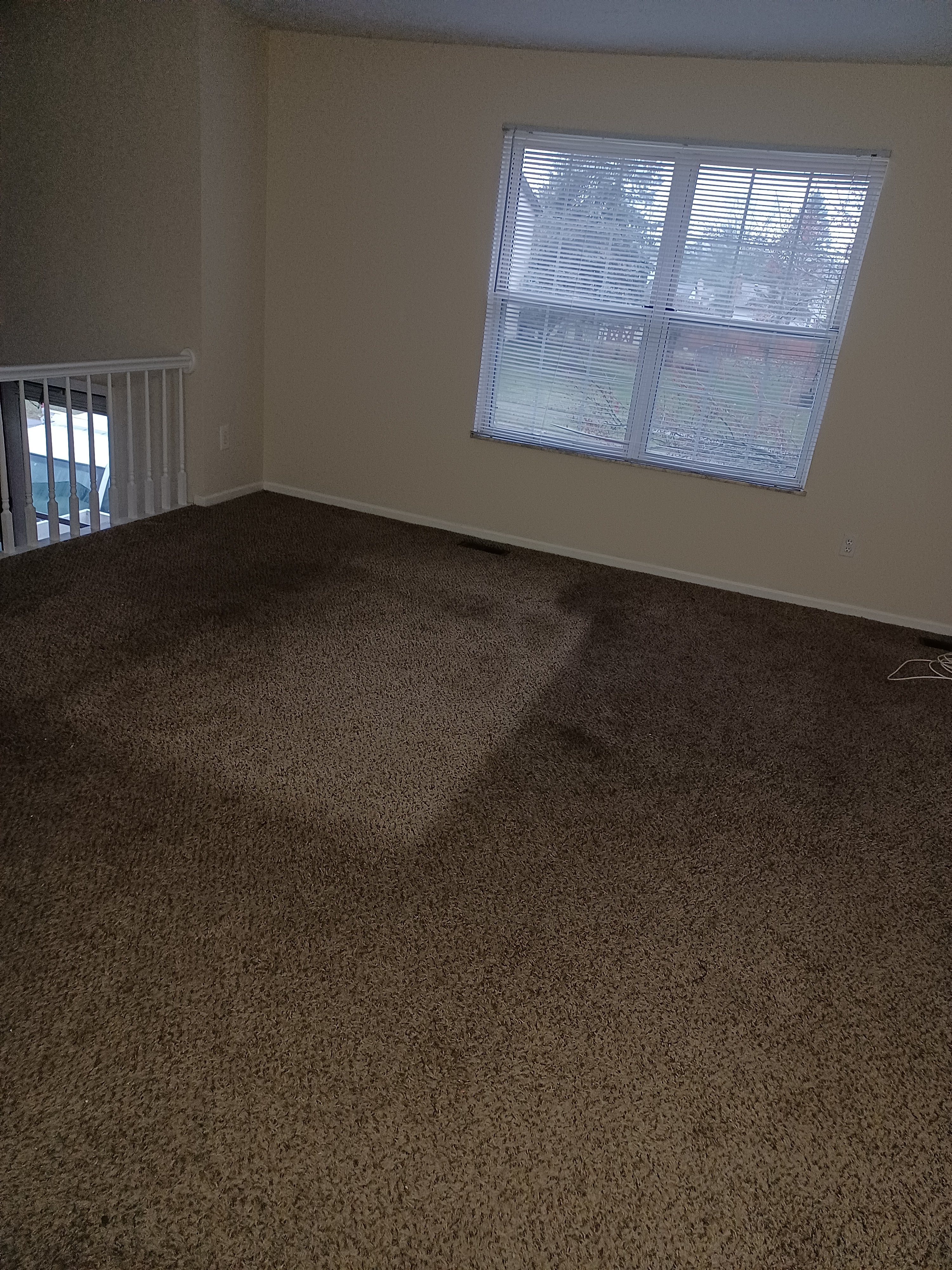

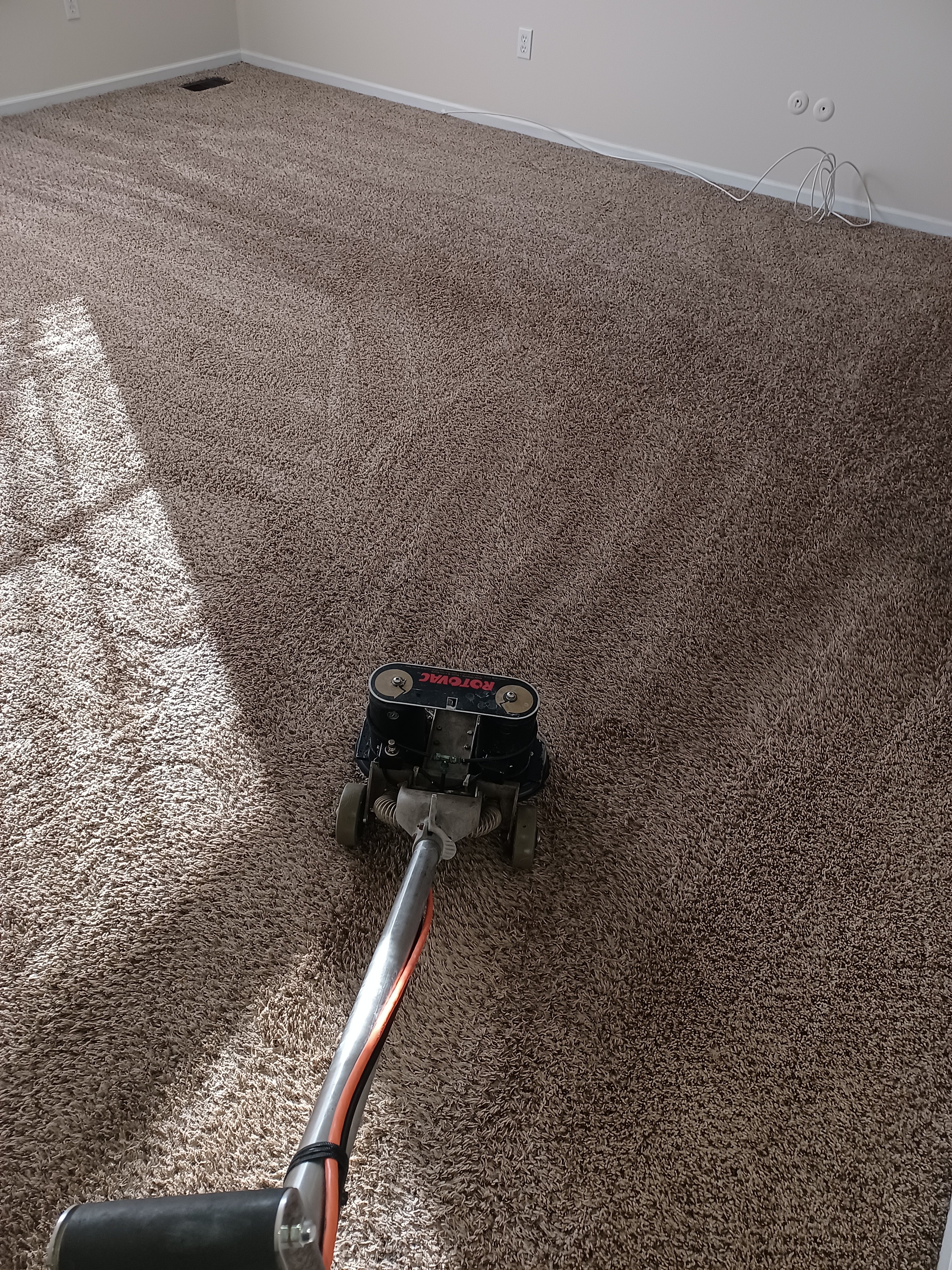

tons of debris build up in a poly frieze. Takes way longer yes.
Don't knock it. Original 2 head. got it when they first came out. long long ago. I remember bragging on it to my local distributor who poo poo ed it. What a turn around .LOLO! now their showroom has all the de jour models.
I remember the knock being the amount of H2O they went through. Well , that should be a good thing , right?
But, for me I actually would find that I went through less water. No need to hold that trigger all the time. Let the agitation do the work.

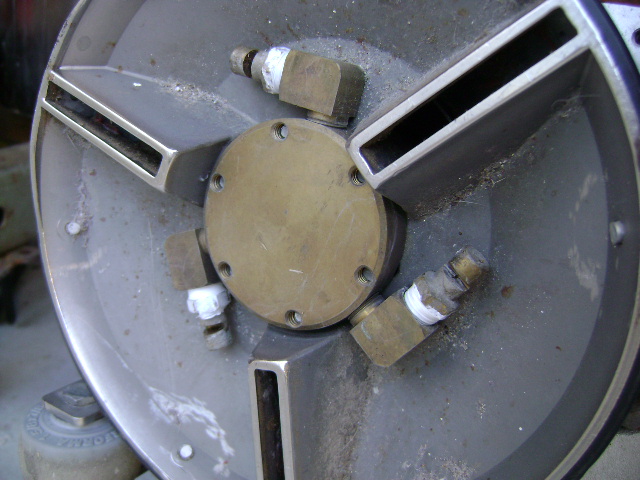

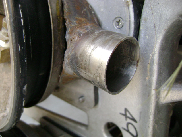

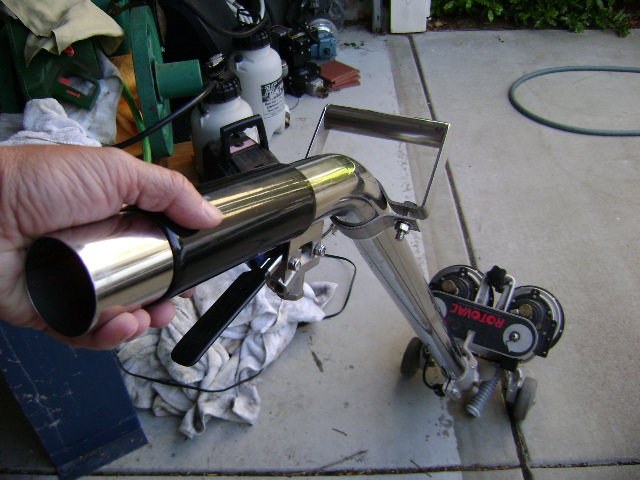

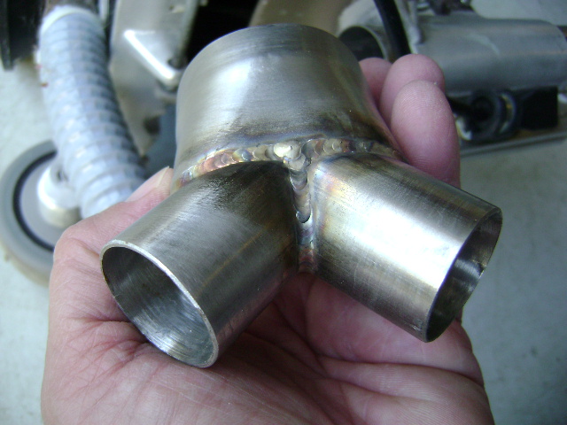

He wanted it to make it better. When he called Rotovac to offer his suggestions, they shrugged him off.
They had their chance.
No problem. I take their stock units and modify for my preferences. Same as his Zippers. The first thing I did with both the Zip & RV''s was to change the wonky way they had the vac hose''s attached to them.
I prefer to have the vac hoses at floor level as they are easier to manage.
I also made side skirts for the Zip to contain the hot spray to inside the vacuum chamber.
Makes me wonder why the big guys like having hot Steam puffing out the sides when valve is triggered.
Wasted energy.
