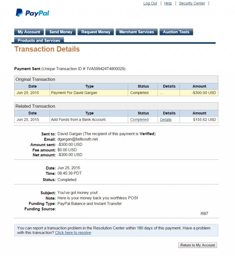

for Fred getting his panties in a wad I still stand by my statement that he glossed over the problem. I appreciated his offer and effort but when he accused me and my techs of not knowing how to prime a pump or run a machine it showed his true intensions all along of just wanting to show us up and make it seem like were didn't know what we were doing. His first words to me when he called after looking at the machine were " there is nothing wrong with your machine you just didn't know how to prime it" If his candy ass feeling get hurt thats tough. So you can continue to spew your hate and contempt along with your half truths thats fine. The smart ones know better. Like I said I had many emails and phone calls from people that really care and understand the situation and they far out number the haters here.
I don't know what to say David except here is your money back you useless POS.
