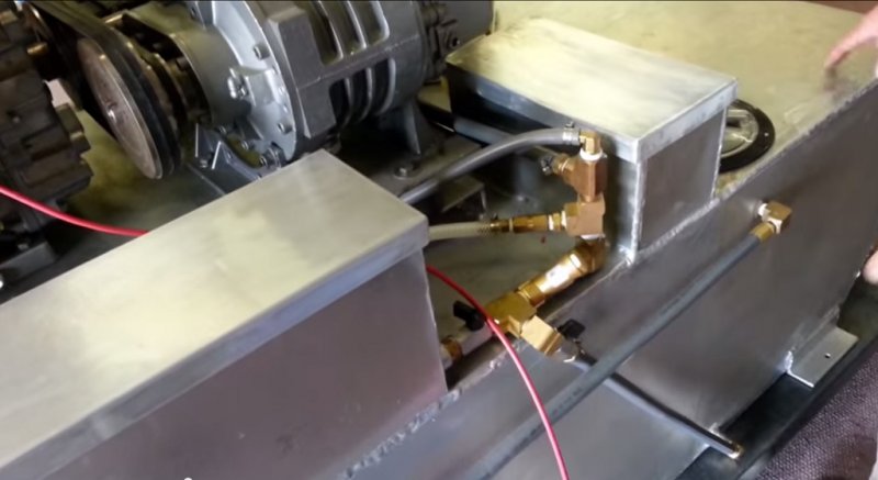

We did several more jobs but had to keep repriming . It only did 6 jobs before the prime problem started again

Fred we know how to prime it by now. We did it dozens of times over the past few weeks. But now we're at a point where we cannot prime it again and even if we got it there is an air leak somewhere and this will continue to happen so it doesn't matter if we can prime it or not.
You have two options.....locate where the air is coming from...............install a demand pump (probably need to reconfigure the water flow system for this)
My experience with the unit suggest there isn't anything wrong with it........
but there isn't a lot of places the air could be coming from
The connection to the fresh tank
the connection to the water box
the chem feed system
the hose from the "junction" to the pump inlet

Well there has to be something wrong to keep losing the prime? Its used every day and has never been run dry. There is an air leak for sure it's just a matter of finding it.

Today I had the valve to the water box open the valve to the water tank off. I kept a hose in the water box to keep it full and hooked up the wand. It would pull the water out of the water box but very slowly but never got enough pressure to move the gage. I did this for 20 minutes and all it did was keep emptying the water box

A trick to find an air leak it to pressurize the line with a garden hose. The high pressure with cause the small hole to spray a small stream. I assume only one fitting on the pump is being used to deliver water. Take the other one off and install a barbed fitting. Connect a hose with female garden hose fitting. Take off the screen in the tank and plug it. If it's not a threaded fitting a finger will do. Pressurize and see leak. I don't believe it's ever failed for me. I use a similar trick on the chemical system but it's easier. You use a garden hose on the chemical feed line and pressurize it. Any leak and it's very evident.

He says he has pressurized the supply side and found no leaks. Also the pump will not pump even when force fed from what I understand.
I assumed he was feeding the pump directly to eliminate the possibility...............

priming it is not the issue...why he has to keep priming it is the problem...if it is draining back every time then I would check and see if it needs a foot valve on the end of the line so that the water only goes one direction...IN...and can not siphon out...even if there is a small air leak...

Except he says the pump will not pump water when force-fed at this point.

not surprised...for a many times it has had to be primed it probably took out the seals again.....these pumps are only going to take so much of that....
If I were standing there I would cut the line and put in a T and then hook a fitting on it so I could connect it to a hose and as I am priming it..turn on a heavy flow and see if it will pick up...if not...then it is time to look at the pump again...because even if there is a small air leak...it will still pick up if you do this...
make this a permeant fitting so when the tank is ran dry...you can always prime the thing with it...and not try to get it going with a dry pump........

He may not of ran it dry.....but for some reason he has to keep priming it....and when you prime it all the time you are running the pump dry and it is working is ass off trying to suck that water up and get it moving and after so many times it is not going to handle it anymore....and if it will not force feed..then it needs rebuilt....
If he says that they are not running the tank dry...then from where I am sitting ...his biggest problem is keeping the water in the lines so he does not have prime it all the time...for some reason the water is siphoning backwards.....and if that is the case then he should look into installing a foot valve so the water only goes one direction....
@bob vawter ....he should know exactly what I am talking about because if I remember correct he used them in his machines......for that exact reason..
