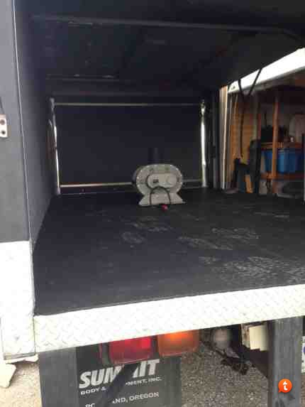

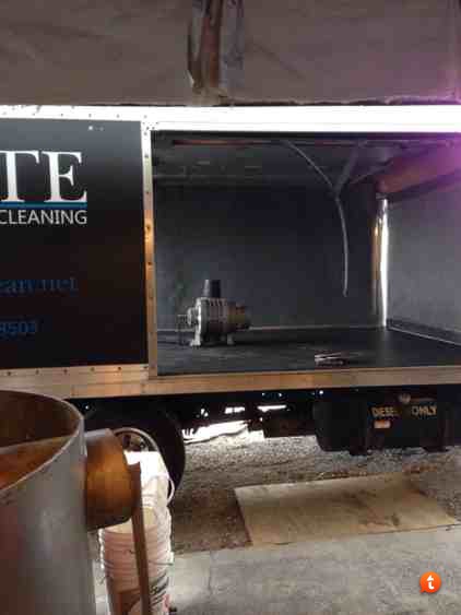

6mp blower is being installed, look at that BEAST.

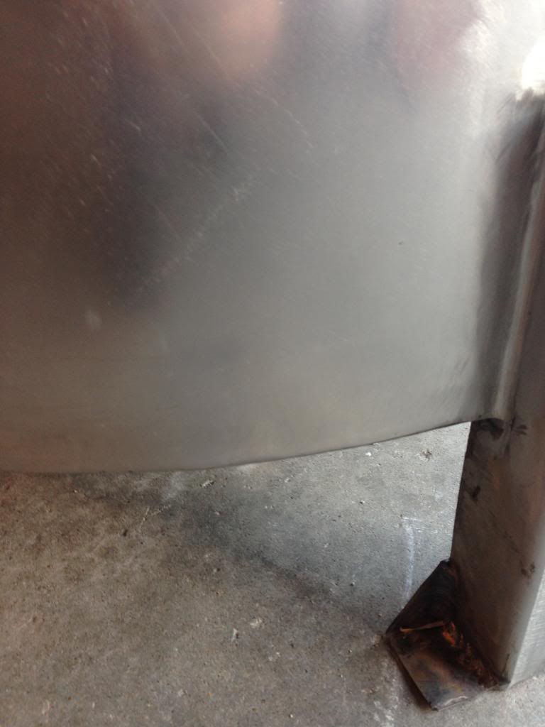

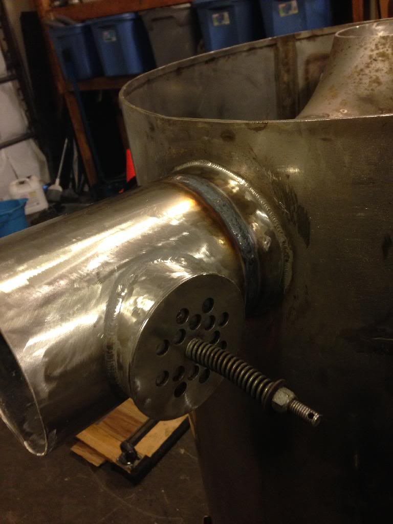

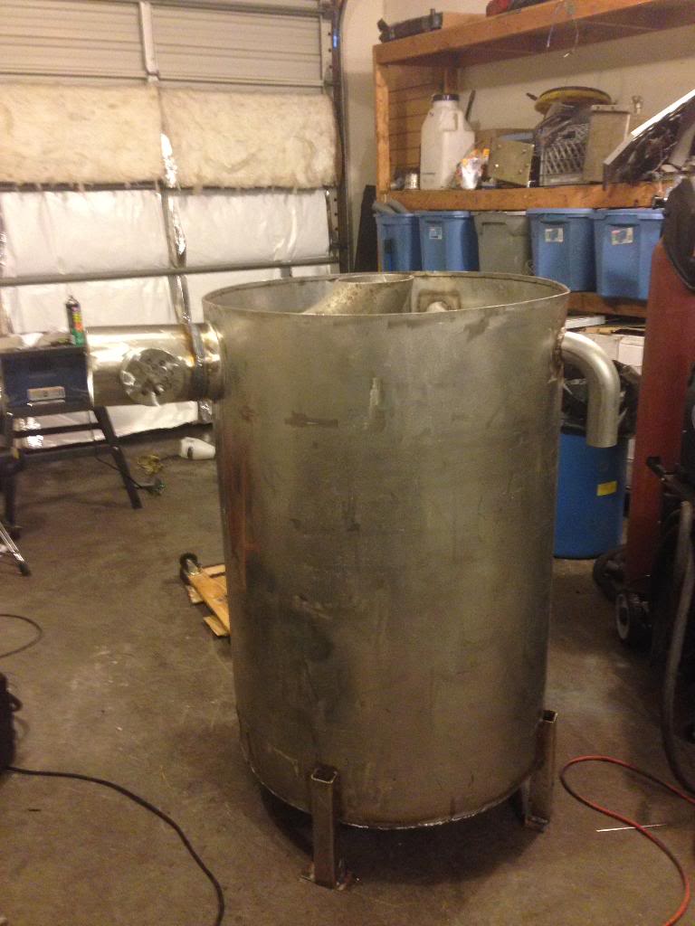

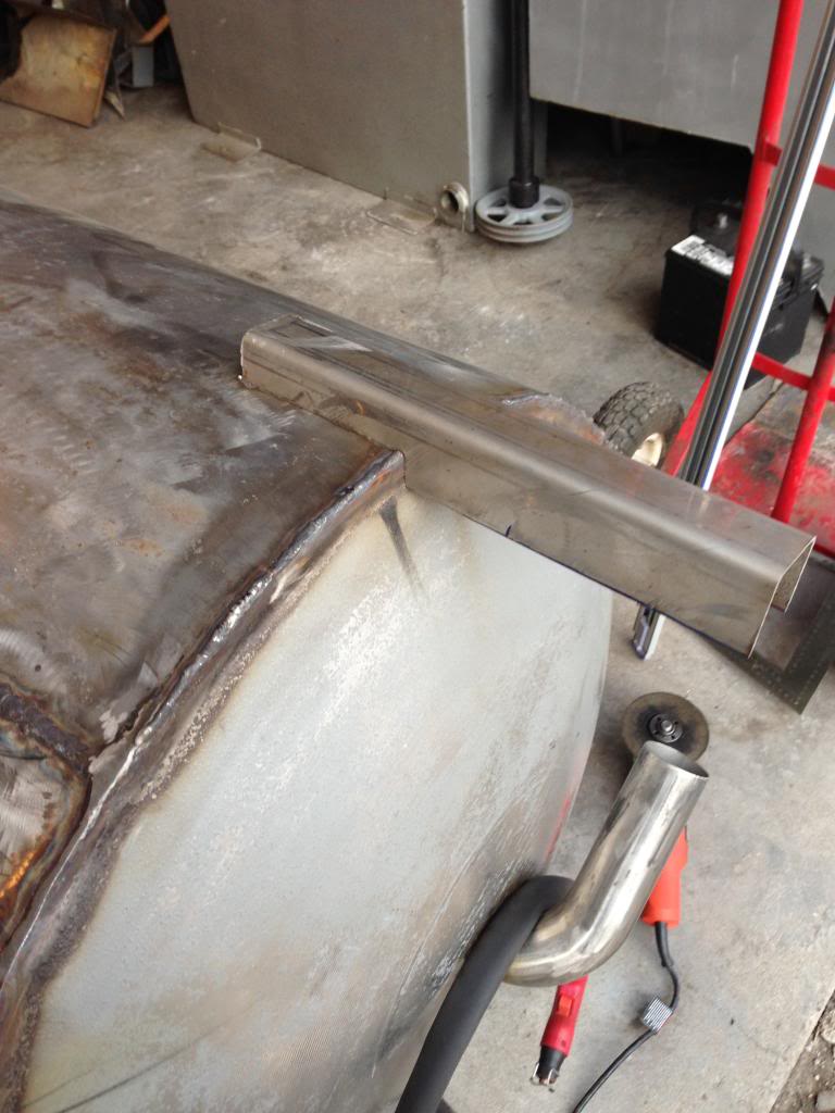

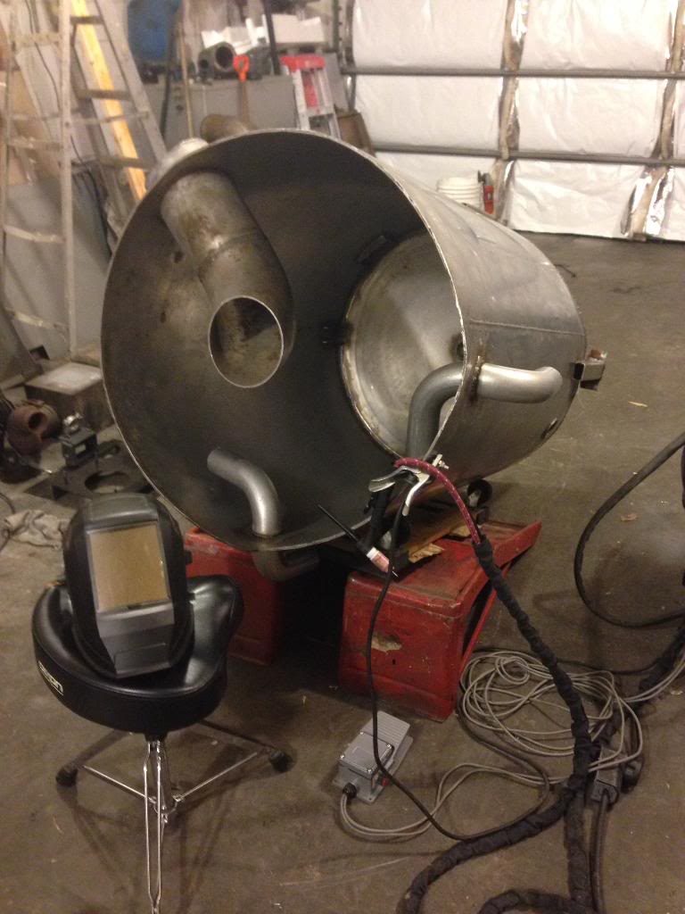

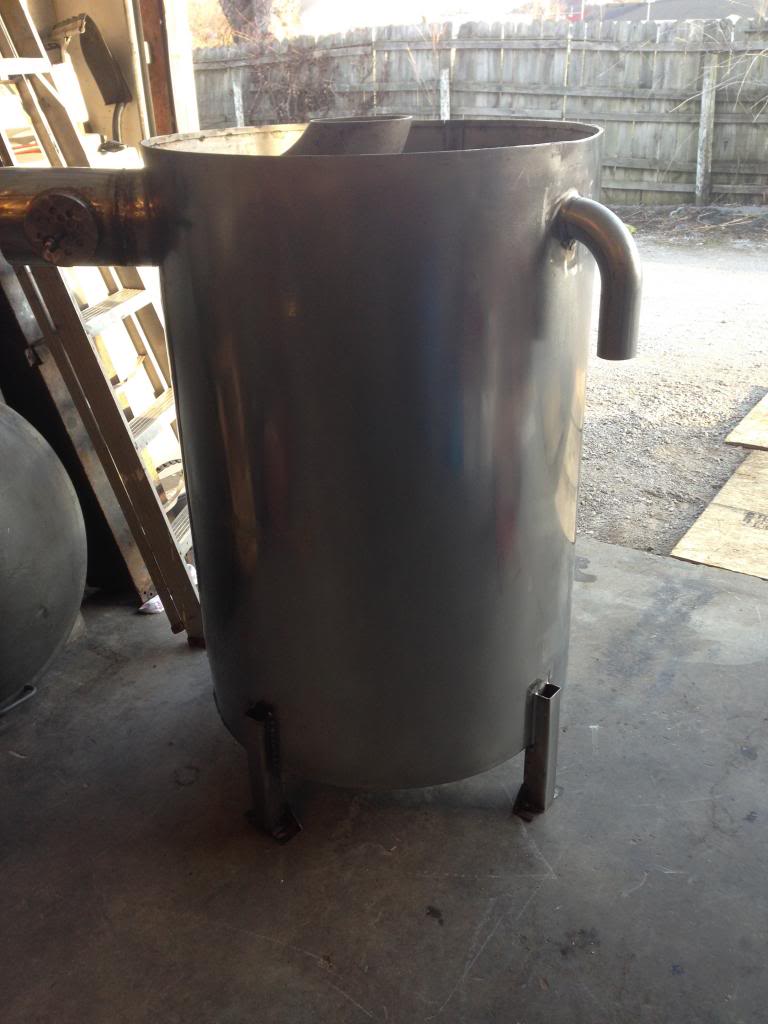

Getting the waste tank finished, You can seem my custom "Rotisserie", two ramps and an upside down dolly.
6F39AB9D-CE27-487C-894E-A585B84A3BC3_zpsam7xblag.jpg05EF8570-E5E0-4BFB-A3A6-C0D0F5E9B436_zpsuu0ij4f5.jpgCEBA207D-3276-4C85-9C57-4019B40C437B_zpsh1rvgb1l.jpg
Modifications to the tank so far:
Welded the giant 7" intake on w/Relief valve, Dual 2.5 Elbows, Cone Bottom w/2" drain, Legs.
Will be putting a cross beam near the top for any flexing.

Also, May be adding a 3rd 2.5 intake, not for triple wanding, but to slow down the velocity inside the tank, thus reducing turbulence even more, as all 3 will join together under the truck in a custom "Vanifold", so that whether we run 2 wands or 1, each intake will be used.

I'm a terrible engineer but those legs don't look strong enough. Just sayin, resume this awesome thread
gene
