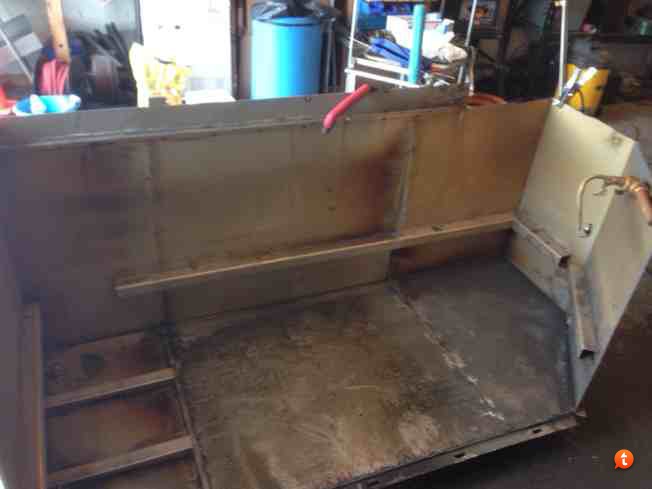

Brad, did I tell you about the 100lbs hair monster I pulled out of the tank the day after I stole her from you?
That stupid "X" baffle on the bottom of the tank caught EVERYTHING!
My Elephant bark flooring arrived today, I saved $1300 over going with line-x. Still plan on acid-priming the floor to seal it good.

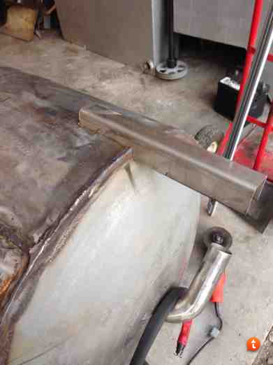

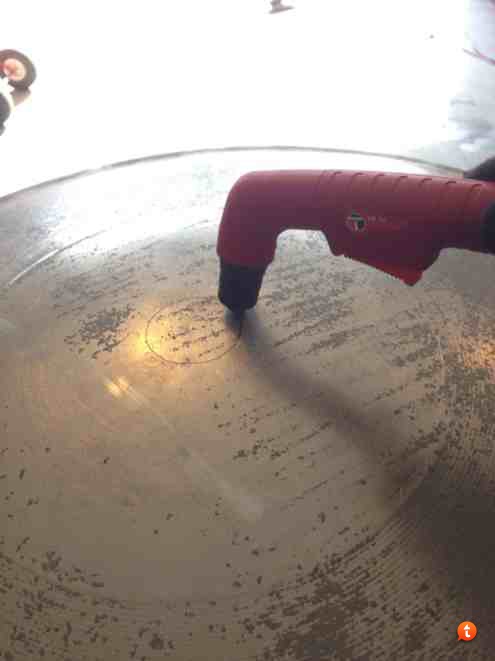

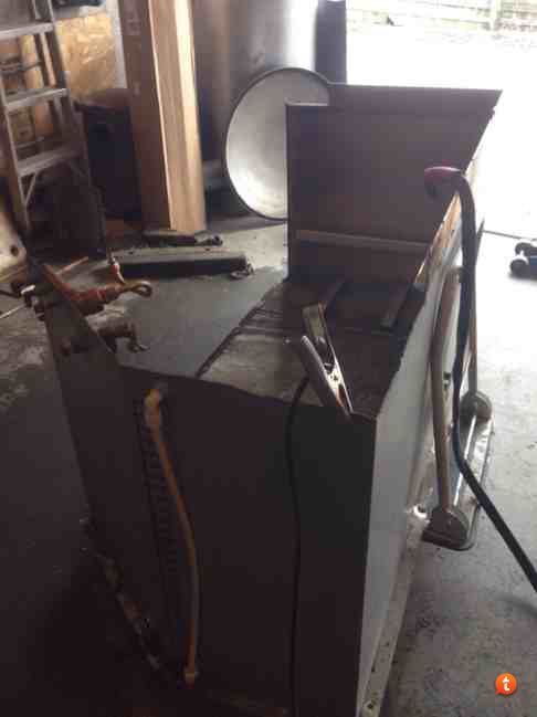

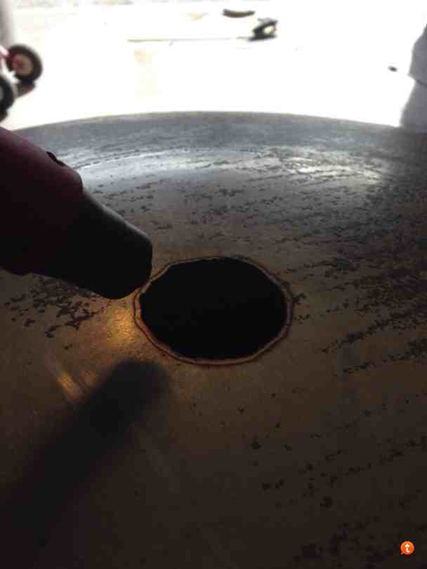

Got the replacement plasma cutter, welded the drain in

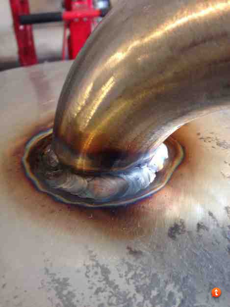

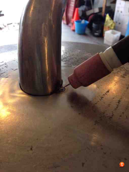

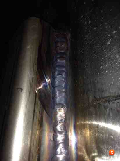

Welding the legs onto the waste tank.
My tig welds are getting slightly better looking.
J
JS41035
Stainless can be tricky. But I like to go a little hotter and faster on the thick stuff. It's funny how fast you lose it. I was making a stainless mounting bracket for the waterbox on a 405. Hadn't run the tig in a few years. Got counterproductive real fast. :)
