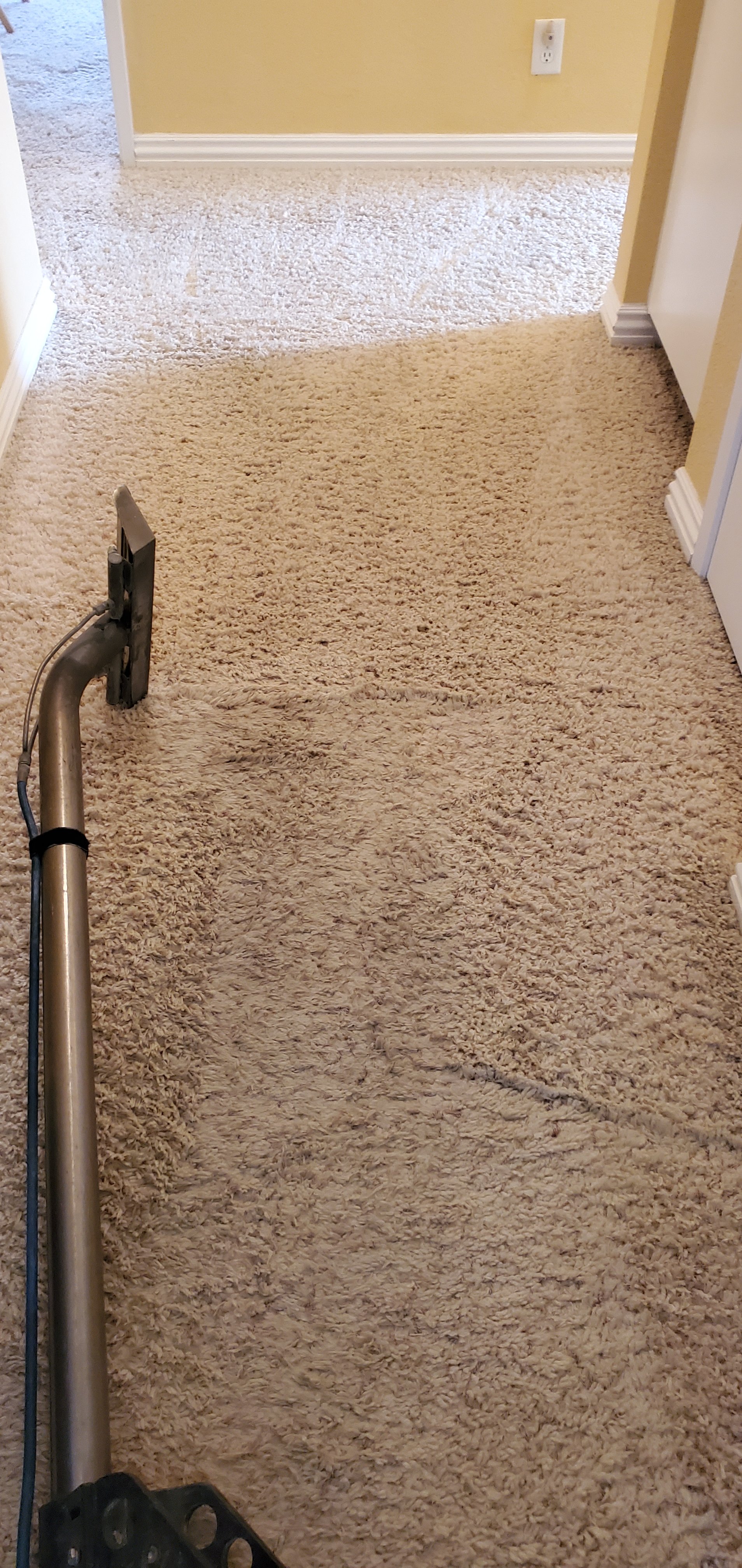

Well, 5 yrs after the original post, lol..
I lucked out and bought this used for $175 including shipping
B Reid
Nov 26, 2006
30
Brian Reid
The way it is now, it seems to have more airflow and clean better than my Antique Greenhorn wand.

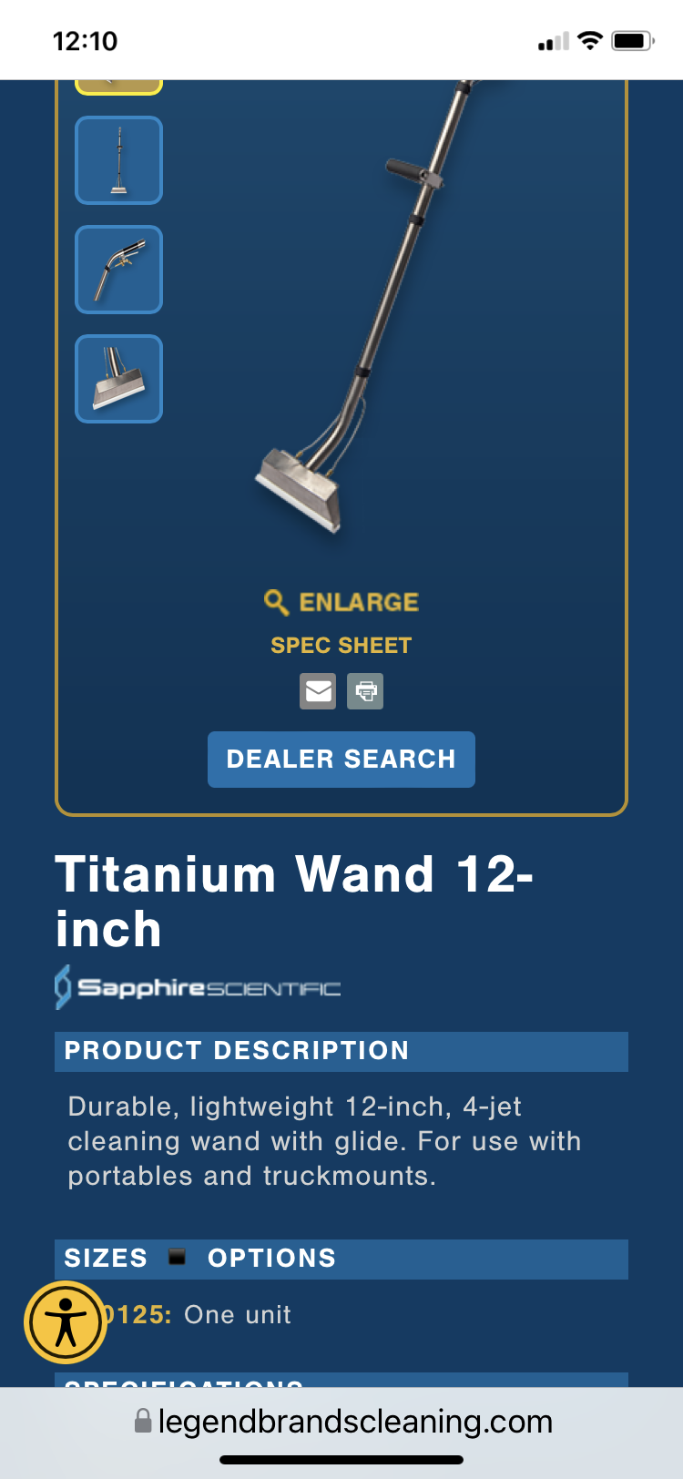

The SS12 would be the better choice but its $$..
11,570
I actually love the 14 inch sapphire it's so light.
