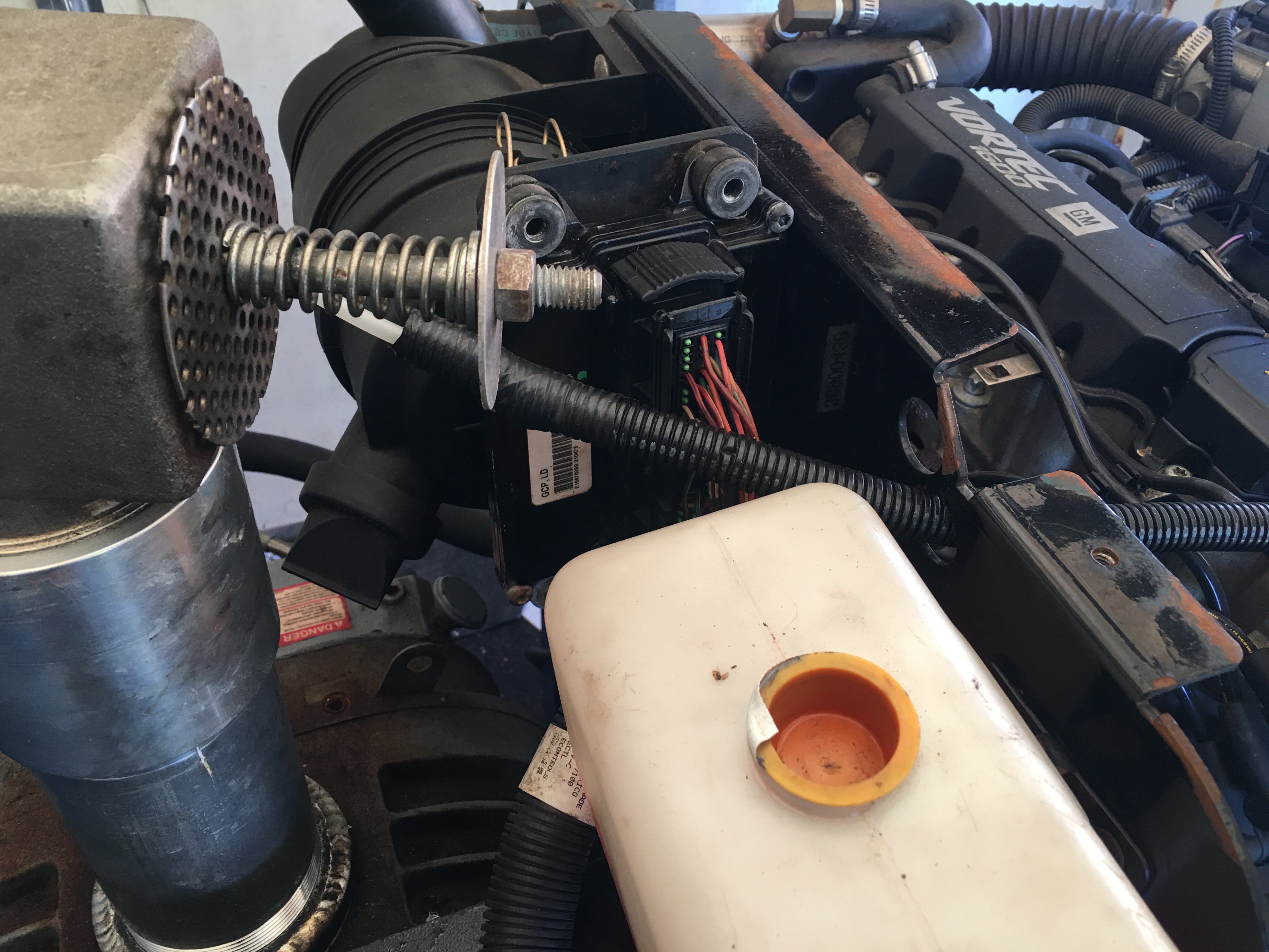

Brother i completely forgot to get a pic this morning, but we mounted it under the top shroud towards the front it fits perfect in there and the engine fan draws air across it, ill try to go into the shop tommorow and get a pic for you. Unistalled and pjlled the boxes on 2 vortex units today been going since 4am and just finished fml its been a long day.

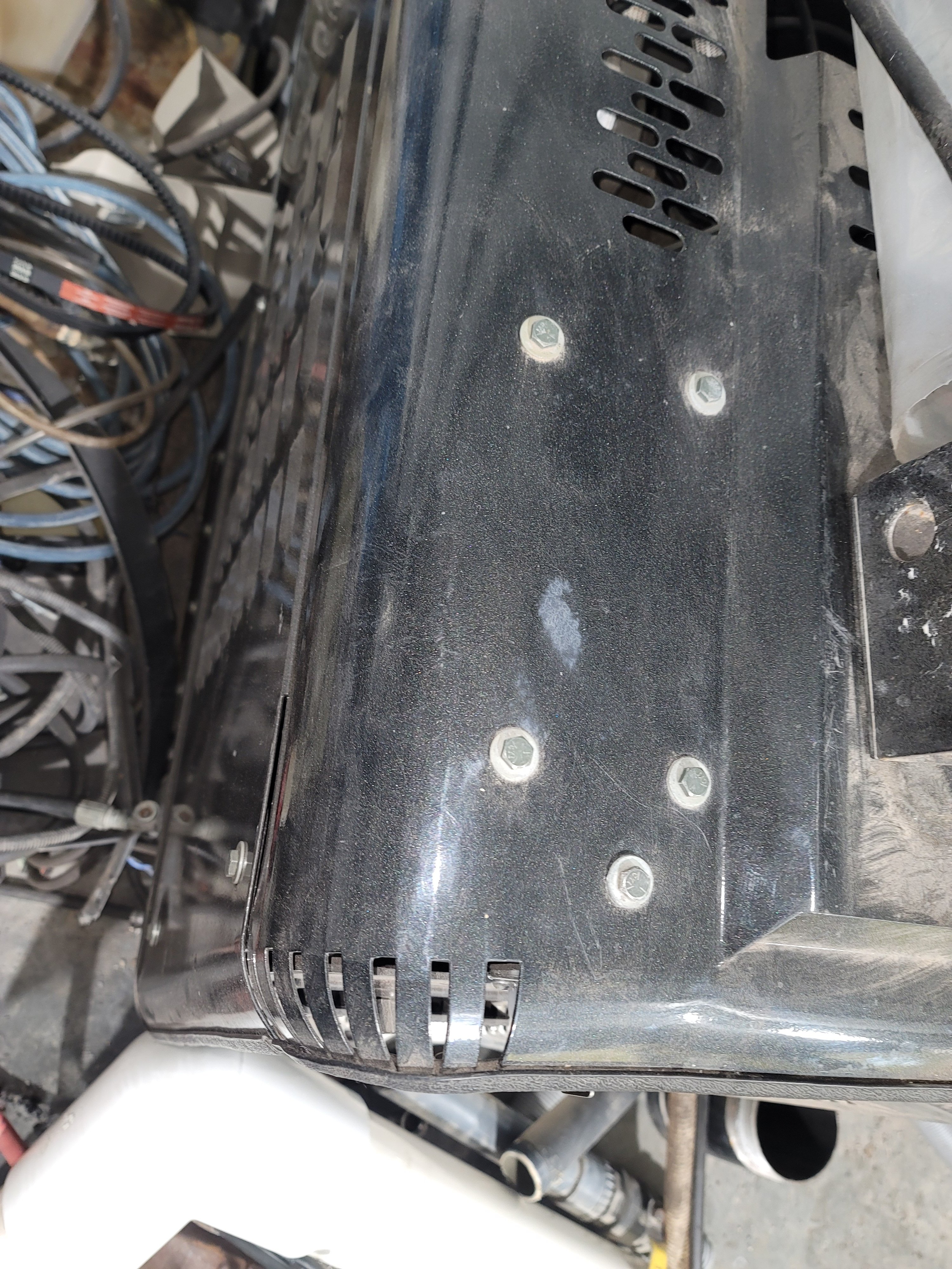

Is this the area you’re referring to? I can’t picture any area under the top shroud

Its mounted under the front left side of the top shroud. Sorry for taking so long to get this posted
Perfect. Thanks for the info
It looks like you didn't use the mounting place from the 5 bolts I see. I was trying to fit the mounting plate underneath it, which made it doable, but awkward
