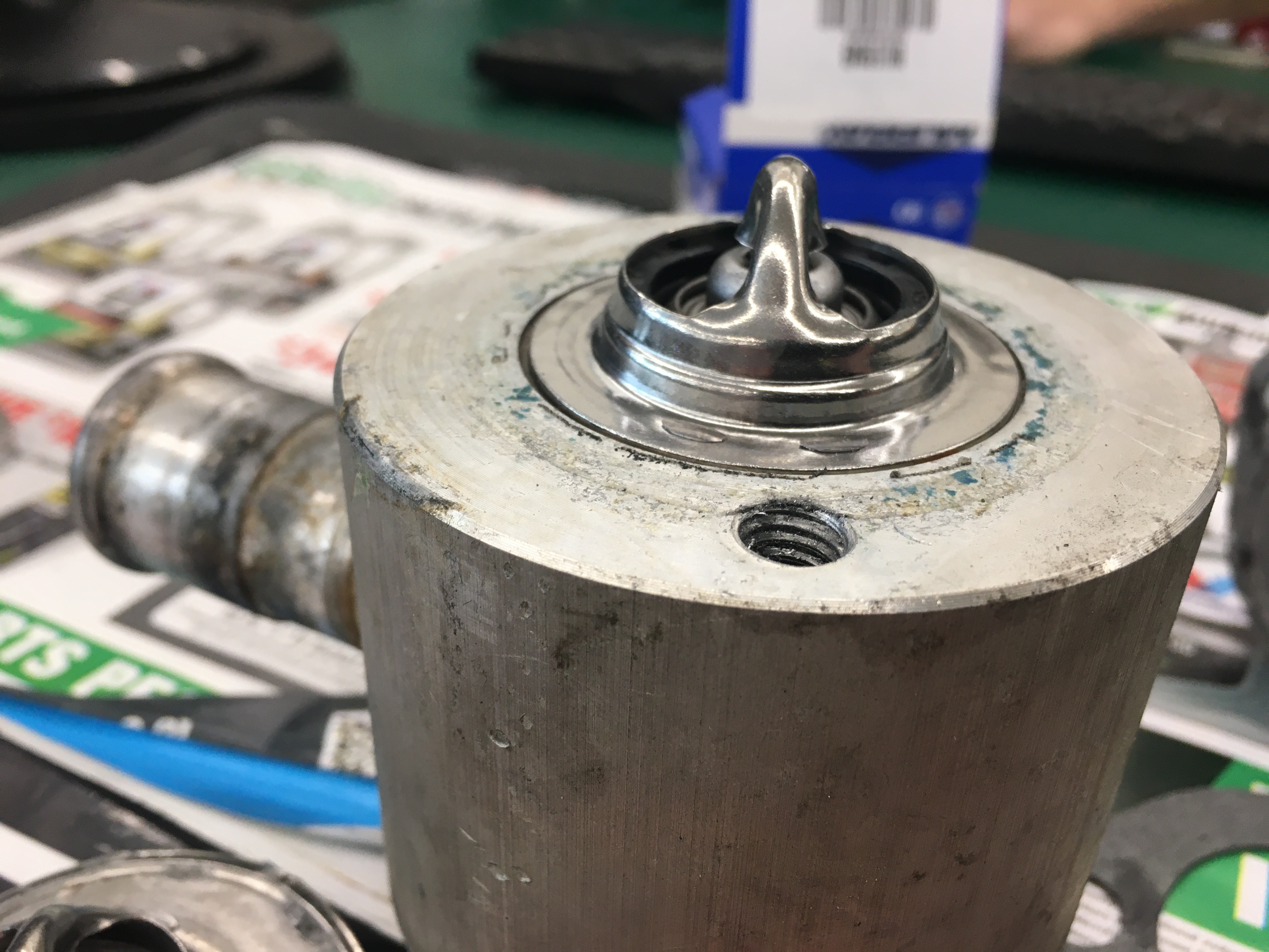

As for the tm, the water pump needs tlc, and the 185f thermal relief valve needs replaced. 🤞. Once I get it completed, we’ll see what other issues it might have
17CE22B9-854E-4ABB-9ECE-28040E23E8EC.jpeg 2EFED58C-14C5-482E-A811-4DAA6ACBD6C8.jpeg 24D2C782-DA0F-424D-8B84-DA5A76476091.jpeg 7A5382E7-9E74-4E44-BEBC-232DC07DCCCC.jpeg 0B2116DF-0BE8-49D1-9293-D416B87B3896.jpeg
14,202
The thermostat is holding great and after about 2hrs of testing, it's ready to go to work. It's been exactly one year since this project started with me working off and on with it.
