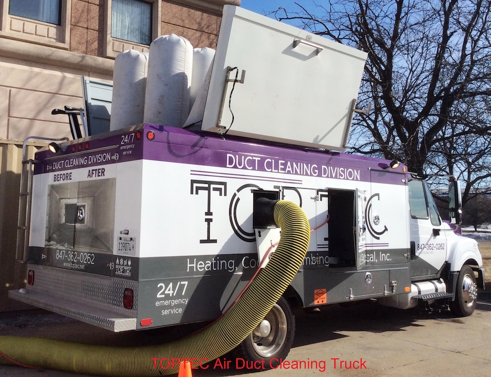

I'm pretty sure that in order to really clean air ducts, you'll need one of these...
Overkill for residential. I dropped my crappy rotobrush setup and I subcontract a duct cleaning company that rolls in their system to be attached to the air handler in the house, which creates a negative air suction. Then they use the air whip hose to be fed through all the ducts. I've seen it work close up and it is very beneficial if you can't afford the truck above. The web attachment below isn't the exact model. It's just a good example of the machine I'm talking about.
But...too much is better than not enough. That's what I was thinking on my latest truckmount purchase. So go BIG! Screw that little machine I just suggested
