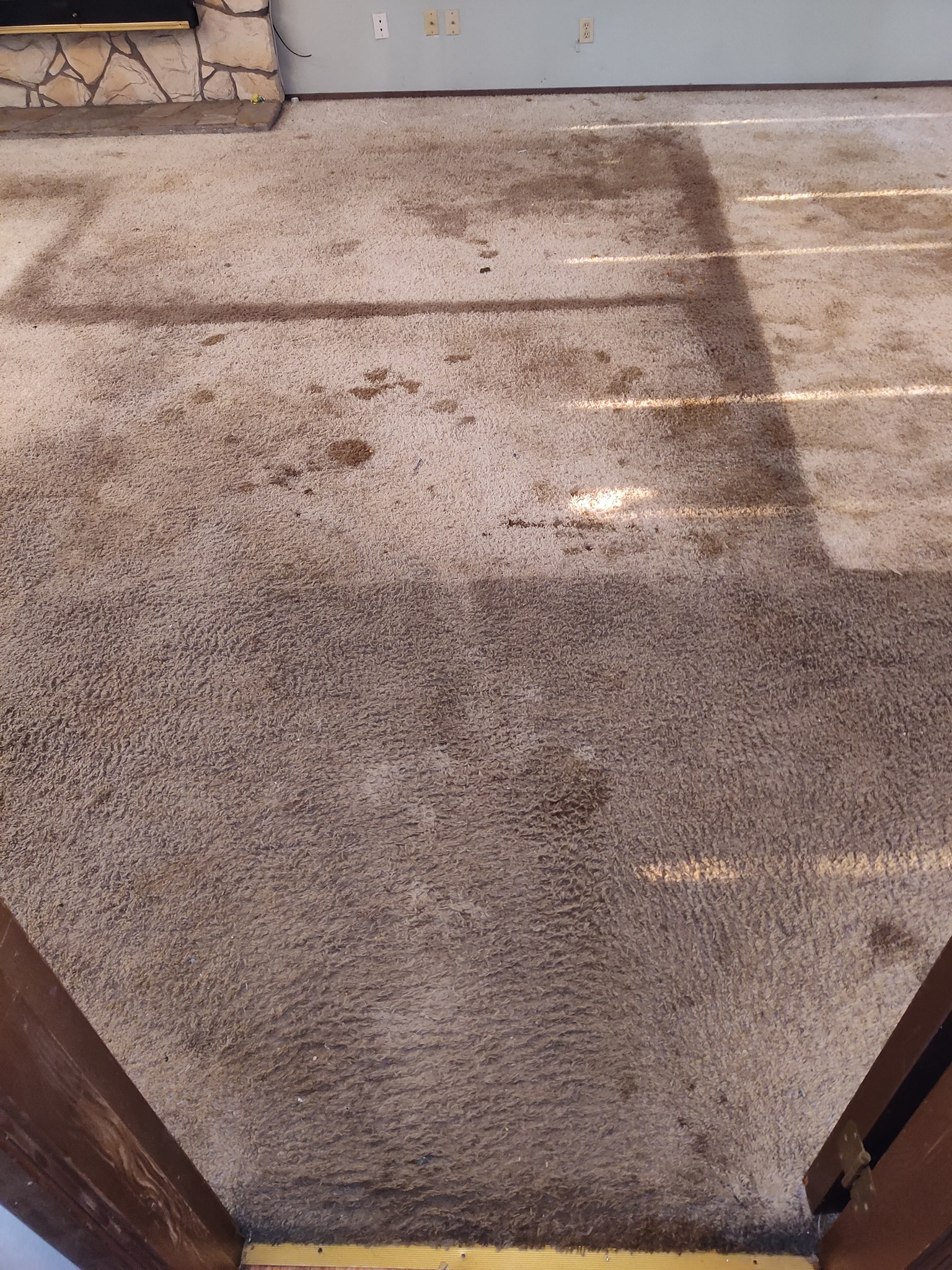

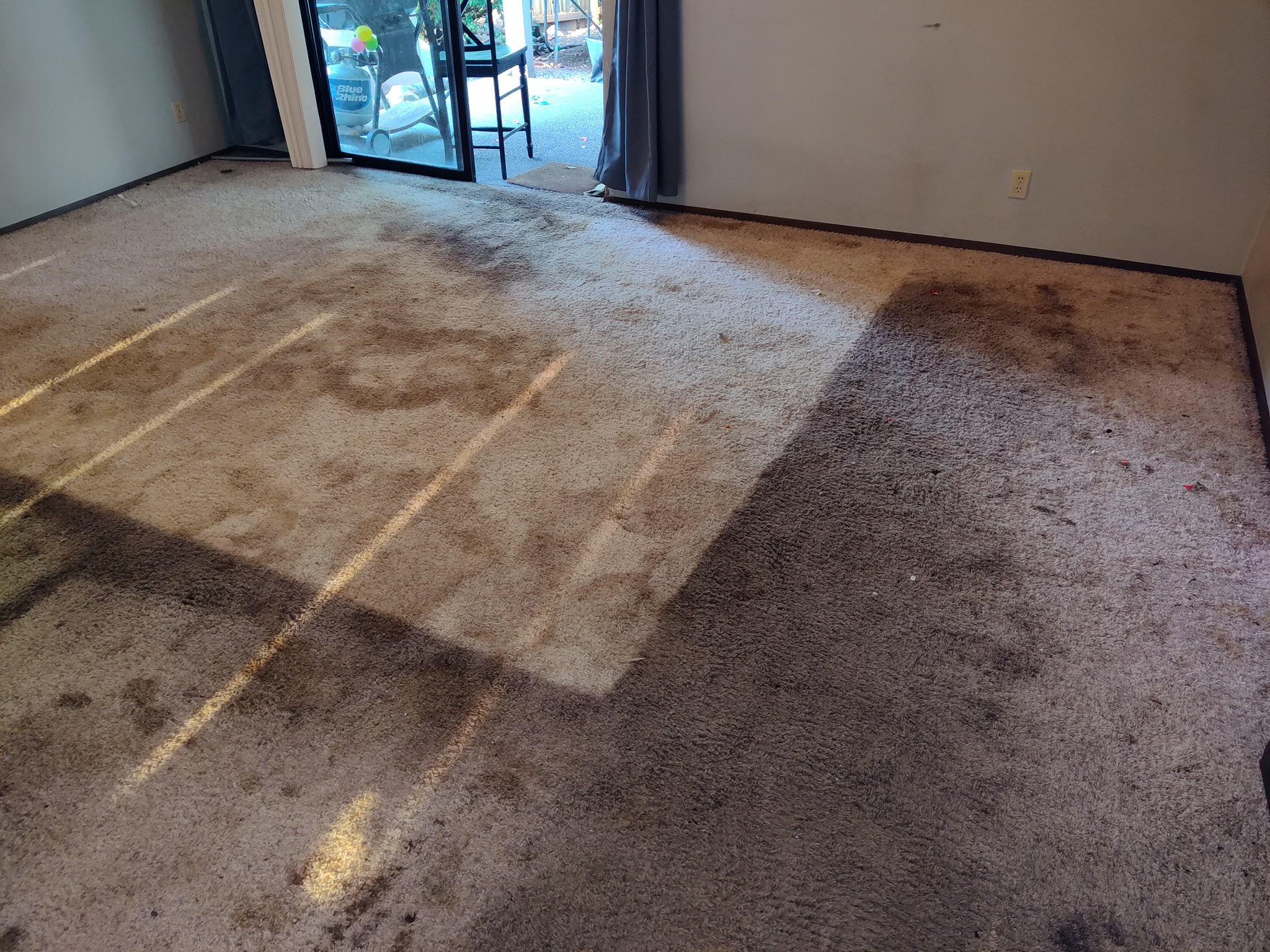

That’s extreme but not too far beyond what I deal with on a semi-regular basis.
1)Prevacuum thoroughly. (My vacuum would be cleaned and sanitized after.)
2) I would cover all the soiling possibilities with a prespray of Bio-8, D-Gas and PSor.
3) Rotovac my way into the room with a brush head.
4) Edge the room with a stand up filtration tool.
5) Wand my way out
Side note:
As I’m vacuuming, if I note any stains that I think may need dye stain remover and steam, I’ll do those before prespraying the carpet.
Jobs like this OFTEN require follow up cleaning and ALWAYS REQUIRE clarification of what can be expected.
Average cleaners will fail at these jobs because they won’t purchase the necessary equipment, don’t have the proper chems and are hesitant to price high enough to cover all the time necessary.
I can almost always clean these type jobs well enough to allow another rental season of use and save the home owner about half of the replacement costs.
I seldom encounter these jobs on owner-occupied houses

just had one like this on Friday. Just imagine 1900 sf of shag that looked like this. I very rarely run into anything that bad but it was from a referral generator realtor.
1. rinse with wand. You would be surprised at how much dirt a good rinse will remove. remove as much soil as possible and your prespray will be that much more effective at removing the rest of the soil. Make sense?
2. apply a powerful prespray.
3. CRB slowly in both directions
4. rinse
repeat steps 2 3 4
Carpet looked pretty close to new.
