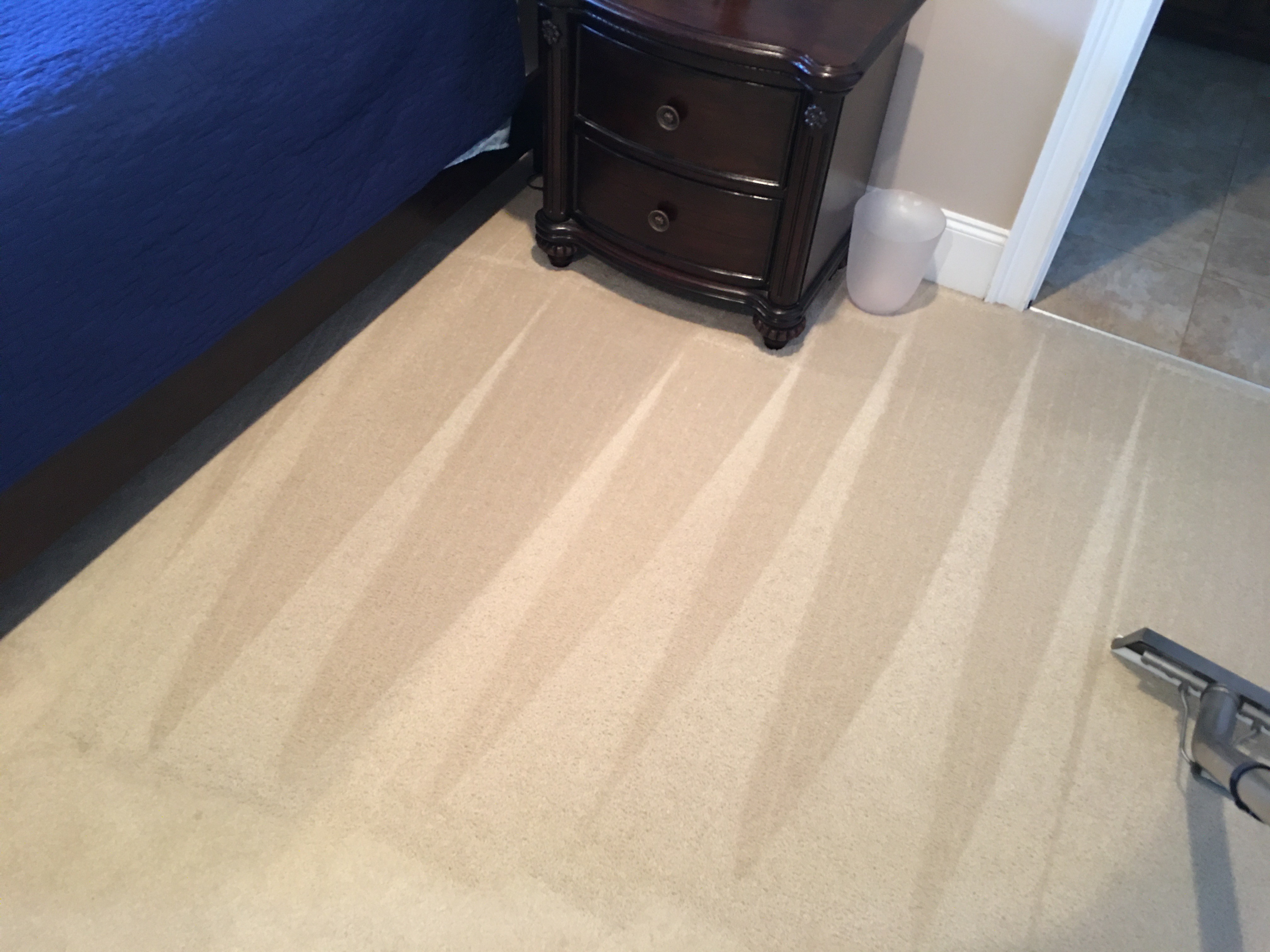

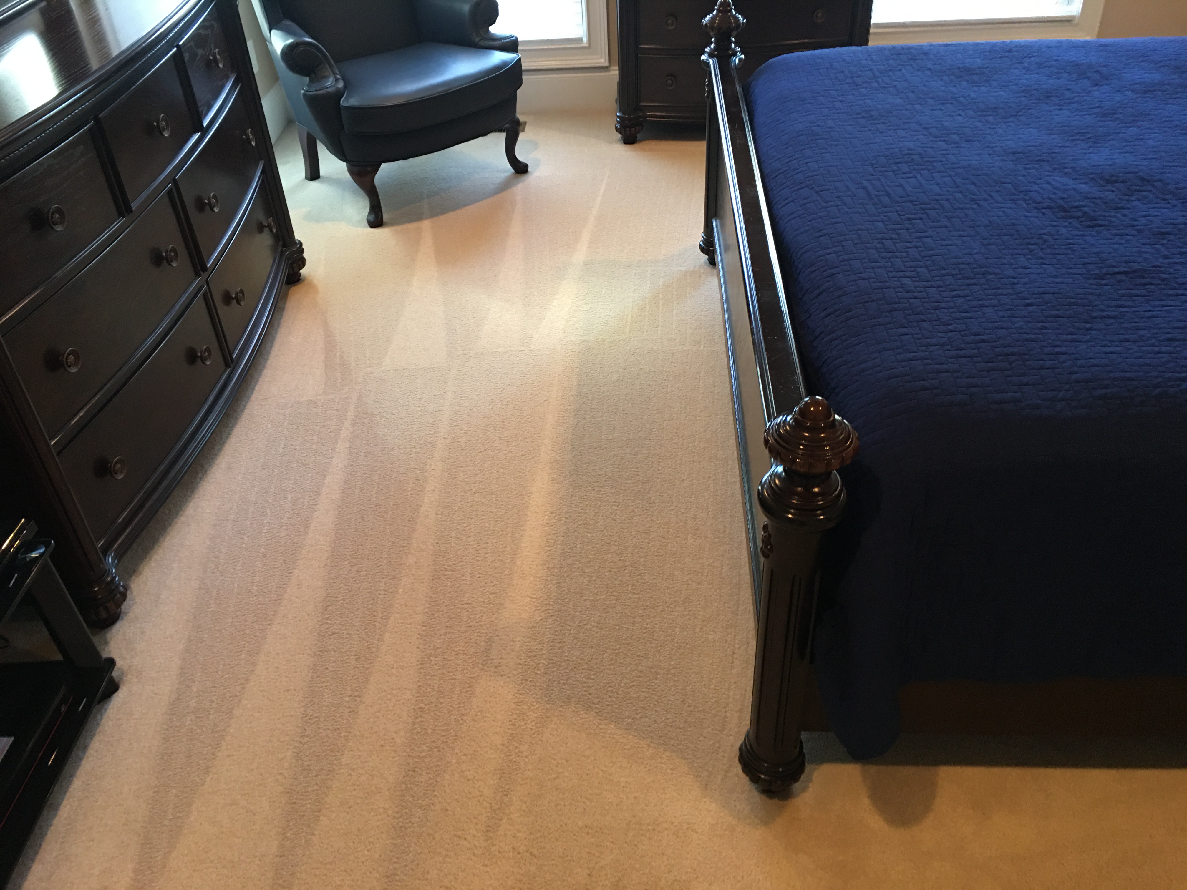

I did my first job since selling my truckmount and going back to VLM only last week. It was for a realtor's personal condo in downtown Salt Lake. Two sides of the building were on busy roads with no shoulder, third side was the parking garage and there was no access on the 4th side. No idea how I would have done the job with a truckmount. The realtor asked me how I was going to clean when he first reached and was skeptical when I told him low moisture. Each room wasn't very dirty except a few small spots and it cleaned up great. He was super happy and had me do one of his rentals this week too.
The main thing I don't like about VLM is that if everything doesn't go perfect the customers are quick to judge the method, even if it's something that wouldn't have mattered like worn out poly.
