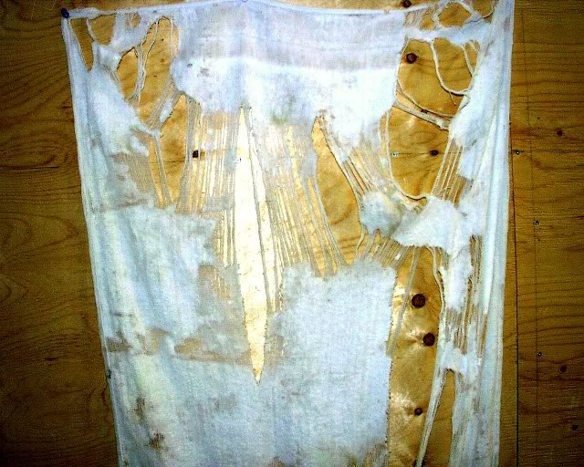

Preventing disintegration of fabric. Here is a shot of a cotton towel loaded with Peroxide that I used to warn my Techs about the dangers of using ANY Peroxide on ANY fabrics.

None were made worse by our actions - many years ago I figured it out and began to have a lot more respect for what COULD go wrong with fabrics. Too many cleaners either fearlessly clean everything or are too terrified to clean anything.
I do believe that there is a happy place between those to extremes.
A healthy fear of fabric is not a bad thing.
