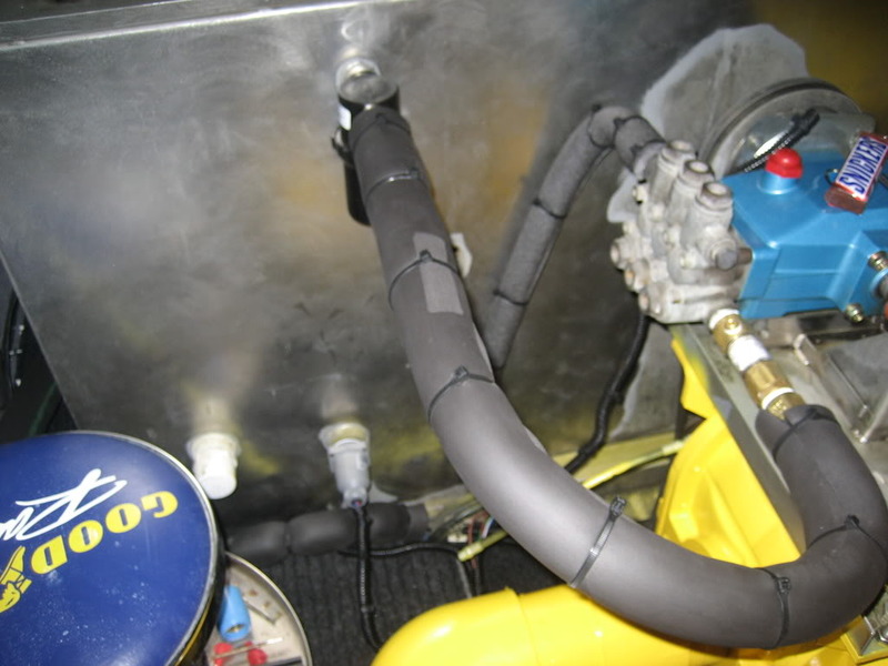

As mikes machine as well as rims machine are newer aerotechs that have the pump Mounted to the floor in the box well below the fluid or water level in the fresh tank.
You will notice the cat pump right in front of blower on floor of truck.
Older trucks like mine have the pump mounted above the blower always above the water line by at least a foot or so and the pump has to pull one foot up and at least two feet across to get the water.

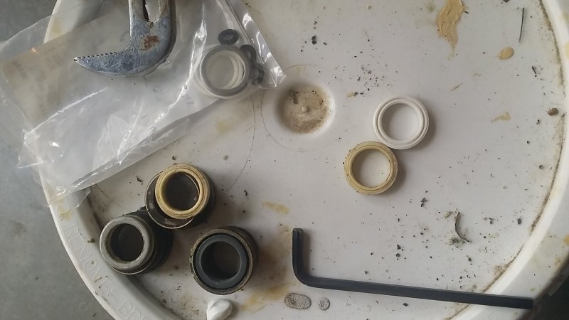

I will pull one of my cat pumps apart to see if I had that type of wear going on.
That didn't look so much like wear as it did something aggressively attacking it. ???

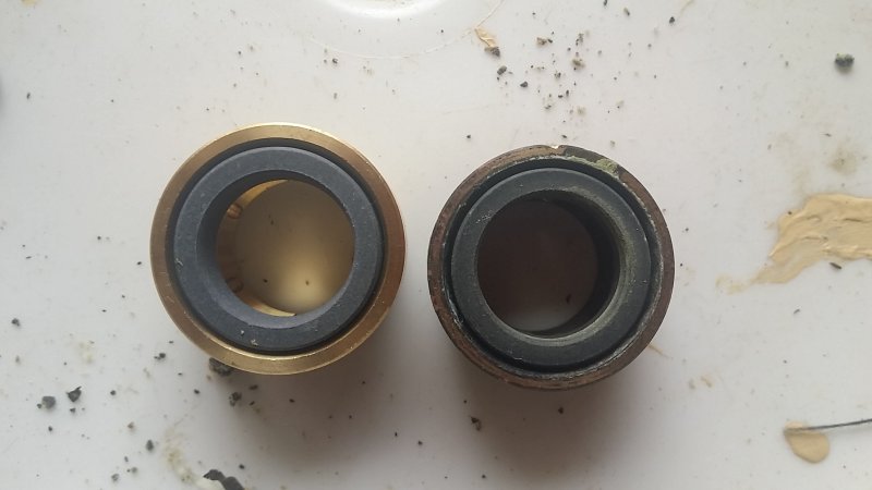

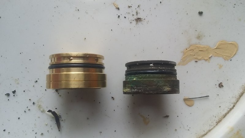

That is what I mean as the brass plug mike has posted a pic of does not move, it is stationary. The plunger moves in and out of the middle of it creating pressure in the head. So what ever is "wearing or eating" it has to be in the water.
dgardner
Apr 7, 2008
5,109
Phoenix, AZ
Dan Gardner
I agree. severe cavitation can/will erode the pump materials but not (in my experience) discolor them like that. Certainly looks like either chemical attack or electrolysis to me.
