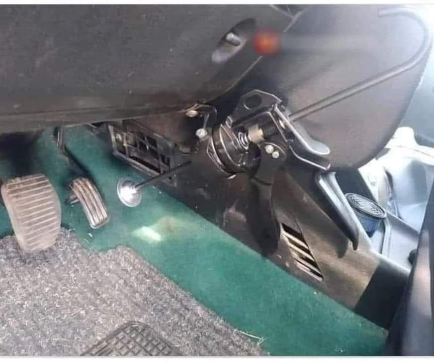

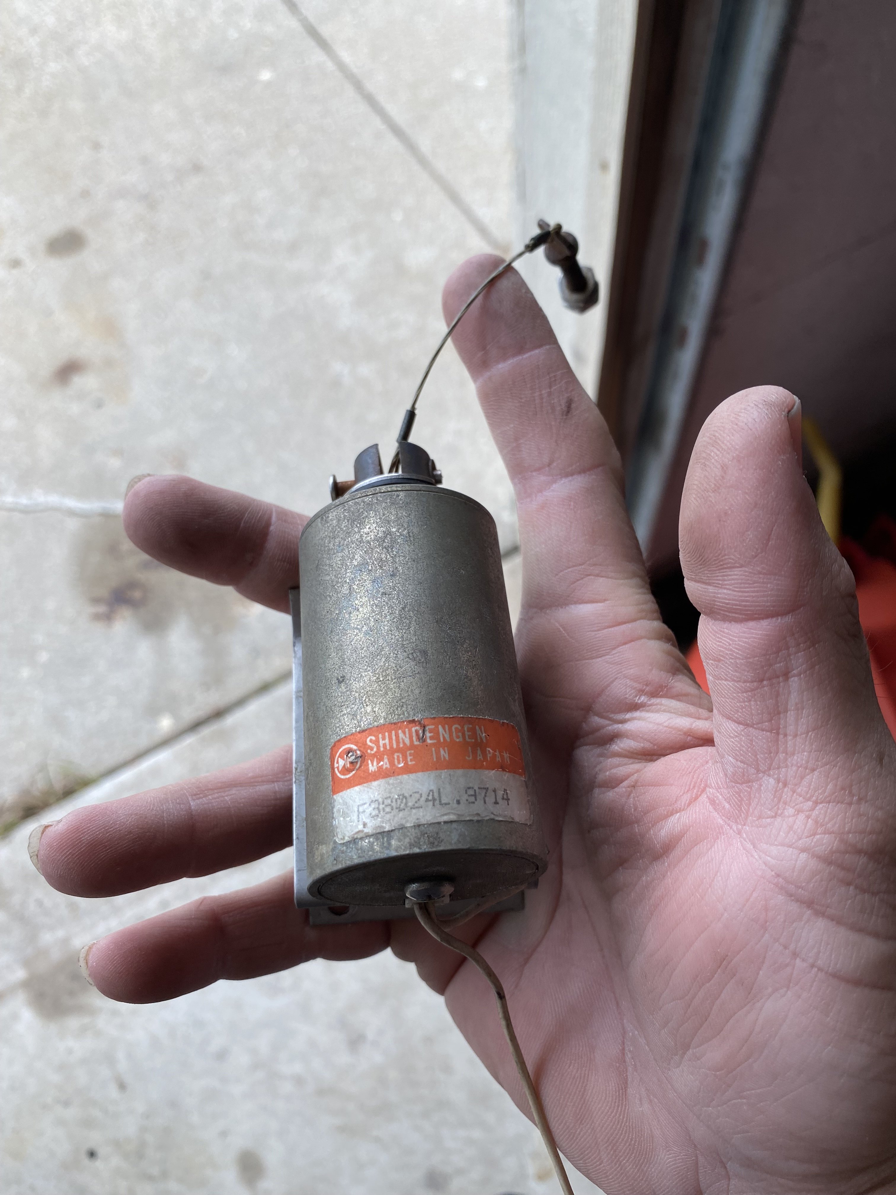

The way the PTO Steam Genie I got had this what I think is a 12v diesel cutoff switch.. It basically energizes sending 12v to the solenoid when you turn the unit on and the pulls the throttle pedal with the cable to the desired RPM..
@Rob Grady Made a cool gadget to work with electronic throttle (drive by wire).. A magnetic mount adjustable to desired RPM..
@Able 2.0 Sent me this as a joke, but it's not stupid if it works..

The way the PTO Steam Genie I got had this what I think is a 12v diesel cutoff switch.. It basically energizes sending 12v to the solenoid when you turn the unit on and the pulls the throttle pedal with the cable to the desired RPM.. View attachment 112601

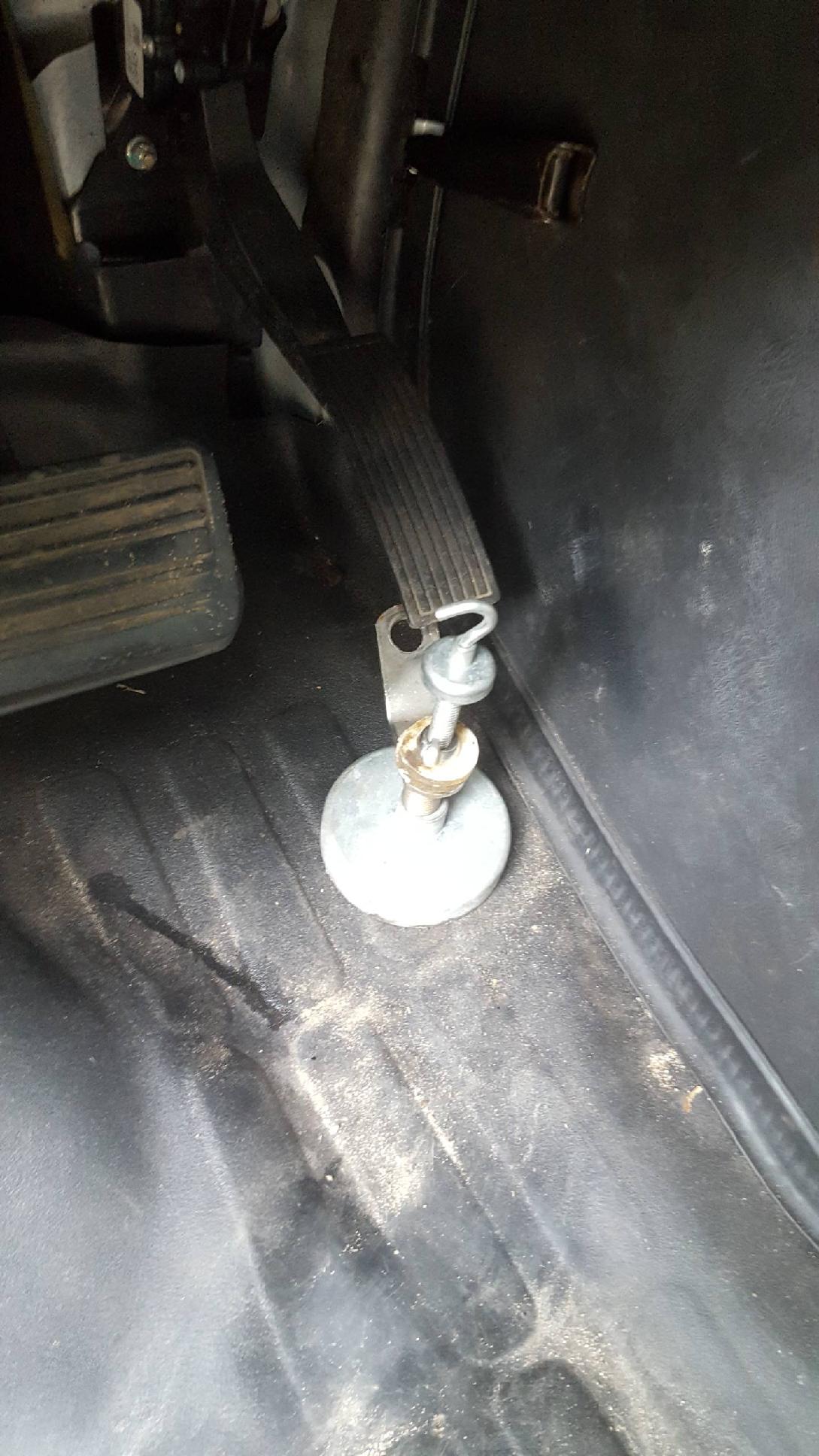

View attachment 112602View attachment 112603

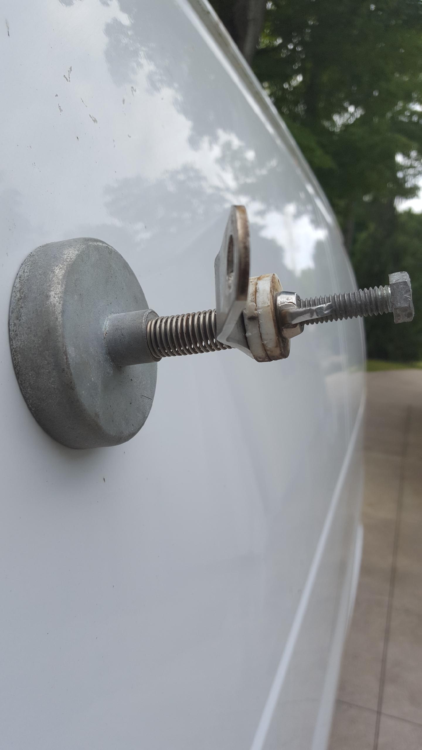

Patent not pending. The magnetic throttle control I use for my 07 Butler works well for my purposes. I can set speed/rpm by dialing down on the threaded rod, using a TinyTach to determine engine speed.
I am only using this setup as an interim measure until I can dig deeper into the mysteries of the Butler wiring this winter.

It''s not complicated. Look at the pic Nate posted. Nothing more than a heavy duty magnet with a threaded rod and a SS bracket that dials down/up to set rpm.

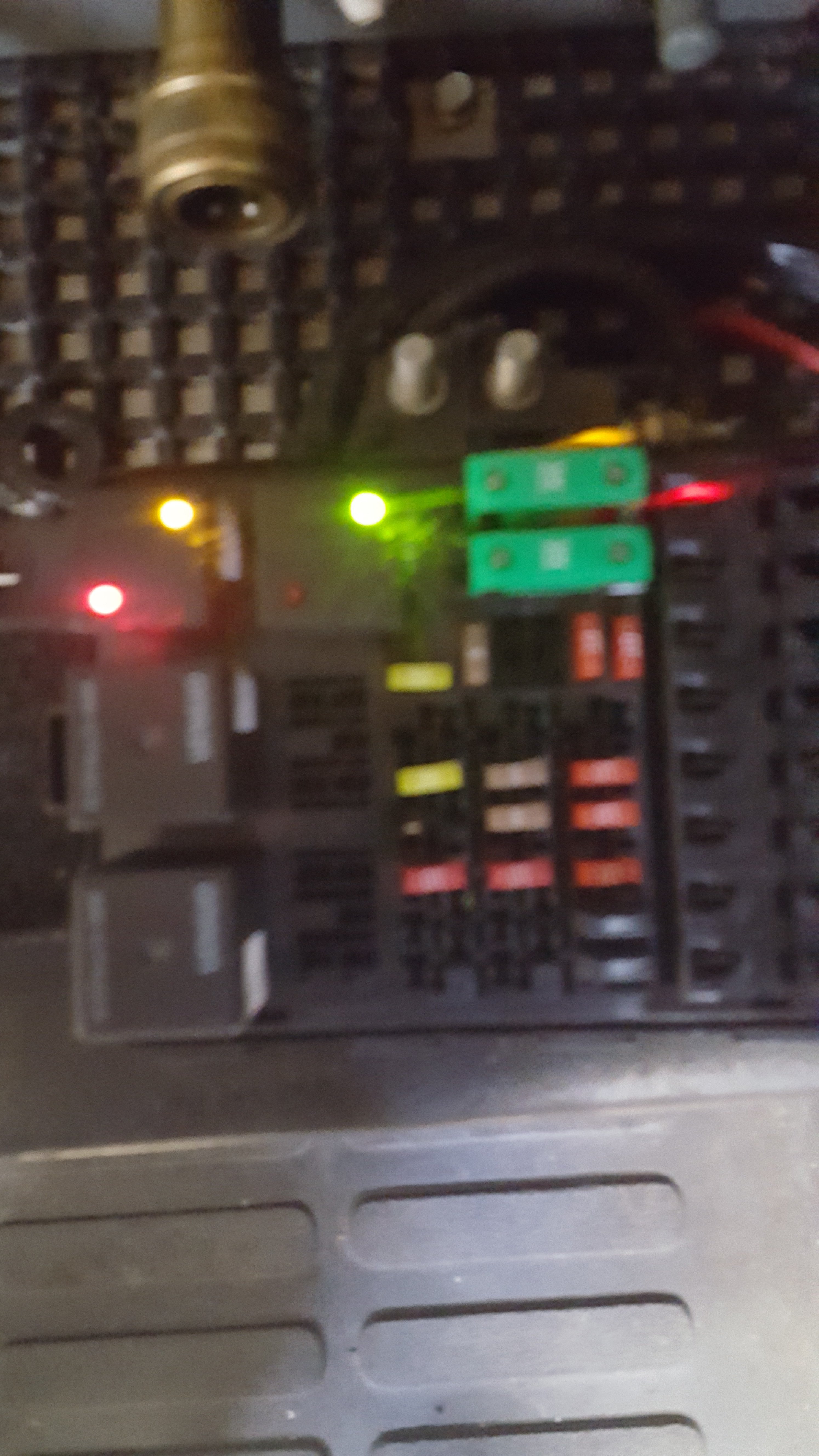

Sorry I can't help much on that. There is a fuse/relay board behind the passenger seat that monitors the whole system. I do know that the wiring on my 07 Chev it's specific to that model year.
