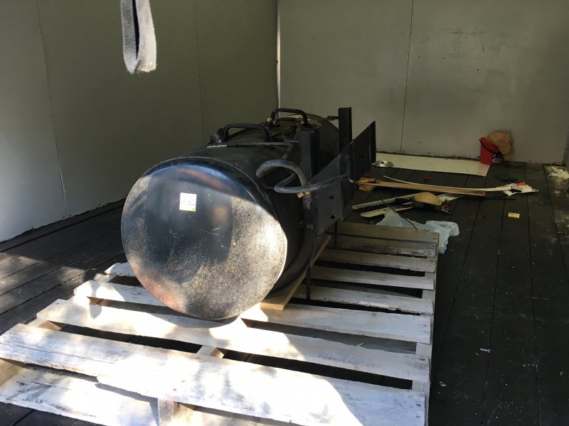

Here's my gas tank for the truckmount
So is this a diesel truck. I have been looking at box trucks for a while would love the space. Used gasoline trucks are not as easy to find. If its that simple to add a gasoline fuel tank then thats not a bad idea. As long as you don't make any mistakes filling up.
14,632
No, it's not diesel. Jondon wanted to RIP ME OFF on selling a fkin fuel tap for $450. I said screw you, I'll buy a whole gas tank for $300 after shipping.
$450 for fkin fuel hoses and maybe a weird angle type of valve. Milking us like a bunch a bitches. Interlink had a very similar number. Don't get me started. The bastards screwed me on 3pvc pieces of 2.5" pipe to mount to my waste tank lid so I could hook a 2.5" hose up to it for $250.00!!!!!!! I got screwed that day. I'm done with being LOYAL to my local distributer. That's why I'm being cheap on all my chems from now on. The markup must be stupid high on those also. It's put a sour taste in my mouth on all the suppliers we have
14,632
Back to the fuel tank. I bought this from a box truck salvage yard in Colorado. It comes with the mount that you have to mount the tank to the frame also. I putting it on the same side as the current tank on the truck, so I can just fill them up easily at the pump. They call it a saddle tank.
And the reason I wanted to buy a fuel tank made for a box truck is because of the element inside the tank having access to the whole bottom in case I'm on a hill with the tank low on fuel. Much better than a home made fuel tap with just a hose sitting in the middle of the tank.

My saddle tank is on.
Question. I need a fuel pump that I can mount on the frame. About 12inches above the bottom of the tank. In other words, I need a pump that sucks and pushes. Which one do I need to order???
The one I currently have on my trailer is mounted under the tank and pushes only

I've been overthinking it. My dad is yelling at me, calling me a dumbass, wasting my money on this saddle tank, for not putting my plastic tank inside the box with the tm, lol
24,146
I like that saddle tank. You will be able to run that thing for days with that big ass tank.
