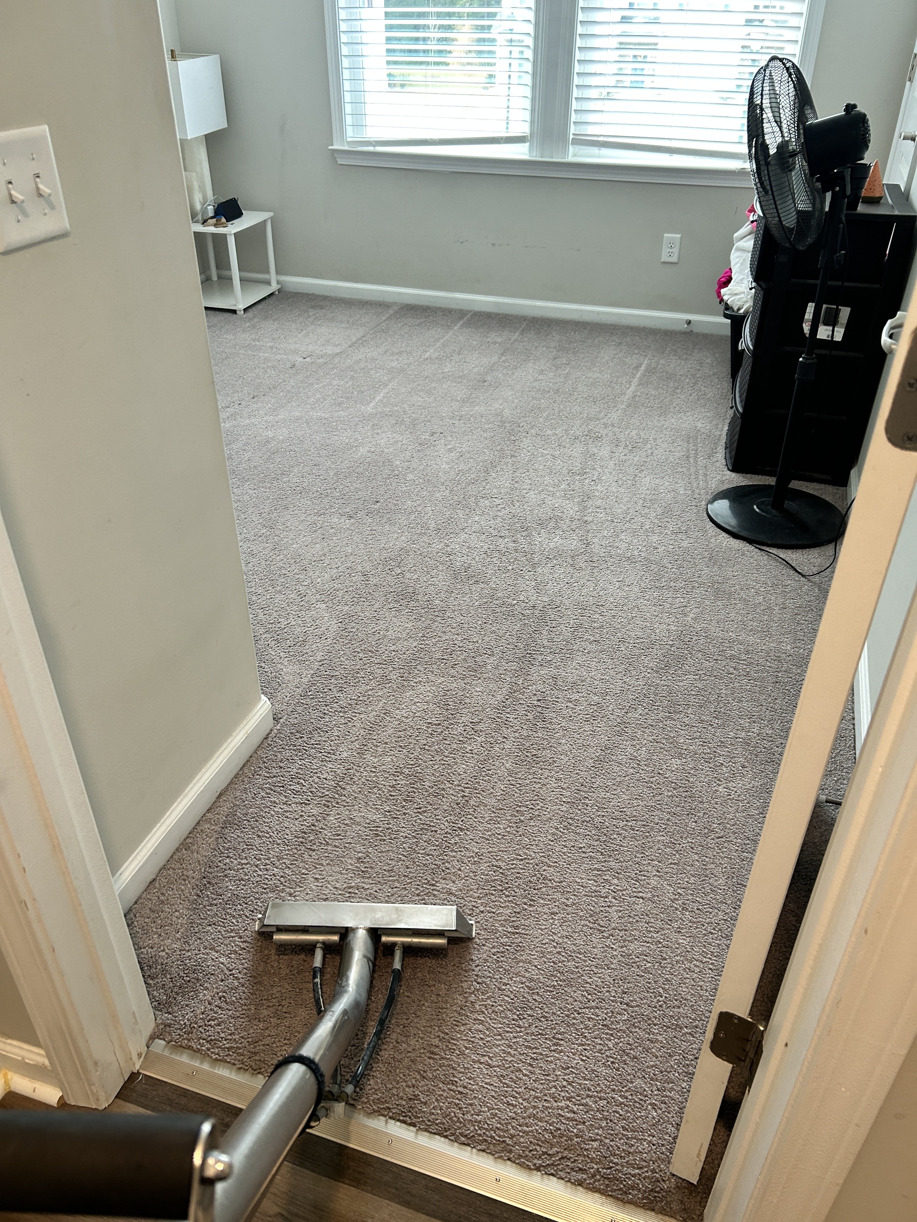

My urine removal process. I don’t have a device that measures urine so I don’t to crazy with the process.
1. Vacuum. A shark vacuum is very easy to clean. I can do it with the whip hose from my truck mount. It dries on the way to the next job.
2. Set truck mount to lowest psi and highest heat. Chemical feed on 3-4. Dry Slury HWE only. No expensive pre treatments that work only 50%of the time.
Rotovac in.
IMG_0763.jpeg3. Wand out with same truck mount setting.
1 wet/4 dry (2 complete dry strokes front to back).
This job was a 3 bedroom only townhome. Took 1 hour 12 minutes from arrival to departure. I charged $215.
