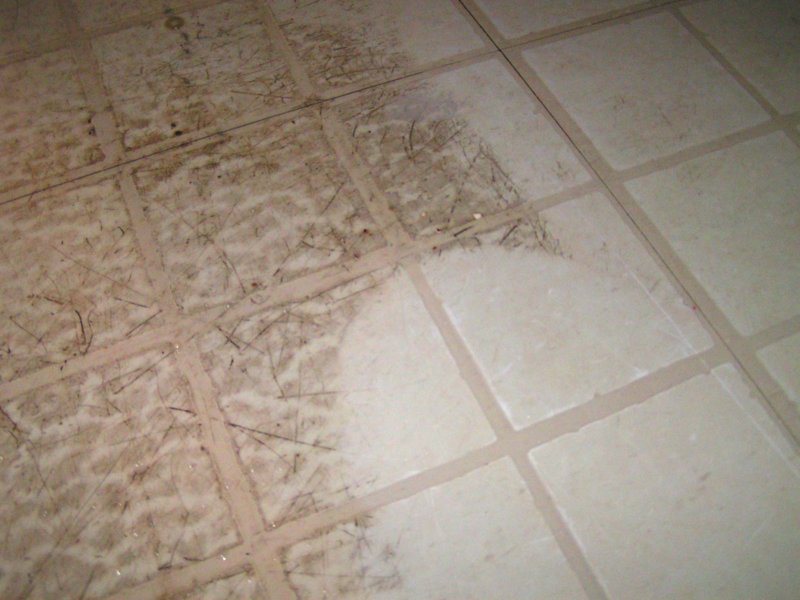

It looks REALLY interesting, if it does what it claims to. I go into some real VCT messes sometimes. Is it good for that?
Medical facilities are much easier for me. Maybe that's a better application?
It does work very well. If the floors are really bad you have to mist the floor and let it stand for 2-3 minutes then run scrubber over it and it will pull the dirt out of the wax up to 4 layers deep.

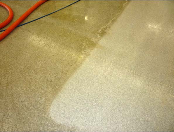

It's good to keep an open mind so you can discover new products, methods or techniques for solving old problems. VCT never got me excited but I get then occasionally and charge from .65 to 1.20 per square foot depending on the complexity. Dental office on Tarkett sheet goods where I have 45 minutes prep time just getting ready to strip. (dental equipment, Charis etc) Since designing the Turbo-Hybrid I appreciate it even more at doing wax stripping as a thorough suck & rinse tool before applying new finish.
View attachment 11715 View attachment 11716
You're using your TM to rinse and extract with? :eekk:
