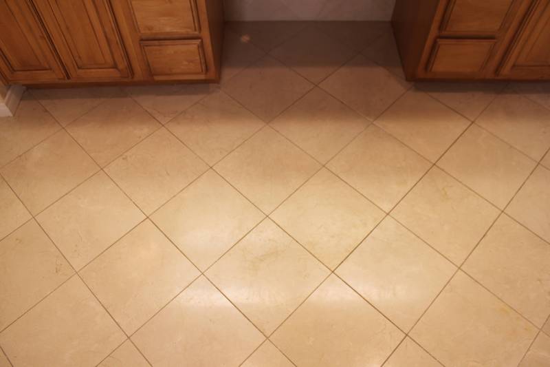

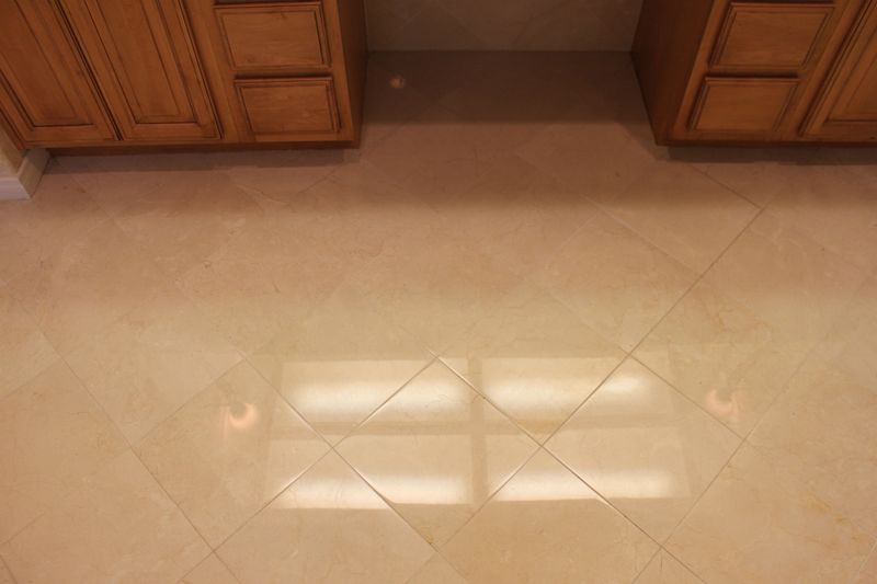

Yes. Like Ted mentioned, if you use a grout brush before vacuuming diamond renew, or any polishing compound, it should clean the the grout fairly well, but 5x will clean as you polish. It basically etches the grout clean. So when clients ask "what about cleaning" I say I am able to incorporate the cleaning process into the polishing process to save you money. Sold.
Here is before an after. The floor was diamond refinished, then polished with 5x. No grout scrubbing, no cleaner, just 5x with a white pad. Notice the grout looks new. The couple dark lines were just still wet, they dried out like the others.

They are both polishing compounds for marble, travertine and limestone in powder form. you put it on the stone, add water and polish with a rotary machine and soft pad to bring the stone to a shine.
5x is the standard, since it was pretty much the first compound of it's kind. It contains 3 main components; Oxalic acid, shellac and a high grit aluminum oxide or other similar abrasive.
Diamond Renew is a little different, it has many more components. It's what a lot of guys get started with because it is easy to use and not considered to have a very high acid content and is user friendly.
There are dozens, or even hundreds of different versions of 5x, every company pretty much makes their own. 5x is a very fine powder and can become airborne when handled roughly, causing sneezing etc. Diamond Renew is a little moist, like brown sugar and doesn't have that problem.
These are probably the most famous two powders, followed by MB-12 (super potent technical powder) and MB-22 (idiot proof user friendly powder) and KP92 (wet gritty paste, user friendly) . All different but achieve the same results. After experimenting with several, it basically comes down to personal preference.
