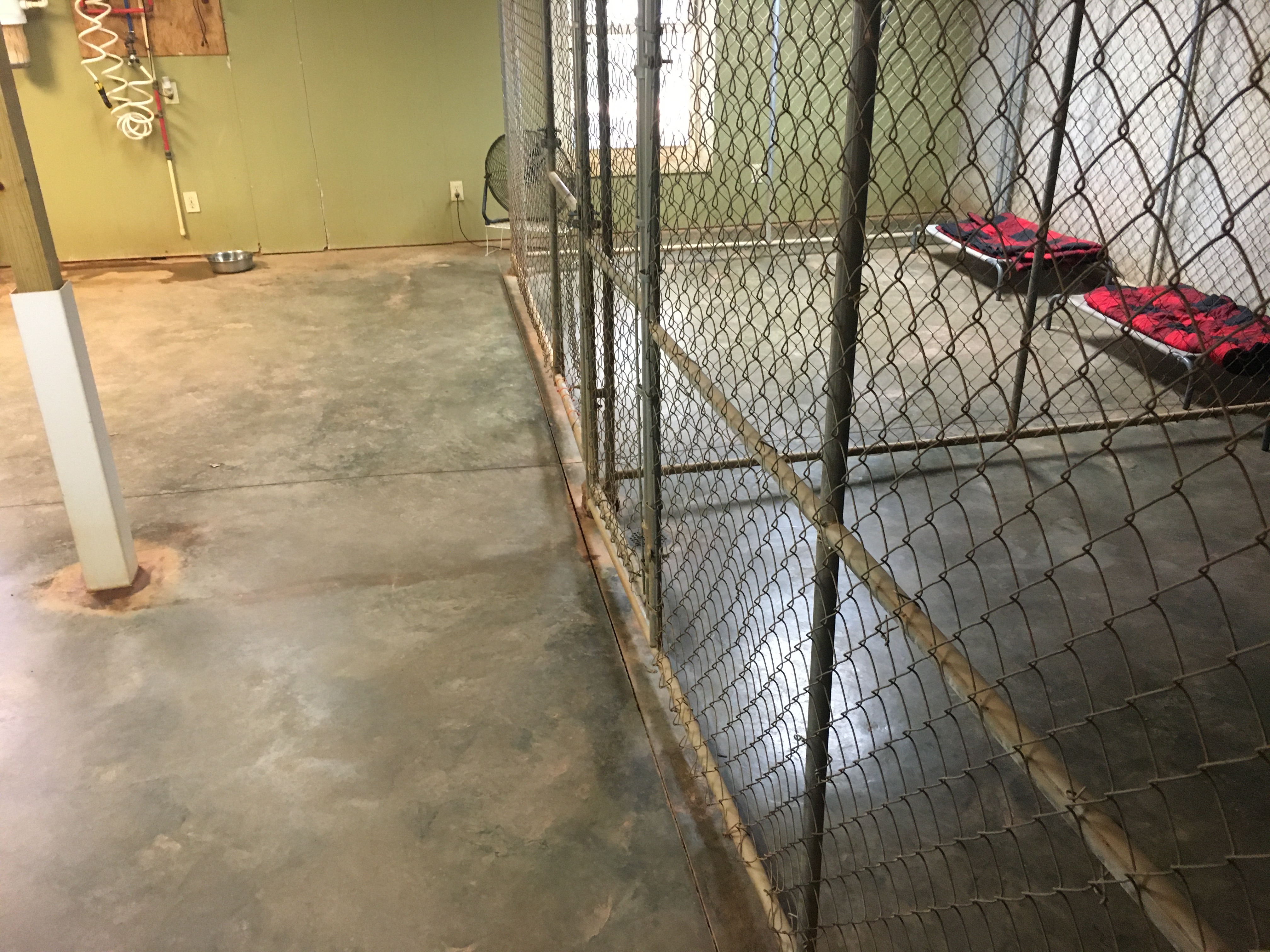

I want to know everyone’s choice of treatment on removing odor and funk

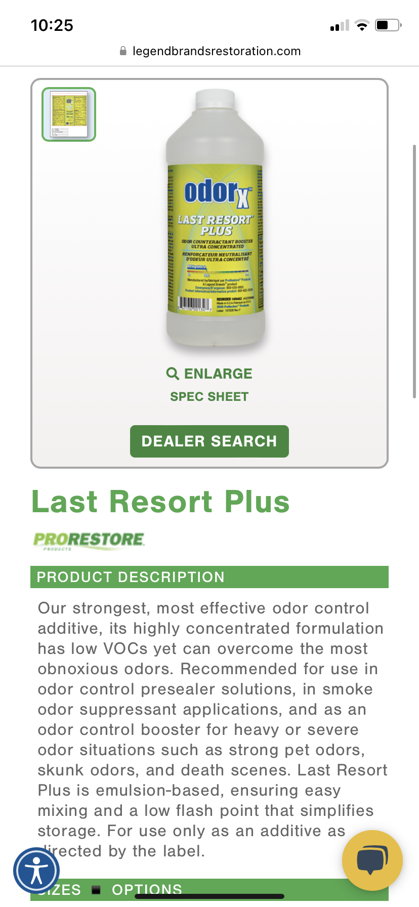

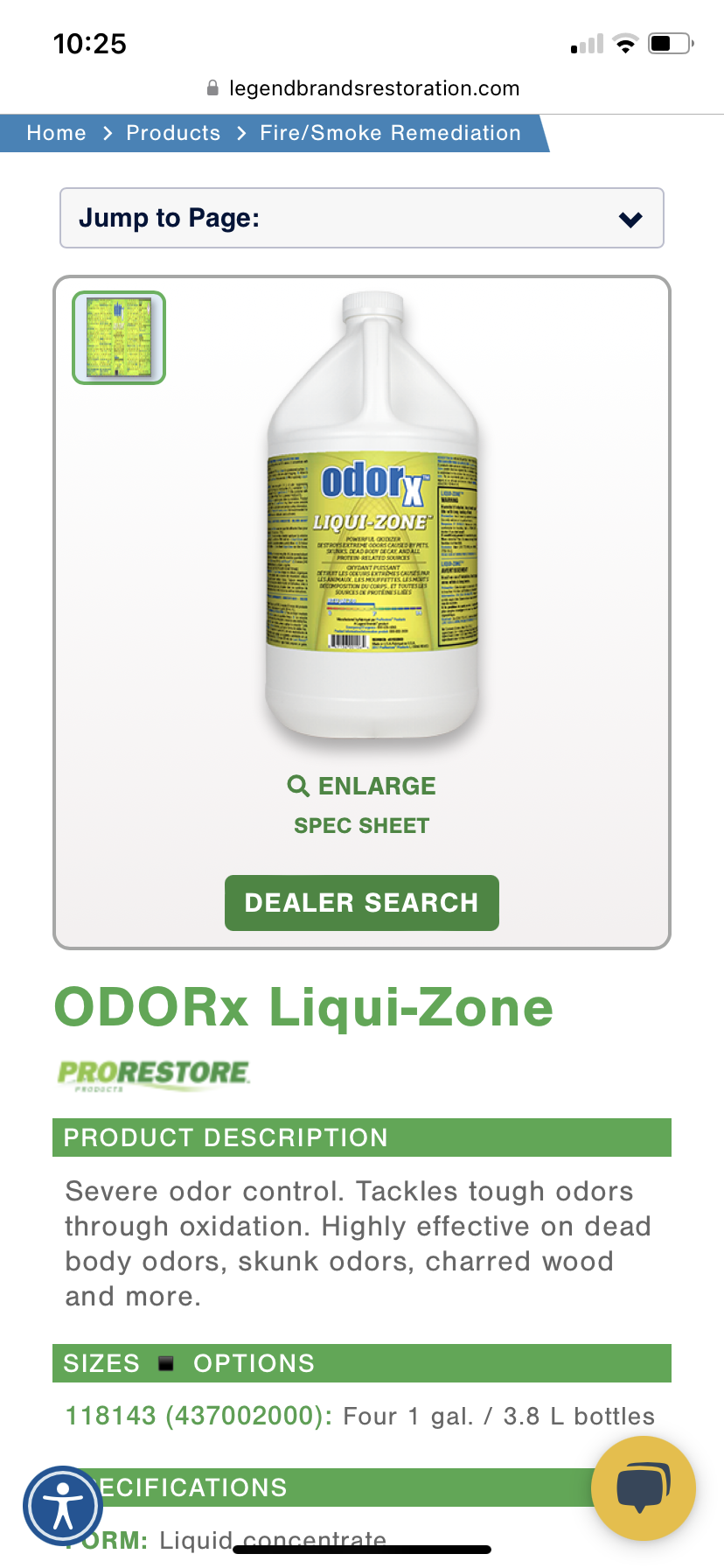

As I am sure you are well aware you have to remove the source. I have never done a job like this, so this just my 2 cents for conversation and learning purposes.
I would try and clean with a real concentrated level of citrus to try and clean and cut through the pet oils. I would then use the Legend Brand products that were mentioned or I would go with some Pro's Choice products. Pro's Choice make some excellent products for treating odors.

The two odorcides I have are CatAttach and Harvard's skunk odor removal.
So could I add peroxide to my initial treatment, dwell, rinse, then treat with the odorcide, dwell and rinse again?

I know it'll be impossible and the homeowner knows it to. She's running some dog business out her home and this is in her basement. The room I was standing in was the other half of the basement which is a normal living area with a living room and bedroom. I'm thinking she's just wanting to get the smell under control. So they won't smell it in the living area
Is there a chance I could damage the surface of the polished concrete with etching it if I treat it with an acid rinse or an acid tile cleaner?
