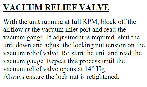

From the SS570 manual:

Tom told me to add washers to the relief spring to get it to tighten up more right now completely sealed it sits at 13.5 hg with a 100 ft of hose and a wand it holds at 10 hg and sits ar about 195 atm.
I took a butter chip put it over 1/2 the holes on the relief and bang with a 100 feet of hose and wand on the carpet it pops up between 12 to 14 and has alot more air flow atw then the heat goes to 240 and doesnt drop.
Gonna put some washer in the relief tomorrow tighten it up so I dont have to use a butter chip.

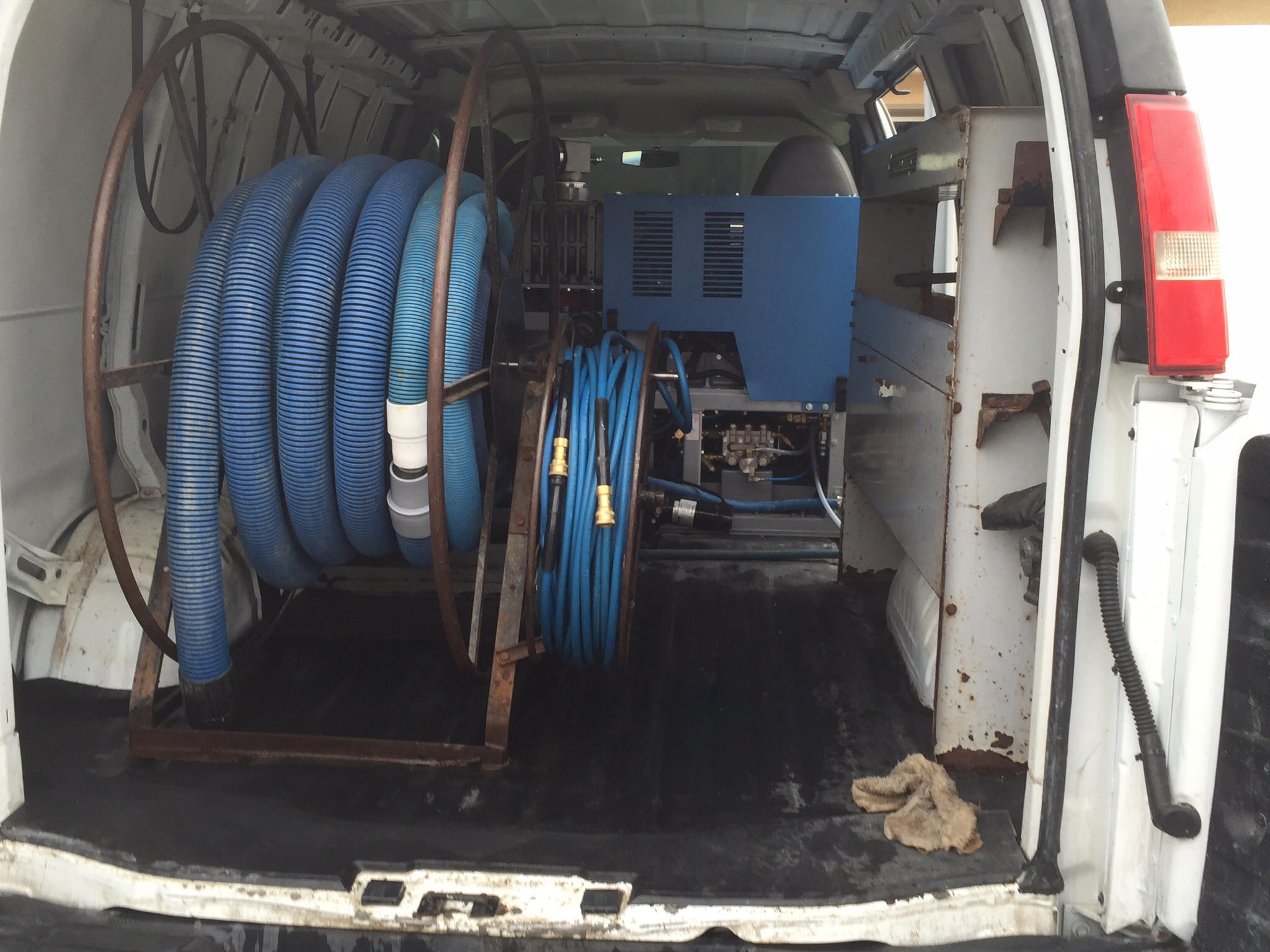

Post some more install pics if ya don't mind.
Ya posting pics is a biotch and I'm not gonna lie that Van is beat up with only 35k miles in it neesds repairs on both side where my son bumped things and the interior needs a major scrub out, after Xmas we might slow down I'll pull everything out and scrub it down. I really need a new chem rack and hose real they're 12 years old and shot.
