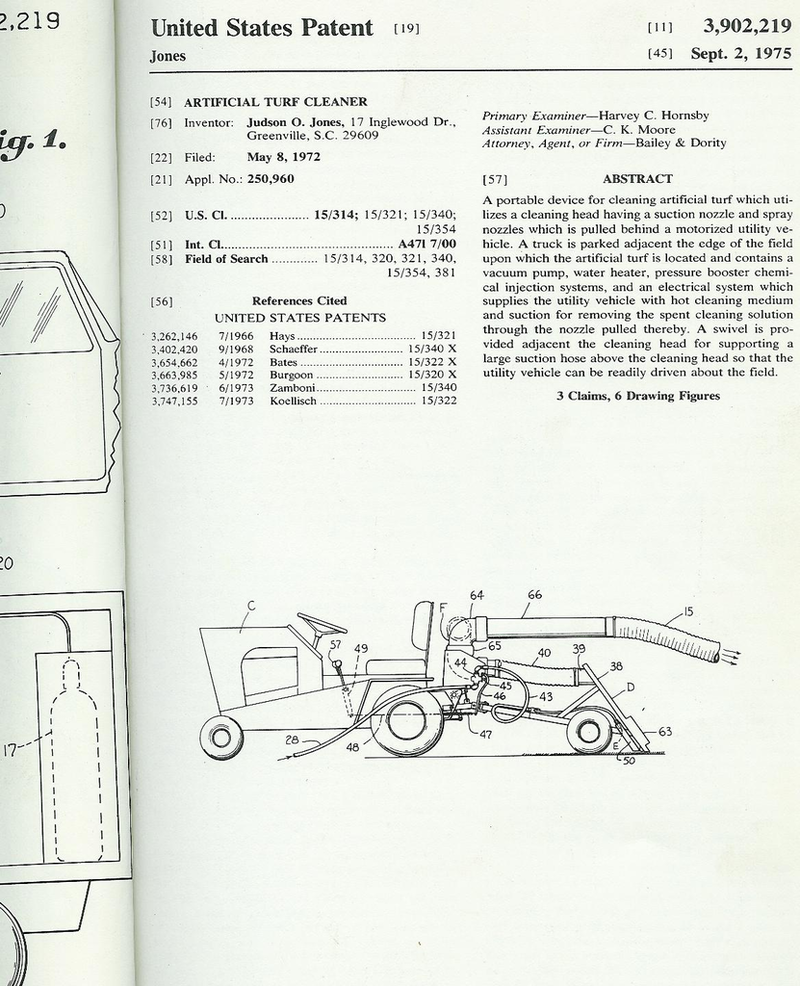

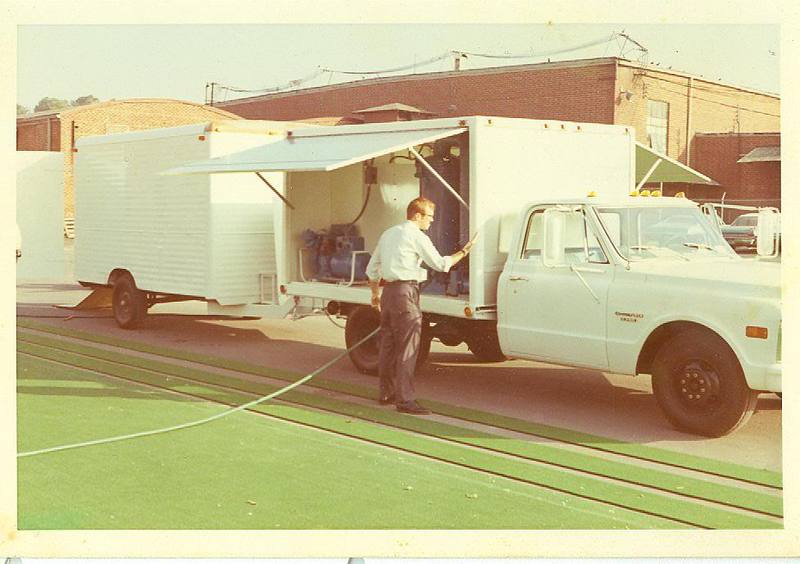

I appreciate you guys bringing Judson up as a possible manufacturer for the big truck. To tell you the truth, to build one is not that big of a deal since we are the inventor of the big truck that my Dad made in 1967. To this day it is the world’s largest carpet cleaner.
