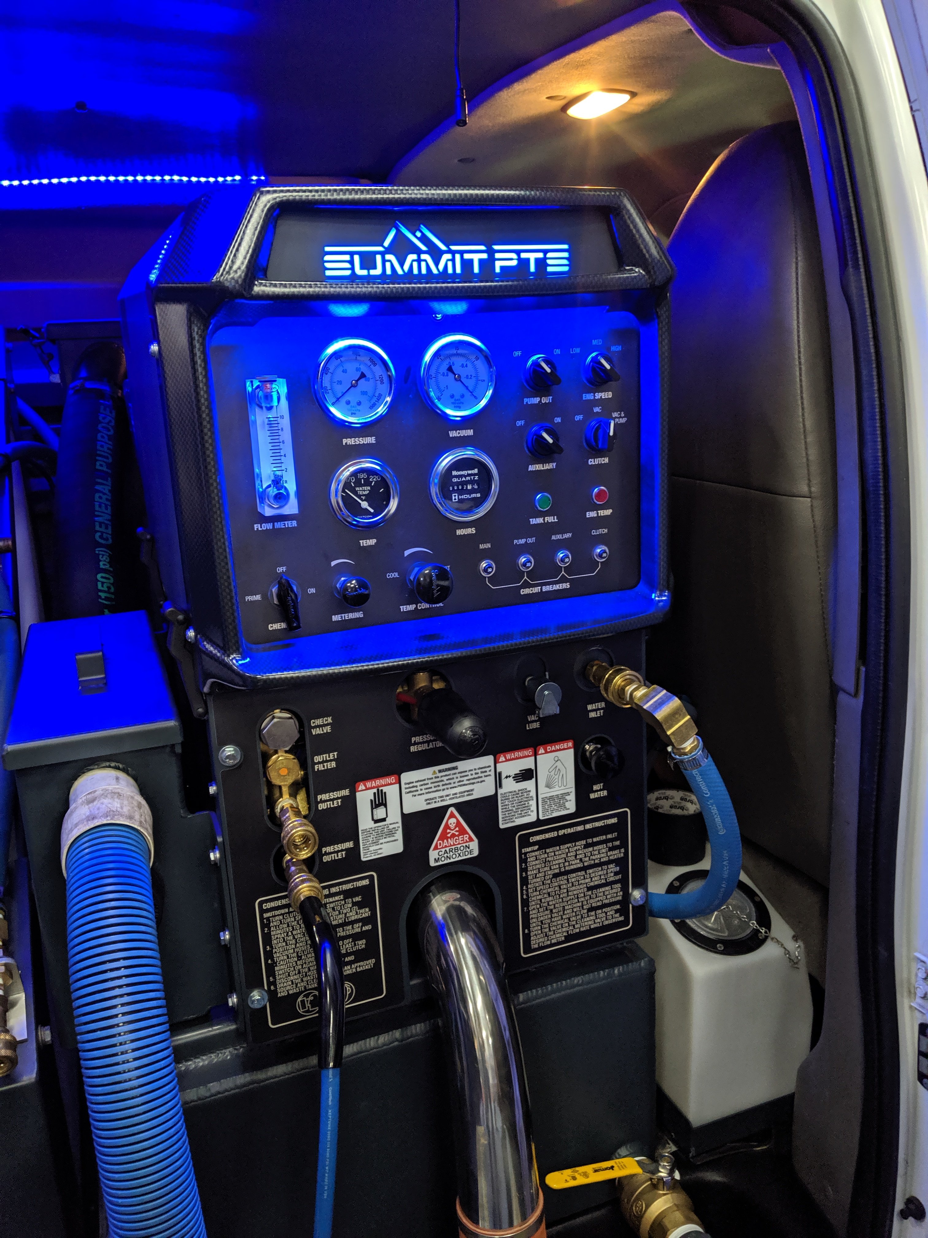

If he's charging you $7000 more than another reputable distributor, that's your first red flag. How does he justify that? Is he giving you extras that the other guy didn't? Hood down always. I have no experience with that unit but typically pto units are easier to operate and maintain than slide ins. .You all have me nervous now. I am getting this installed now on a 2018 Chevy. The company that sold me on it talked about the ease of operation and the limited maintenance. He also was going to charge me $7000 more than another company for the install. Should I be worried about this unit? Brand new to truck mounted units and limited use on a portable carpet cleaner for my cleaning business. Should the hood be up or down when operating?
When people drive by him they say, "look at that poor carpet cleaner broken down there."My local friendly competitor runs with his hoods up, and has for almost 30 years. He doesn't have near the van related problems that I do. I probably won't buy another direct drive unless my Apex 570 turns out to be a piece of crap, I still have two gms with pro1200s that I'll sell off in the next couple years. If I do but another direct drive van it will be a Butler, that was a very close second for me this time.
No air flow , van is parked with engine onHow is the unit heating up the fuel pump? Is the blower exhaust directed at the fuel tank?
I used to have a 1977 dodge motor home. Vapor lock was a common occurrence in heavy traffic. Had nothing to do with the fuel pump. The carburetor was getting too hot and boiling off the gas creating vapor lock. The solution was to extend the air cleaner hose so that the intake was right at the grill. No problems after that.In 1984 I purchased the first Dodge minivan with the American 4 cyc engine . The engine would STOP on the interstate after 2hrs of driving. The fuel pump was on the front of the engine and would vapor lock . Dodge finally figured it out and moved the pump to the rear next to the fuel tank. The heat was excessive and no cooling. Ok in city traffic. My Hydramaster 470 D same problem to much heat behind drivers seat. All doors and windows open still didn't help,vapor lock. It's a killer. jz

I would strongly consider one but worried about fuel pump heating up. I have a new 6.0L ChevyWe'll have one to use in Scottsdale
From what I'm told, all the problems have been addressed dramatically, including engine compartment heat.

I've had 2 hydroboost units replaced on my pro1200se van.12 to 15 years ago we had early fuel pump failures in our GM vans (running CDS units). When we replaced the third one it had a new part number. The only change was to the electrical connector. No failures since.
We don't open hoods, even in 90+ weather, because the electric fans move air pretty efficiently when the vehicle isn't moving. Changing plug wires and belts more often than normal may be due to just looking at the odometer and not adding unit running hours.
I will certainly agree that the Hydroboost unit isn't one of GM's better ideas, and the body metal seems to get thinner every year.
Whats a hydra boost unit?I've had that as well, another part that NEVER fails according to my 30 year mechanic who works mostly on fleet vehicles
