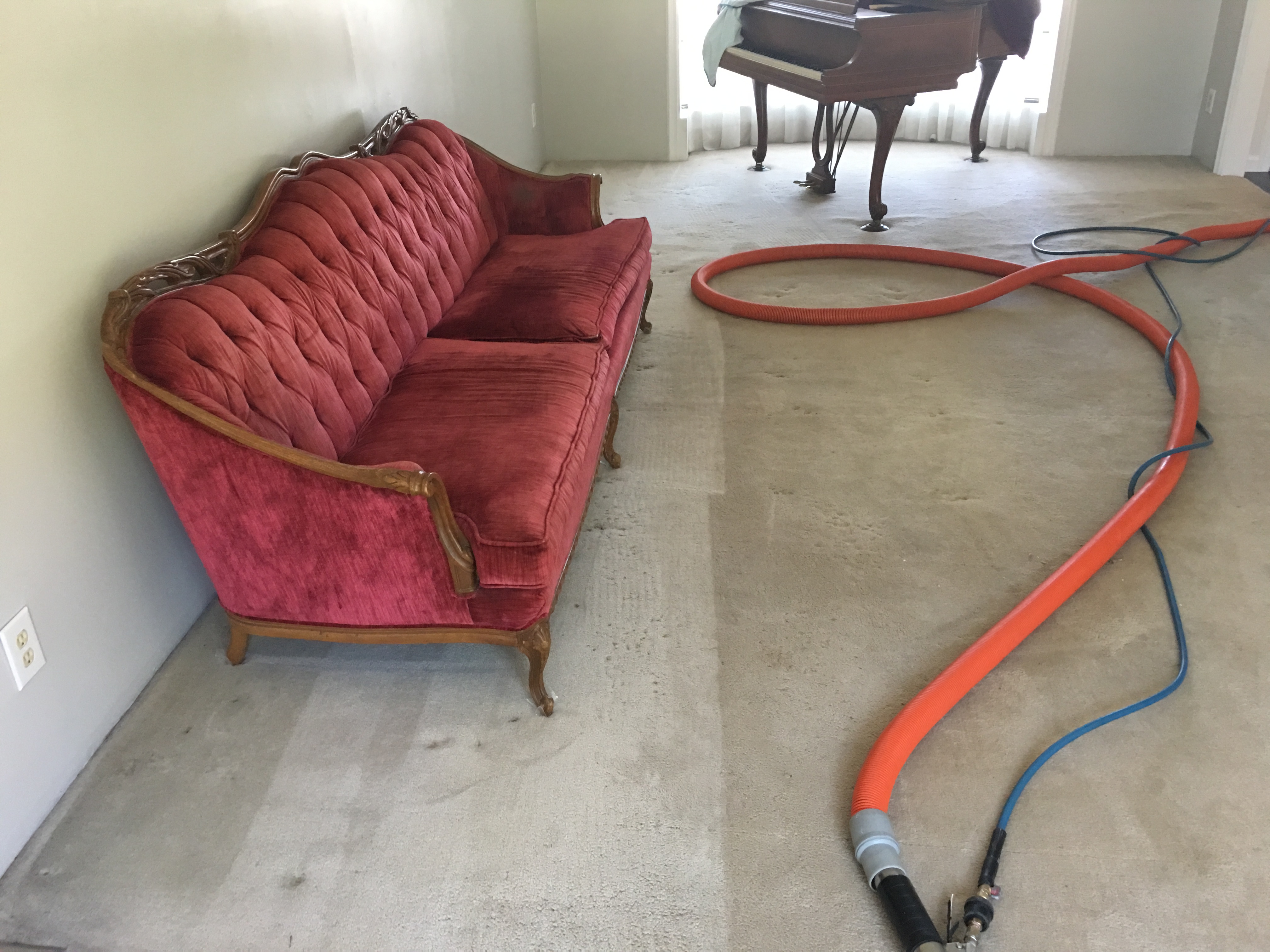

My first job today took me 5 hours. It was a nightmare MacMansion. 40 year old carpet that hadn't been cleaned in over 10 years. The lady got mad at me when I refused to move her Piano and washer/dryer. It would have required me to unhook all the water lines, gas lines, and dryer vent lines. Screw that!!!!!! She ended up calling a friend to move the washer/dryer. The piano stayed in place. I think they both found out what a pain it was and in the process they scratched up the linoleum. I'm so glad I planted my feet and stood my ground. I usually fold.

Don't you have a 360i BH?- If not get one.
Or do you like doing it the difficult way?

1. Rotovac will never get a dollar out of me.
2. No need, Code Red and dev wand made mince meat out of it.
3. I have a Mytee Trex brush head if i really wanted to roto it.
4. Have an awesome day. :)
