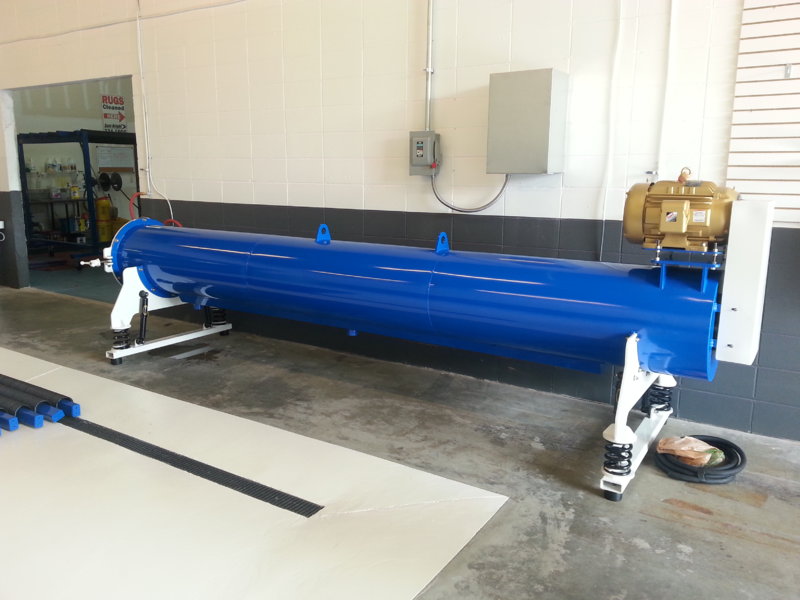

Speaking of Bears.. our rug stuck story... 12x18 chinese 90 line... after three hours of picking our brains, we used a c clamp, a toe strap and a fork lift.. no damage to rug or centrifuge... but might have used up some of Bears luck...

Its only common when you try to get the biggest fookin rug in your centrifuge you can... I have a 16" by 12 foot centrifuge.. this rug when rolled up wet was 14 inches in diameter.. lessen learned.. we now know what too big is.

I've heard of some guys spraying silicone within the walls of the tube. For us the most difficult rug to remove was probably jammed in and wrinkled at the back of the tube wedging itself in. My centrifuge is a different design than Centrum Force and not accessible from both ends. Others may be to0 wide for the tube and forced in. I'd consider those operator error. If it doesn't fit, don't force it. Rugs that stick to the wall are not a problem as long as you can manipulate the center of the rug roll. I wouldn't consider this recent situation a common problem for us. We've maybe had 3 days of downtime in the last 7 or 8 yrs of rug wringing. I can live with that.

How about a rope going over the far end of the rug when pushed in with both tag ends at the door.
