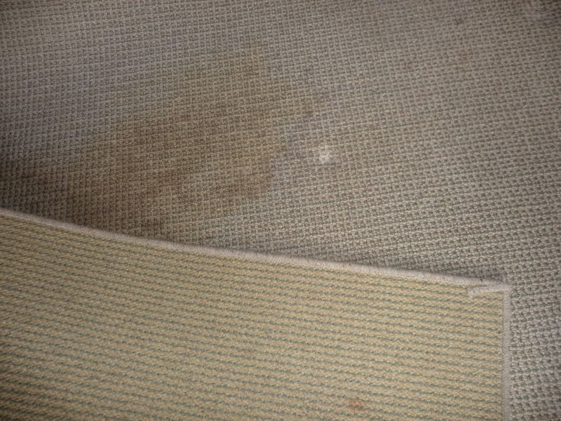

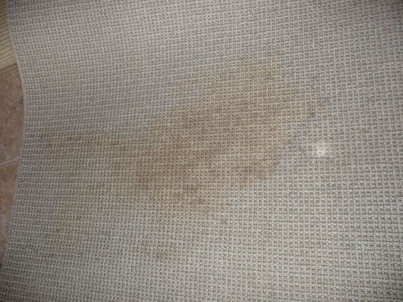

Lets see who gives the best advice here out of Snow, Hyde, OHalicK and our newest faux snob, Mark Kennedy.
Here we have a machine made wool with rubber backing.
Client spilled a full glass of red wine. She dumped a box of Arm N Hammer on it over night and vacuumed it up. Also, her Maid used Vinegar and water on it. Now it has a big yellow halo around it.
If the 4 of you would be so kind to Private Message me your suggestions I will post them anonymously and let you all know who's suggestion worked best.
What do you say.?

prob just a good wash and poss a reducing agent after. not worth pm'g about.

Piece of Karastan Tattersall Crystal Water with a woven karaloc latexed backing made into a custom rug. Clean/ wash it first with normal chemistry and then spot second.
