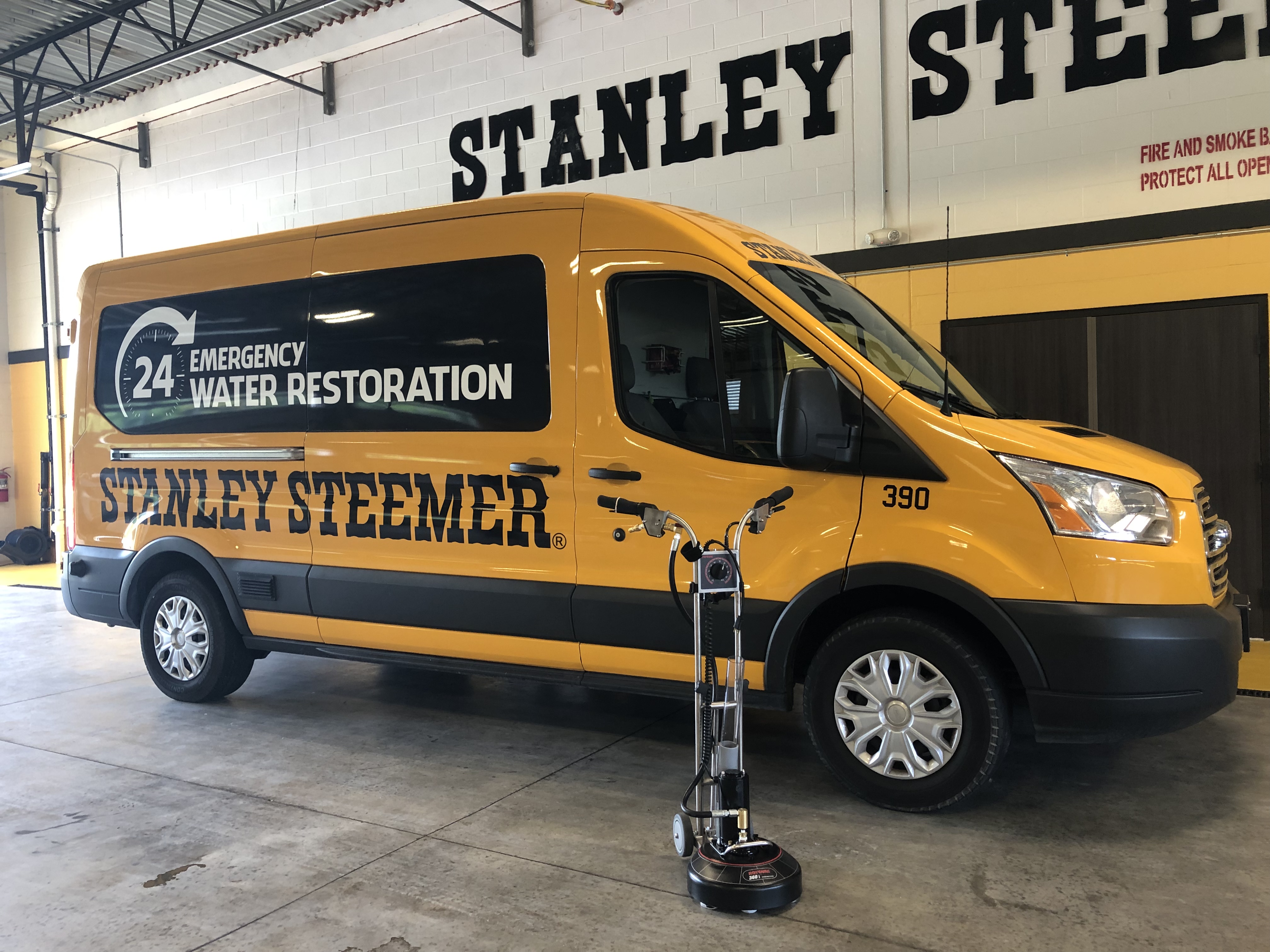

Just unboxed 10 minutes ago
RE in..
Wand out..
Do you set up and prep, hit the bad areas with it at 300 psi. Watch the tube as well as the carpet, you'll know when to move on. Don't hover over seams. Perform a quick dry stroke.
Hook up your wand and clean the clean areas and give the RE'd areas another dry stroke
I use full speed 98% of the time but some say slower dries better, which may help in the Swamp
