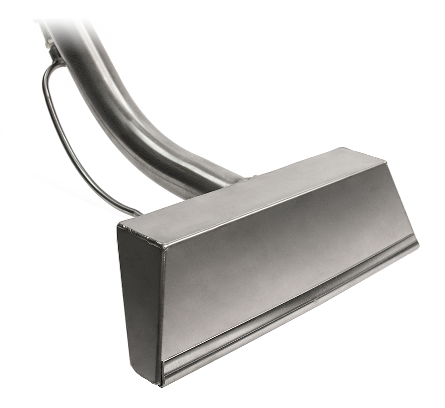

I see they make brush glides that fit mine (14"), but the pipe's welded into the head so one of those sweet gecko heads won't work. What about chemicals? Anything specific for concrete?

In reference to the two jet glide that Fred posted, a picture of that is no longer made , you'll need to get new metal lips (ac33-802) and the GG carpet glide
