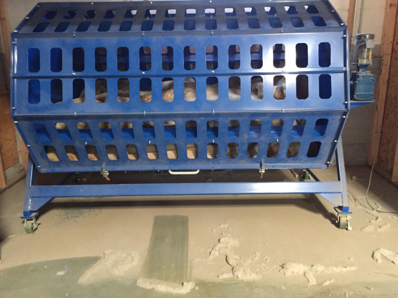

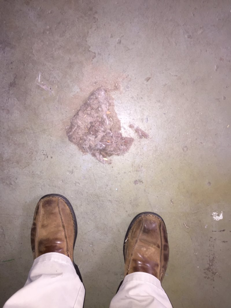

Does it get as much dust out as a regular duster?
It actually gets out more.... As the rug fibers flex and bend, it opens up to shake/tumble dust the dirt/grit at the base of the rug.... That's one of the most time consuming things when cleaning rugs.... It makes it the pile soft to the touch.... Pre-dust and post-dust is awesome when you have a tumble duster.....

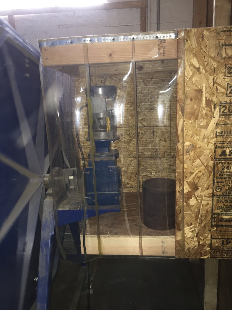

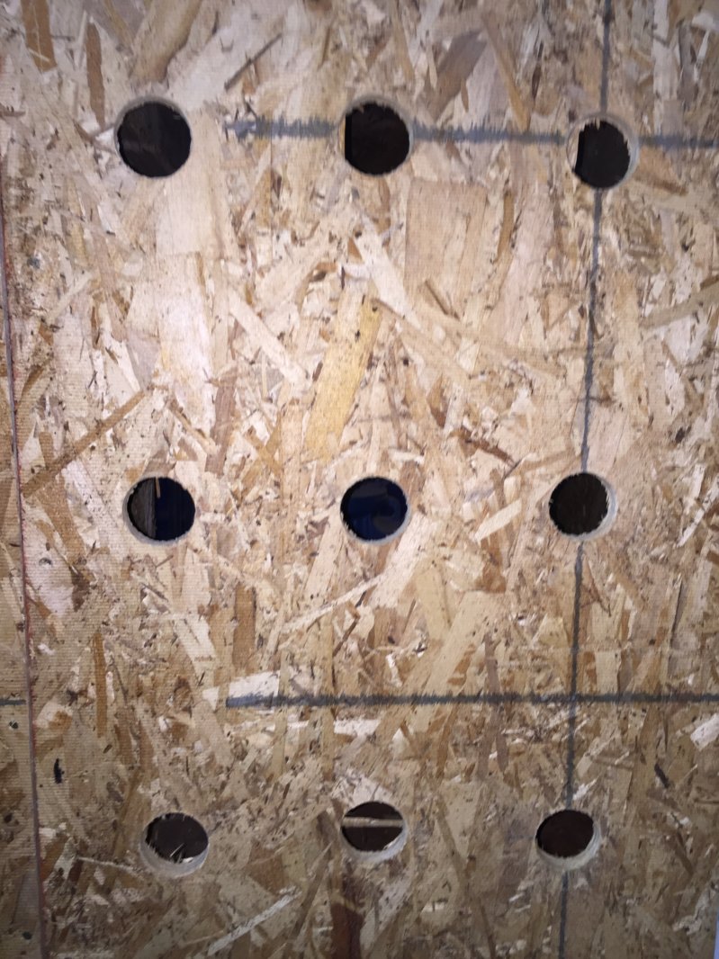

It sure gets more out than I thought. Give me some time with it. We've built a box around the motor with plastic strips allowing us to wheel it out. The holes are on the side of the box for venting.
