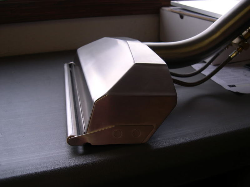

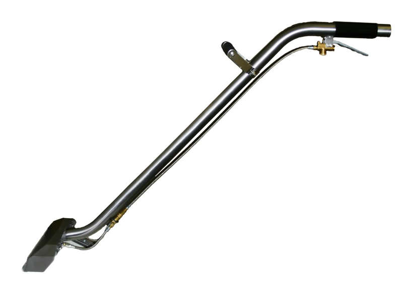

Shopping for a high flow wand, I was curious about this new PMF Titanium Wand. I called PMF and spoke to Curt Johnston. He was a nice guy and gave me a lot of info. He also sent me a lot of pics. I'm wand shopping so I'll give you guys the scoop on this one and you tell me what you think.
A lot of you guys probably use PMF Products and might not know it. They make Prochem and some Hydramaster wands.
The first thing I noticed looking at this wand is no cast head like the PC.

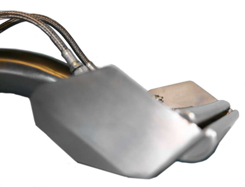

The original factory run a few months ago had stainless steel lip glides and according to Curt were locking down to carpet too much.(product # MACH-15)
So what they did was take the front lip glide off, and replaced it with a roller that is 32/1000ths of an inch lower than the rear glide, so there is always a tiny slot along the front edge of the wand. (Product # MACH-15-R) (I don't know why its 32/1000th's and not 31 or 33.)
Curt says he thinks it slides as well as the Teflon glide he doesn't have the patent to.

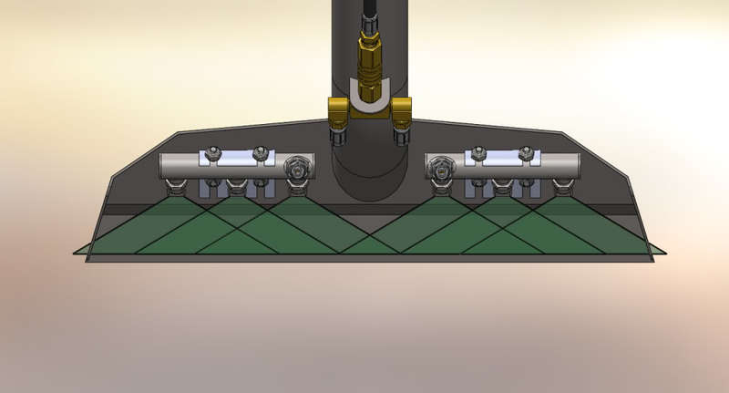

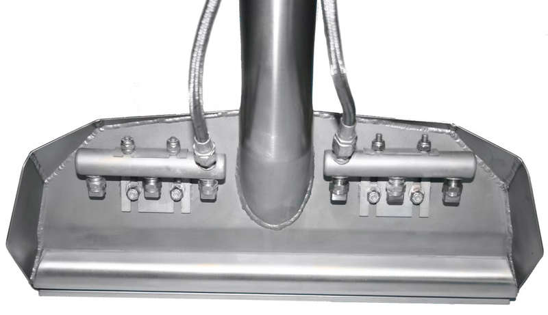

It also has operator adjustable jet height and jet angle. I asked Curt why the jets are spaced in two groups of three instead of evenly spaced. His answer was that the pipe being welded to the back of the head at that angle optimizes airflow, but requires 2 sets of jets. He also said in all of their testing the jets cleaned carpet evenly in spite of the gap.
Have any of you guys had a chance to use this wand? Have anyone ever used a roller glide on anything before?
quote]
I took a ruler to the picture on the computer screen of the jets. There is 1 inch between the jets, except for the 3 inches between jet 3 and 4, the middle gap. Even if you remove jets 2 and 5 so that there are only 4 jets, there would be 2.5 inches between jet 1 & 2 and jet 3 & 4 of the 4 jet wand (jet 2 & 5 missing from the 6 jet set up). Hard to convince me that there is the same cleaning in the middle. Give up a little vacuum to get even cleaning performance is my suggestion. Or find a design to have it all.

The roller seems counter-productive. I want my glide/slot as close to the surface as possible.
Why raise the slot and waste vac, other than to make the wand easier to push, which is accomplished by a teflon glide?
Foster makes a good observation: How do you get next to the baseboard with that roller in the way??

my question would be how long before the roller rust inside and stops rolling...and how well the construction is of the brackets that hold it.it does not look very sturdy.......

Depends on the angle of the wand. Not self-leveling, like a GreenGlided-wand. Needs to be kept level with the floor, which seems like it would be difficult and tiring to maintain.

Well, he started off by telling me that the roller was to keep the wand from locking up on push strokes. I did leave that little tidbit out. So i guess when you pull it, the weight is on the SS glided rear and when you push it, the weight is on the roller.

ummm Titanium doesn't rust :? I'll call and see if they have any ready to go that can get put to the test. I'll think long and hard about who i'll have test it.
looks like that roller will get gunked up with hair and carpet crud.
just like drag wand wheels
doesn't look like there's a way to remove it to clean hair out either

I would find it hard to believe that the bearings on the roller are titanium........the roller itself may be......are there bearings in there.......??

Ok I stand corrected. the Roller is ALL Stainless Steel.

I just ordered it. That roller can be removed. This wand is supposed to pull 280 cfm. I'm in. If i hate the roller then I will replace it with a glide.
