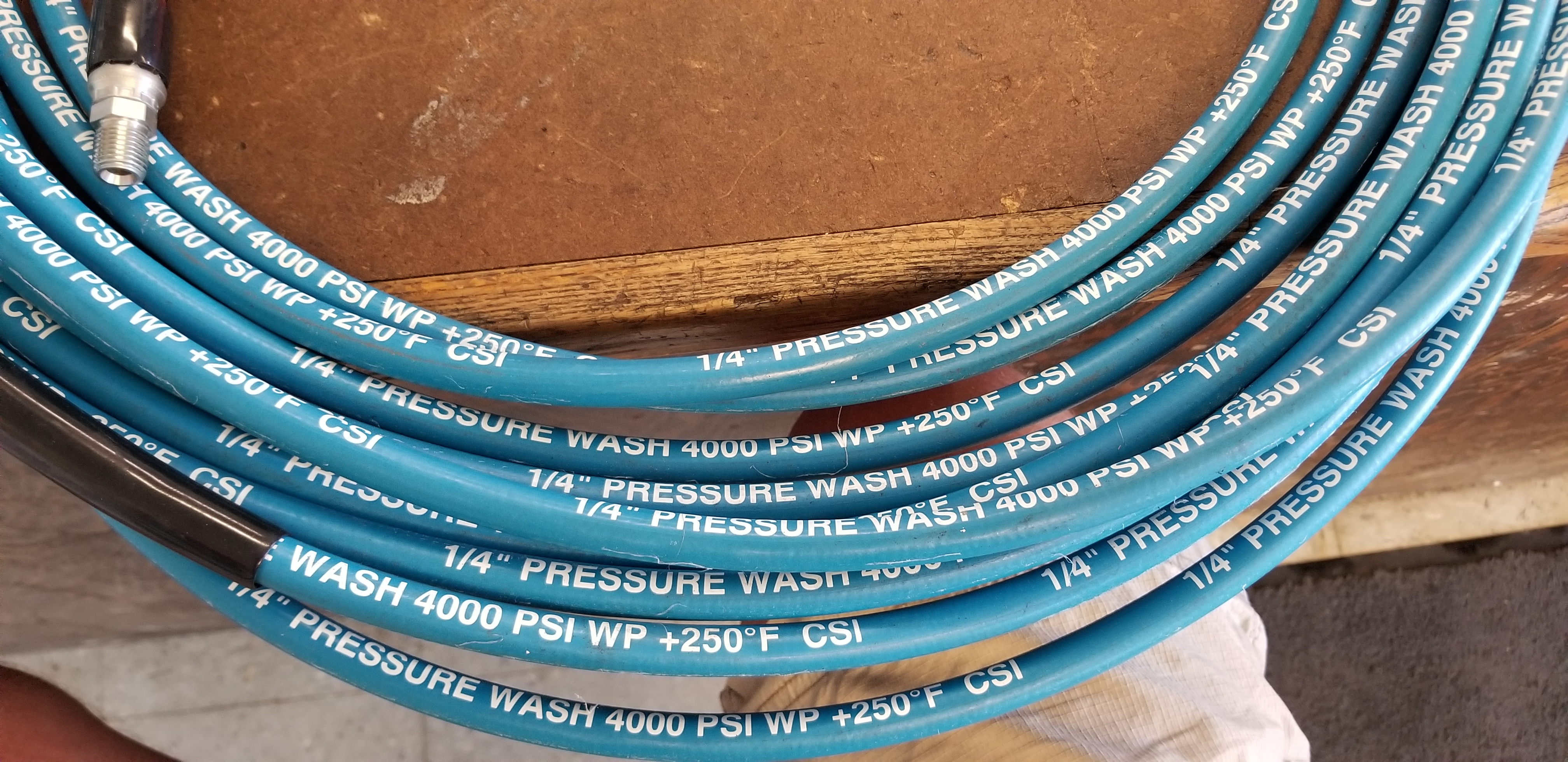

A 3 year old, 110' run of Parflex finnaly got a case of the pinhole warning leaks at the machine end.
I had the local Hydraulics shop cut off a foot and re-crimp
3 times now after a day of use the pine holes come back under the solid rubber bend restrictor.
Never ever seen this happen before with well over a decade of Parfex use on three trucks..
Have you?
