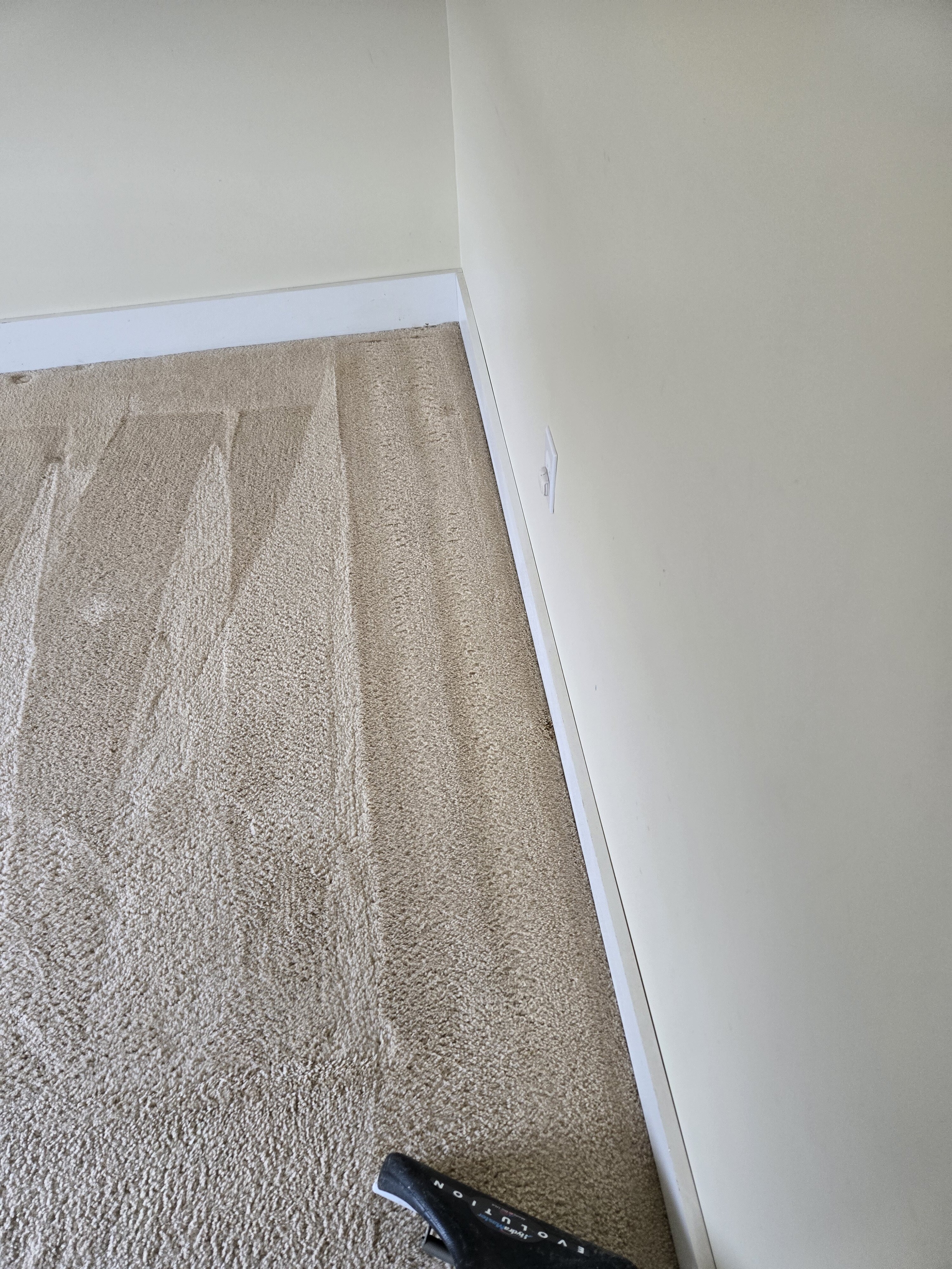

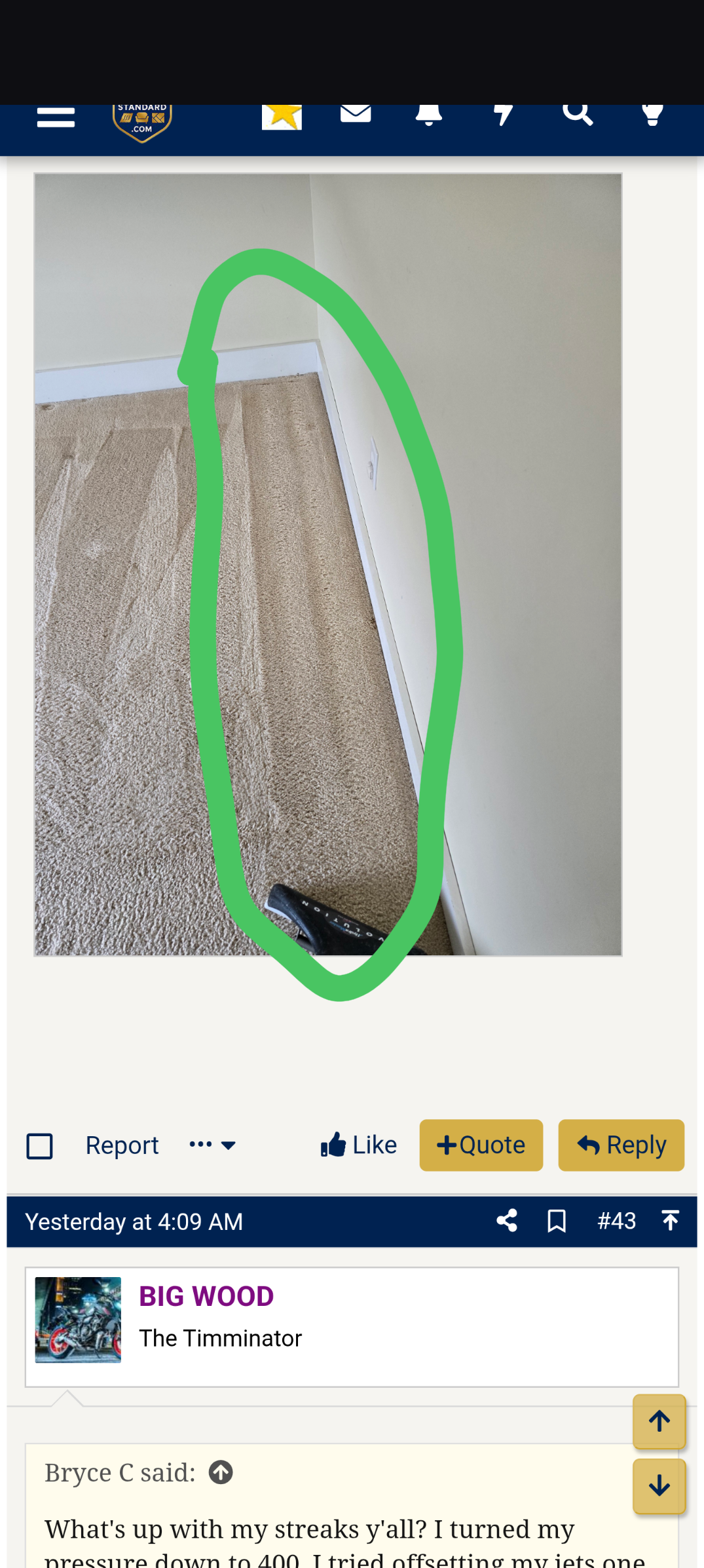

The line in this photo, is that what you're talking about in regards to streaking ?
that's pile distortion.

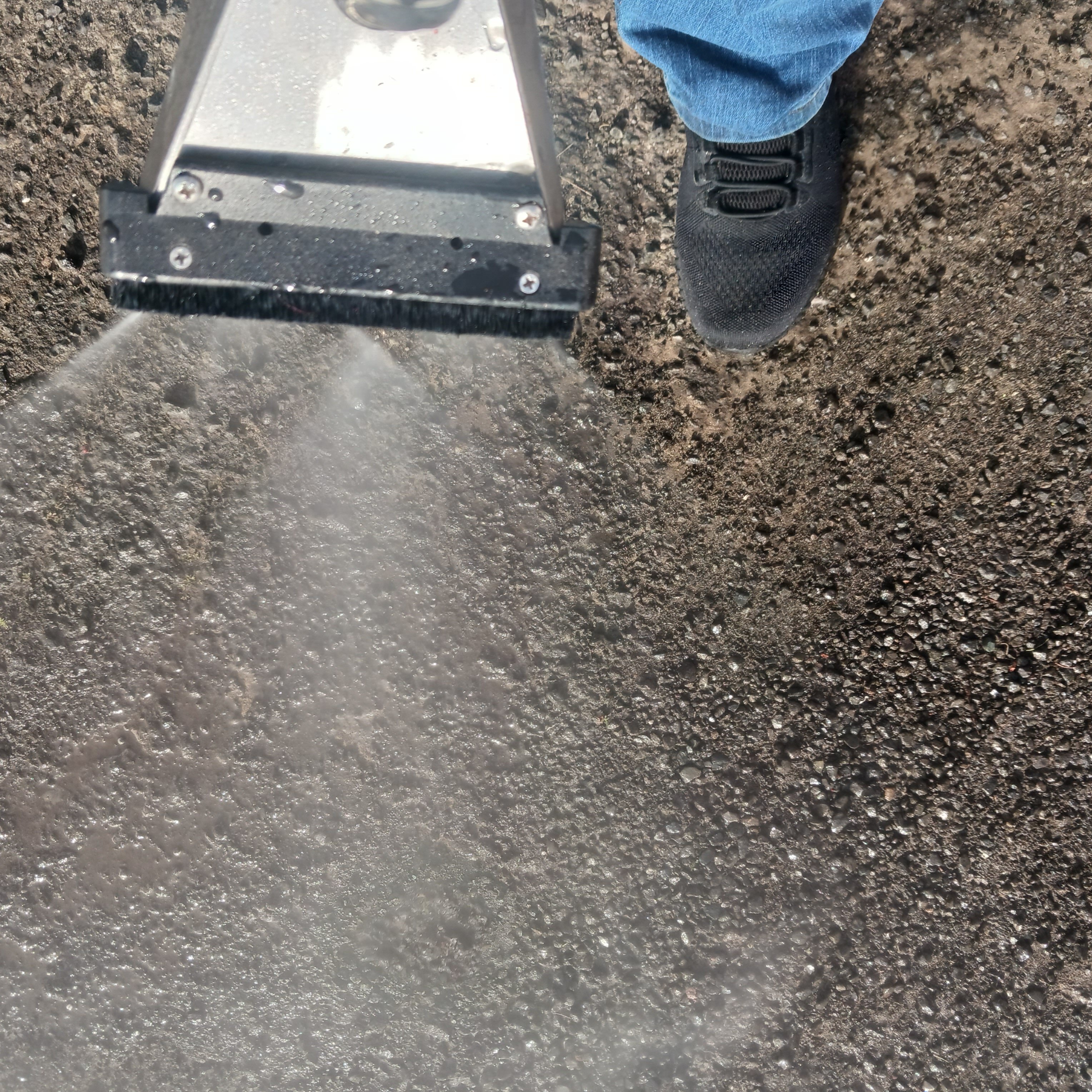

The spray bar on your wand could be improperly adjusted and your brass jets are likely worn out
Put some brand new steel Jets on it and adjust the spray bar/ manifold so that the Jets are striking right behind the Glide, even if its touching the Glide by 10% that's okay
Yes sir 🫡
Great advice, thanks Mike. You don't think those are clean streaks but rather pile distortion? If it was just pile distortion I'd imagine aggressive grooming with a black brush would correct it, but it didn't. Unless by pile distortion you mean the sort that is actually permanent damage?
