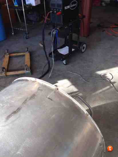

After pulling the waste tanks, there was at least 30lbs of corrosion under them.
After a little work with a wire-cub on the aluminum floor, it exposed numerous holes,
The fresh water tank is a BEAST, Im guessing it weighs north of 400lbs Empty, and WITHOUT the 100lb LID.
It will not be going back in, it will be replaced by a 70lbs Poly Tank.
View attachment 3948View attachment 3949View attachment 3950View attachment 3951
View attachment 3955View attachment 3952The plasma Cutter made quick work of cutting the dual tanks in half, I think it took less than 60 seconds.

What's your plan to fix the floor?
I will be Tig welding the holes with filler metal to close them off using our square wave tig setup.

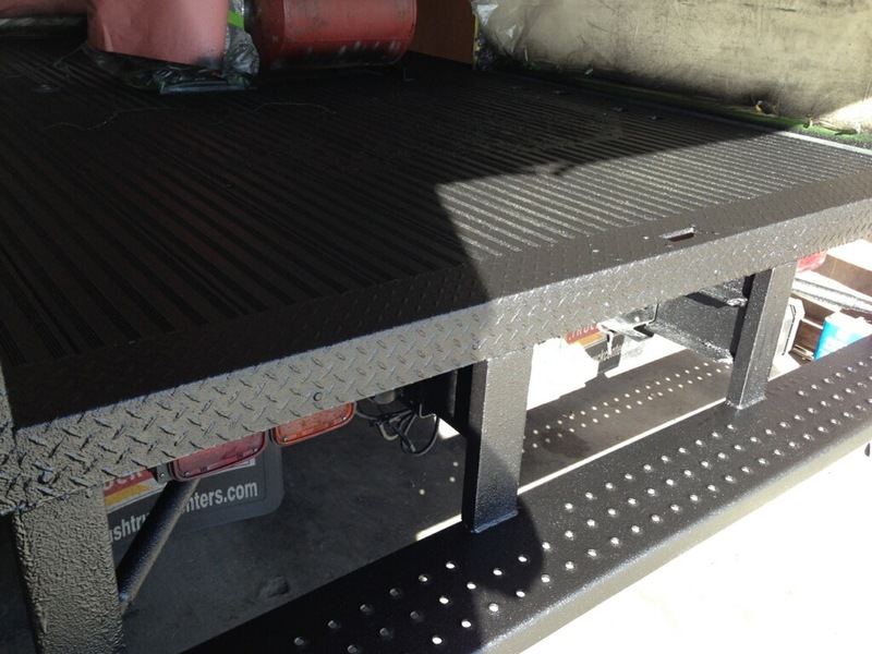

A few hiccups in the project,
1. My NEW plasma cutter blew a capacitor, so Eastwood Co. Is sending me a new one, SO I have to wait for that before I do a few major mods to the V.
2. Line-X decided they wanted another $500 on top of the $1200 I was quoted, even though I'm doing all the floor prep and masking off 2/3 of everything so they don't have to,
So instead of Line-X im Acid-Priming the floor and laying down 1/4 Elephant Bark, Like what they put down in the 7000 H.A.T's

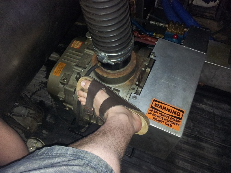

:eekk: WOW, that's a big blower! Can't wait to see what you do with it..

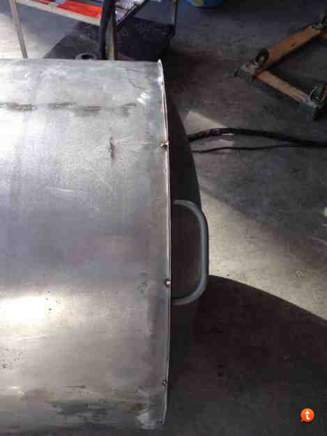

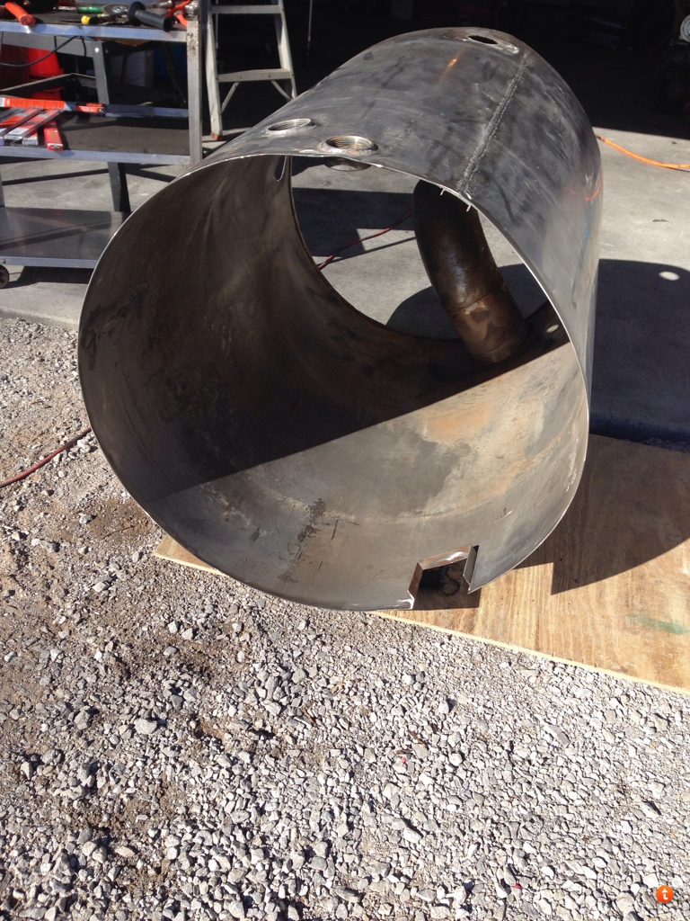

Ask and yee shall receive
Decided not to order a new waste tank from AT and use the money for new roll up doors, welding the lid from the deleted tank to the bottom of the other tank so it will drain properly
