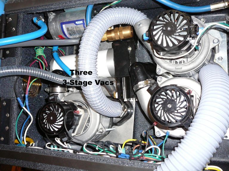

We have a brand new contender for most powerful portable.
New Vac motors have made this machine possible.
It has three 3-stage hi-efficiency vac motors ...
and a 500 PSI Pump system:
Pump-out also installed.
Runs on just two electric cords.

What is the amp draw of the new motors Larry, and what is the amp draw per each cord? What length of hose runs have you tested it with? What is the cost of those motors from you?

Umm, is it just me, or is the APO plumbed to fill the inside of the machine with water when it runs? I assume that hose normally goes somewhere else?

I think it is like just under 20 amps on one cord and 15 on the other according to what ken has 'splained to me. I'm thinking lots of thrown breakers here.

The Recoil is pulling 19 amps no load with the 2 stage and 3 stage motors running on one cord. 10.4 amp 3 stage and I think it was 1.6 amps for the pump on the other. The new Recoil I think is 13.5 amp 3 stage on the pump cord. I would take a machine like Larry is building with 3 cords and if it works ok on two circuits you can plug in two cords to one wall outlet, but 3 cords gives you options. I run 2 Honda 2000 watt generators that can run 11-12 amps continuous and weigh 45lbs and real quiet. One cord Honda and two house or two cords Hondas and one house. Options.

JHC.....Larry.....Where do I start with that abomination?
I had hope you were gonna Give the boys here a good show with something new and different.....Just shoot me.
Now I'm back to just buy an M5 and be done with it.

Putting a third vac in SERIES behind 1 of the 2 avail. parallel vacs (that SHARE the SAME vacuum manifold) is just imbalanced redneck nightmare design.
It's stuff like this that misleads the newbies.
Why would you want incresed Waterlift on 1/2 of your vacuum system?
It doesn't even need the third vac, the 2 high efficiency vacs making 230 cfm @ 146" waterlift is plenty.
All that at a sacrifice of the paltry undersized DC motor pump?
Put the M5 AC pump motor back on....please.
And Panel mount the pressure regulator, and add some better COOLING to the Chassis, cause you are gonna need it, thos vacs put off some heat. Where is the Pressure Gauge?
The auto pump out needs Larger diameter hose as well.

Oh man, I pity the poor dude that has to get in there to repair or replace anything. That looks like 10 pounds of shit in a 5 pound bag.
What about heat? I would imagine that compartment gets hot enough to cook an egg, or should I say cook a motor prematurely. I would have to think one would get better suck putting two 3 stagers in there, and running a 3 stage inline booster closer to the wand, plus the unit would be way easier to service if needed. That pump looks shoehorned in there, and it's only 500 psi, with a dc motor! And is that a pressure adjuster there? If so, that has to be quite the PITA popping that thing open when you want to adjust the pressure. No thanks, I'll keep my 1500 psi, 3.2 GPM external any day.
And that third motor, the one in series, maybe it's just my eyes, but why / how is the hose connected to the inside of the exhaust?? Plus with that bend in it, that just has to be killing the bulk of what suck it should provide.
117,380
Larry aren't those fans suppose to be sucking in cool air from out side the compartment?
Did you or ken Harris design that?

The primary cord is drawing 19 amps. It requires a 20 amp circuit.
The second cord is drawing 14 amps. It requires a 15 amp circuit.
There is a fan cooling the equipment and a vent at the opposite end.
The pump system has about 1.4 GPM of water flow.
It is not quite as crowded as the picture portrays it.
The pump-out hose was not connected when the photo was taken.

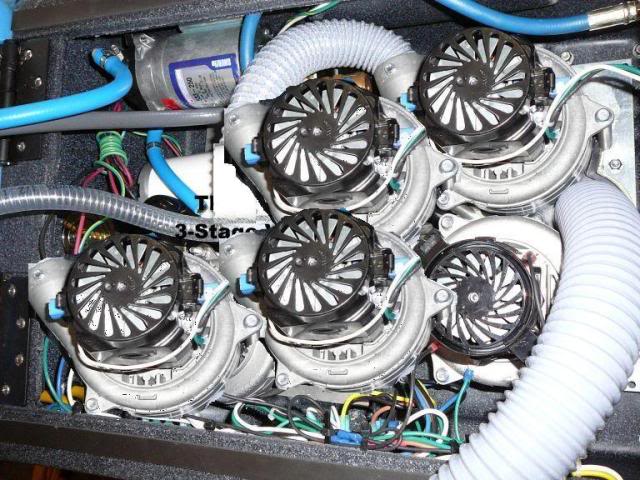

PS. Willy, the 4 vacs you like are 250 air watts each or 1000 air watts total.
The three 3-stage vacs are 600 air watts each or 1800 air watts total.
Greenie - I am sensing a little irritability in your posts.

Ummm - No Larry. 404 air watts per motor, according to specs and an easy run with pump on 3 cords.
Brand new (not rebuilt) 2-stage, 5.7 inch, 110-120 volt Lamb Electric 116472 motor. PLEASE NOTE: Many motors have the number 6472 - it is actually a part number, so be sure your motor has the same measurements as this one. The Height 6.75", Bolt Height 2", Waterlift 106.7", CFM 112, AirWatts 404, Amps 10.7. Replaces 116474, 117073, 7073, 117795, 6474, 7795, 119260, 9260 motors. (119412 is similar except the 116472 has a limited warranty since it spins faster and therefore has a shorter life, but the upside is it has higher CFM and waterlift specs.) Used in many applications, brands and models.

There are some SERIOUS tight bends in that vac plumbing.

First RED flag I see with this design is....if you were using the current GS brand motors that make 115 cfm each, that would be 345 cfm on a SINGLE 2" wire flex hose, with at least one barb in the mix, so that is really closer to 1 3/4" bottleneck.
Second flag is how are you going to Couple all three vacs to the single hose/pipe?
If Kenny were really a genius he'd had figured out how to have three "stacks" in the tank, all I could manage was two big ones.
I'm also wondering why all that heat couldn't be put to use heating the water? Something like the perfect heat system powerflite uses? Or would that be breaking patent laws?
You probably could.
It doesn't change the fact the cabinet is still gonna be 130 degrees and quickly aging every wire and plastic in it not to mention reducing the life span of said components....The name of the game is Keep them Cool, not heat them up and try to "capture" that heat....the heat is still there.

The reason the hose is going inside the vac motor is to lower the airflow and thus the amp draw, I think. Correct me if I'm wrong. (it won't be the first time)
