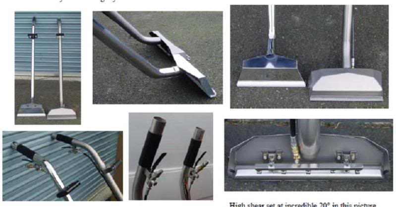

New 5 jet PMF Titanium Wand

I think it looks Awesome!! I'm looking into a Sears version with the Joe's 5 Jet sheer kit.

Looks a tad clunky but I haven't tried it. If it's jetted properly and is built to use a hole glide it might be a winner. I'll be following this closely.

I should have one in my hands in about 2 weeks.......give me a bit of time to put it threw the paces and I will let you know.......

Are those removable metal lips or part of the head like Taf's Big Boy?

that thing hanging off the front edge kinda concerns me.......there are places that you can't go with the wall you have to go at it straight on...and that (what looks like a good inch to inch and a quarter) thing that is sticking out may leave to big of a gap when trying to edge.....I am also curious to see how hard it is going to lock down with a big blower...... It does have notches cut in the sides that will help relieve some of the pressure....But until I get it on the floor I don't know how it will do.........

The metal lips must be removable because he said that a teflon gide will cost you $100 more.

you may be correct.the picture I put up looks like a weld on the back..but I found a few more and it is not welded on.......

the "ski" was supposed to help with pushing the wand. ACcording to Joe it still locks down.
Put a glide on it and will have to adjust that jet angle. Too thin an angle and the flushing isn't as good, too steep and its the same as the old wands.
Nice looking wand but I'll stick with my Greenhorn

20 degree? I bet it's worthless on high cut pile. I do like some of the cheep 2" PMF wands. who cares needs titanium with a green glide?

What do you think of the 6 jet PMF Titanium wand, a Joe Bristor email? It looks like the spacing would be better. The two outside jets seem more likely to cover the whole wand path.
