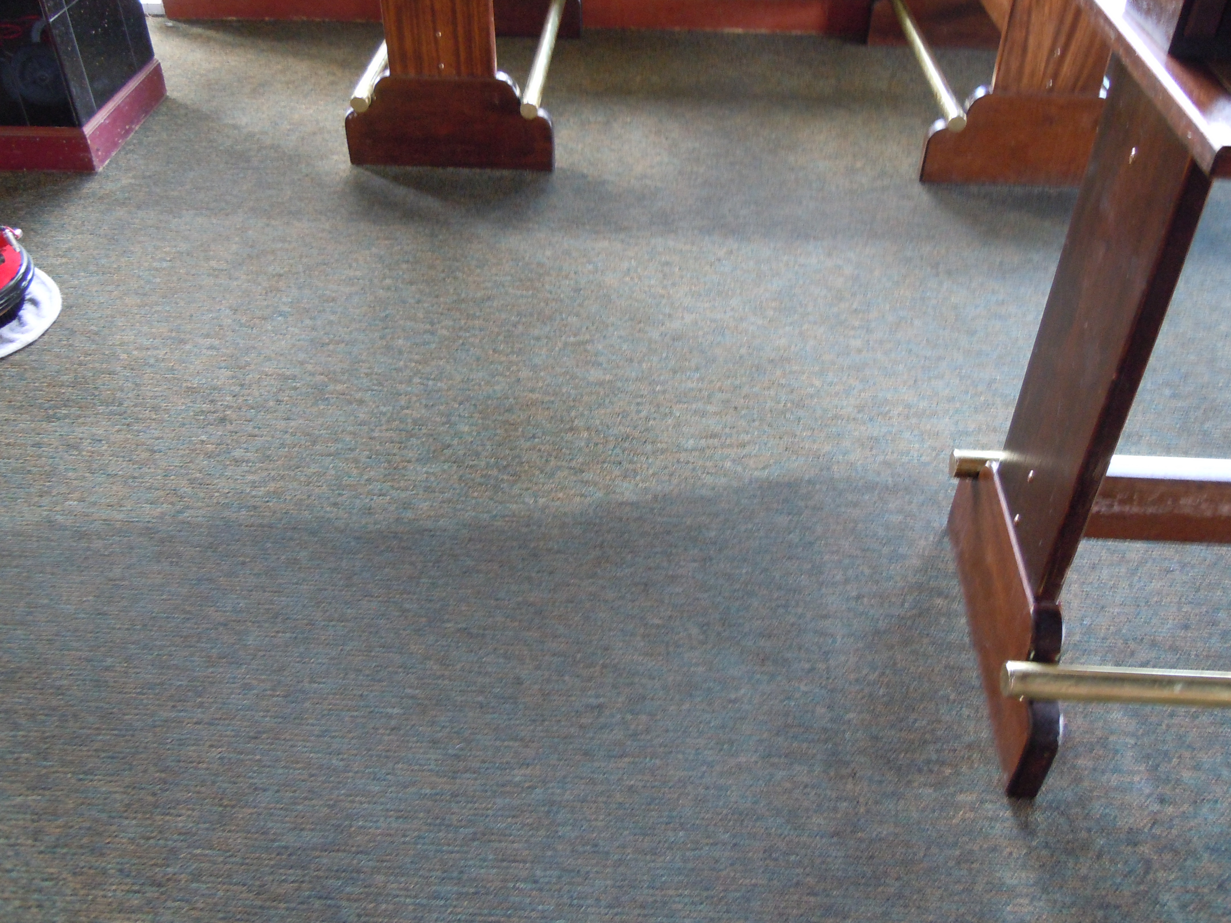

Old CCS Brute, using CCS blaze encap. Tackling the pathways that were worse than the rest. Used 18 pads for approx. 1500 sq. ft. Pads were very black!
