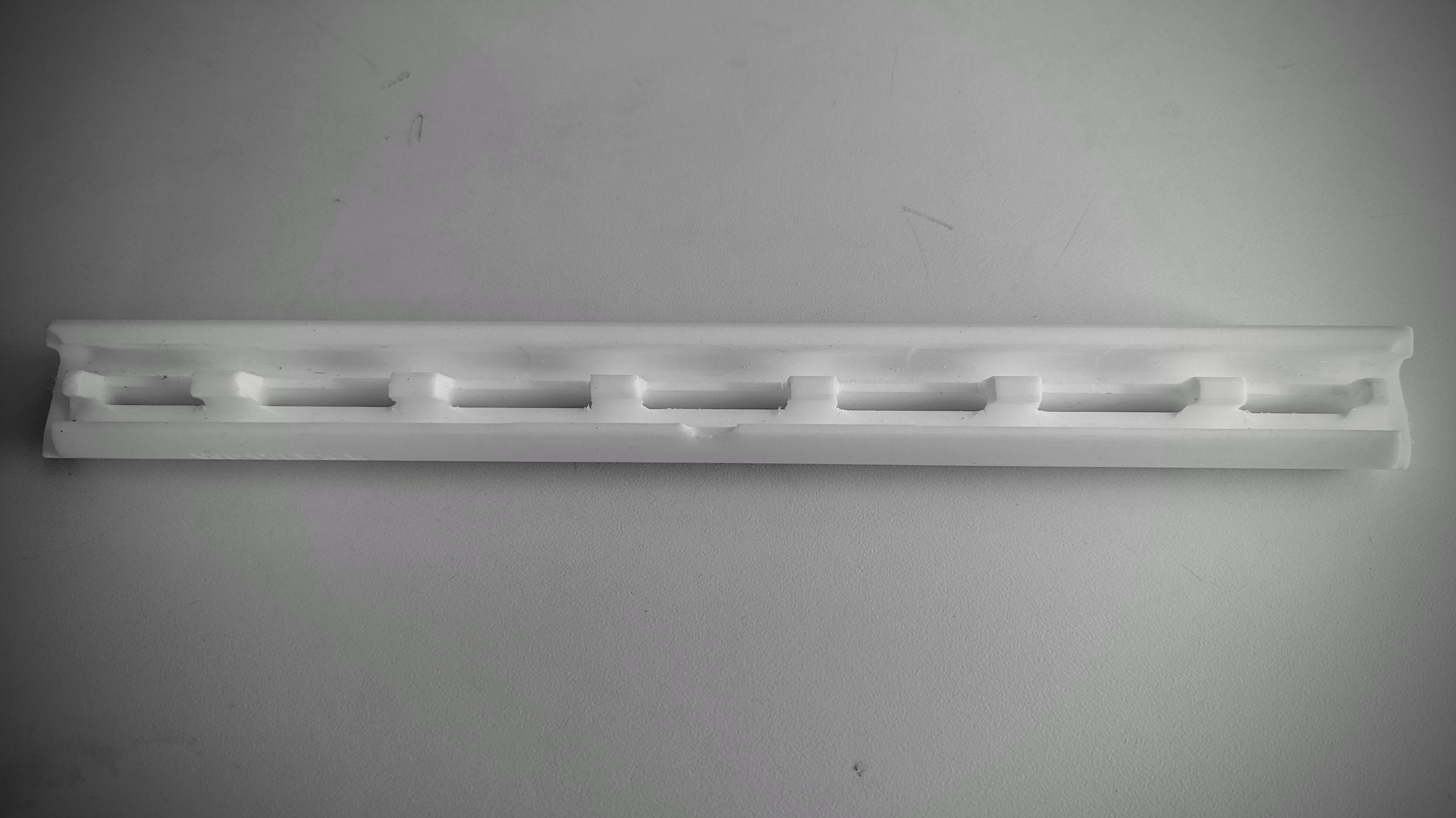

So Matt, if you are force fitting glides on a PCTI, you are bending them out of shape and creating the need for gooping, just so you know.
Cut a notch in the wing so the glide can be slid on stress free.

The next run will be a mikey design with no walls between the bridges..
