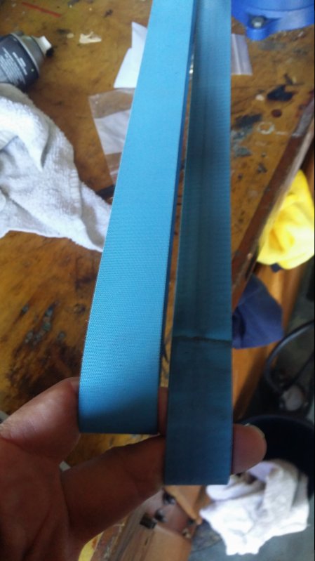

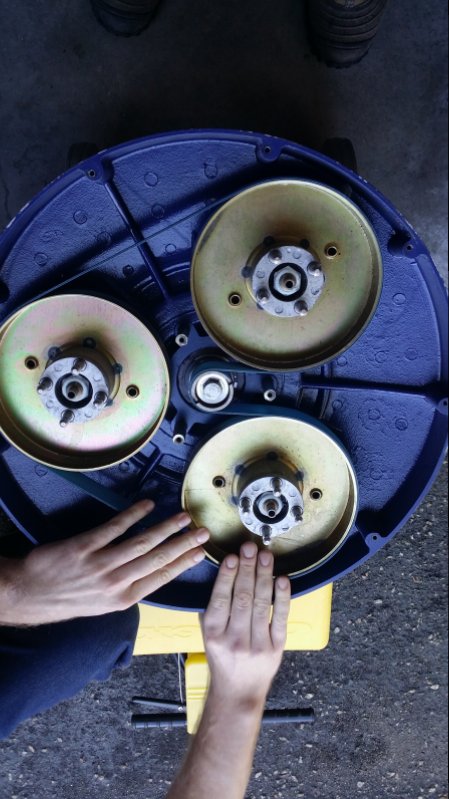

My older unit is bogging big time.

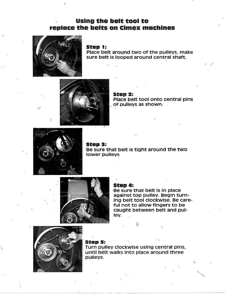

Is it self explanatory once I get the bottom plate off or will it require a how to video, instruction sheet or a call to Florida?

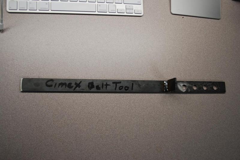

. I had to replace a bearing in one of the pulleys last week. Makes it much easier and safer.
