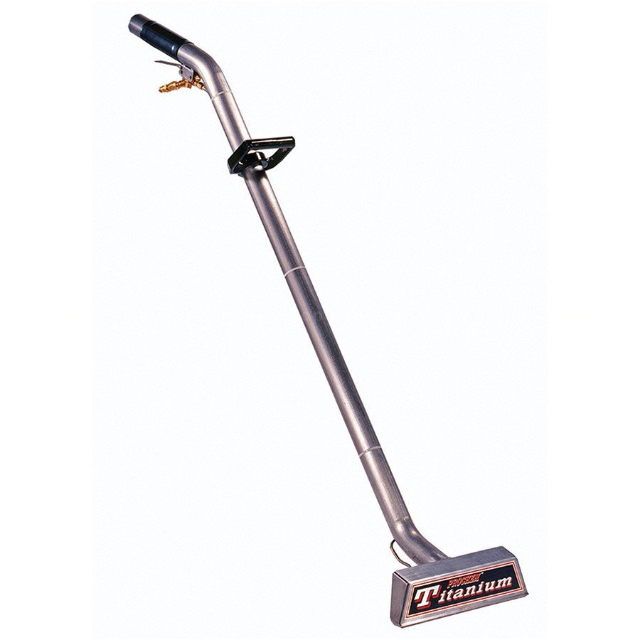

There’s also something to be said about these ergo handles, but nobody has made them right yet. Much easier to push a wand when your wrist is at a natural positive.
If Ti Prochem was 2 lbs lighter, it would be an ideal wand for me. When six jets don't leak, have an optimal spray pattern and flow, and the head is perfectly aligned with a surface, it's carpet cleaner heaven. Ergo handle and the gun trigger are essential for me. The weight is 9.6 lbs, not so much

There’s also something to be said about these ergo handles, but nobody has made them right yet. Much easier to push a wand when your wrist position
The side handle on Prochem Ti, in my opinion, offers the operator the most allowable comfortable swing. One thing is to have our body aligned with a wand, but the wrist on the side handle means freedom of movement compared to positioning your hand in front of the body when the handle is on the tube of the wand. Maybe is the matter of habit, but I like to use my ' big boy'. I have wands with two different lengths; 62 inches and 65 inches. Both feel right.

Am I the only one in this world who hasn't tried glides? I find them discriminatory towards the carpet. Would there be one that fits Proxhem Ti, a 13.5-inch wand? The wand locks down on cgd at 200 feet at times, but I keep swinging. We have to stay in shape somehow, right?
I'd be willing to try it if someone can recommend good quality glide that lasts a while .
Yes , I have four options for the PCTI.
Tearing your right shoulder and elbo apart and setting your self up for arthritis in your later years, is a horrible way to get your exercise.
If you scrub carpets clean with your wand, you are doing a discriminatory disfavour to your body, your company's reputation, your bottom line, your customer's investment and you're damaging the image of our industry as well.
Teflon Glides can last from six months to two years depending on how much cheap rental carpet you clean, as the protruding tackless nails eat up the ends of the Glide.
You can probably find one made out of a harder plastic such as delrin or uhmw or you can make one out of PVC or even a broomstick but none of them will serve the purpose of a Teflon wide and you're probably better off without them.
