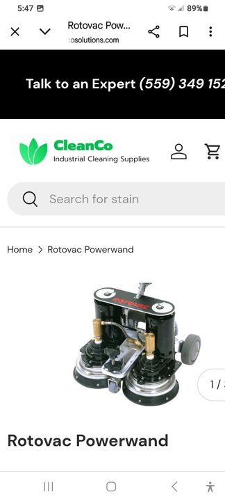

Be nice to see something like a zipper with a spring loaded cylindrical brush in the middle that you could easily push back and forth.
28,267
Like a Zipperized-CRB?
Exactly. Either one rotating brush or 2 small counter rotating brushes. One of my favorite all time powerwashing was the old rug Doctor power brush. Slow because you used it like a drag wand. Effective because of the scrubbing action. Imagine if you could push something like that back and forth like a zipper

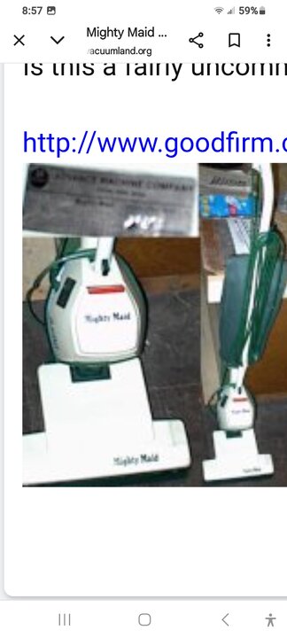

A vacuum that has a beater brush that goes to the edge on both sides. Back in the 80s when i did nightly office cleaning i used a German made vacuum cleaner called a mighty maid it wasn't very powerful but it was extremely maneuverable and went to the edge on both sides of the beater brush. Its big downside was that it pulled the dirt thru the vacuum impeller (like a kerby) if you picked up a penny from under a desk it would jam and take 15-20 minutes to unjam. I really really wish my windsor 12s would go to the edge on both sides!!

Thanks buddy
I remember when it was first invented but didn't know it was still around.
It looks sturdier than Version 1 as well

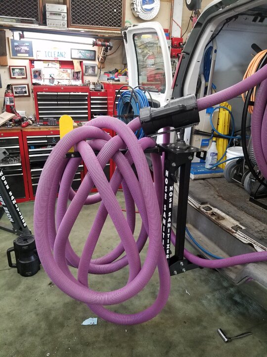

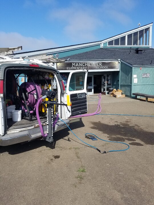

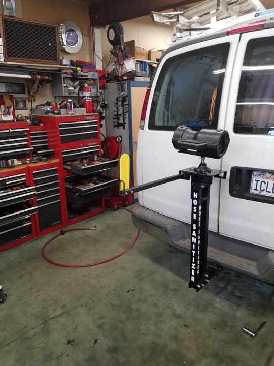

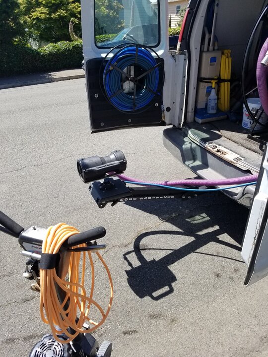

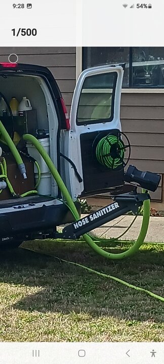

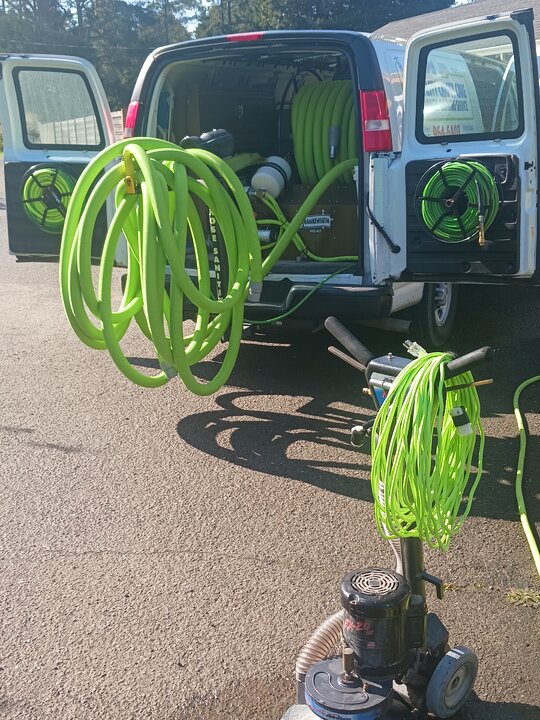

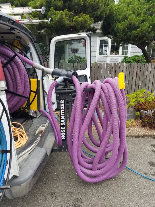

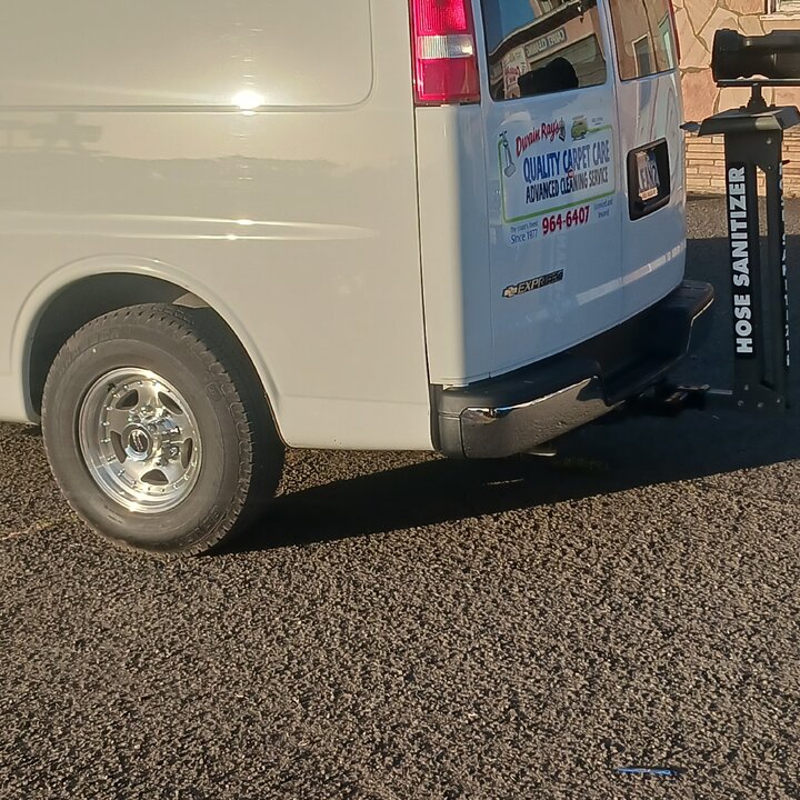

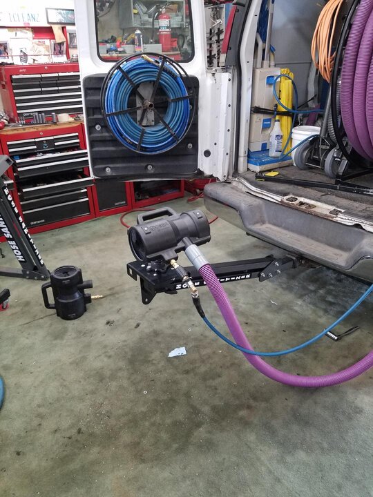

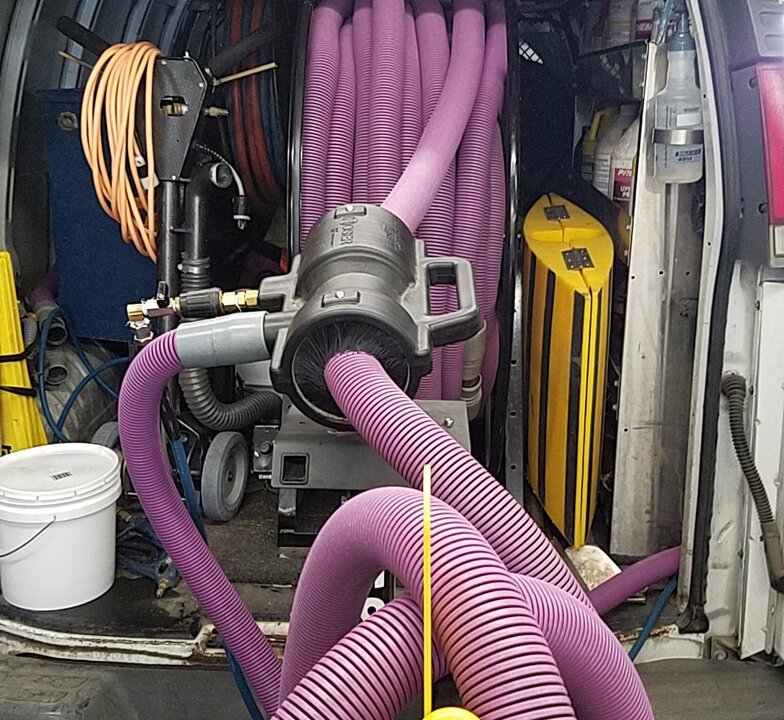

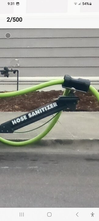

I'd like to see incorporated in that a washing device that automatically washes the hoses when you roll them back into the van with the hoses on a motorised reel.

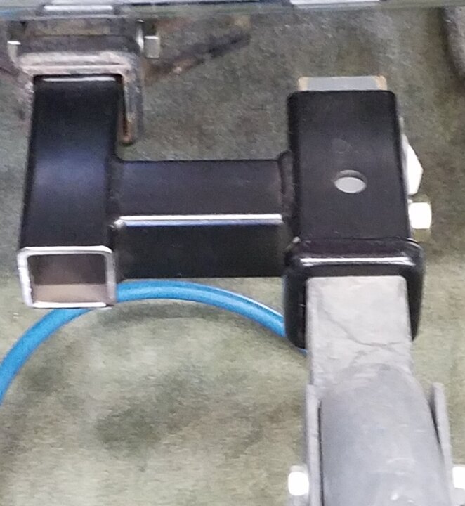

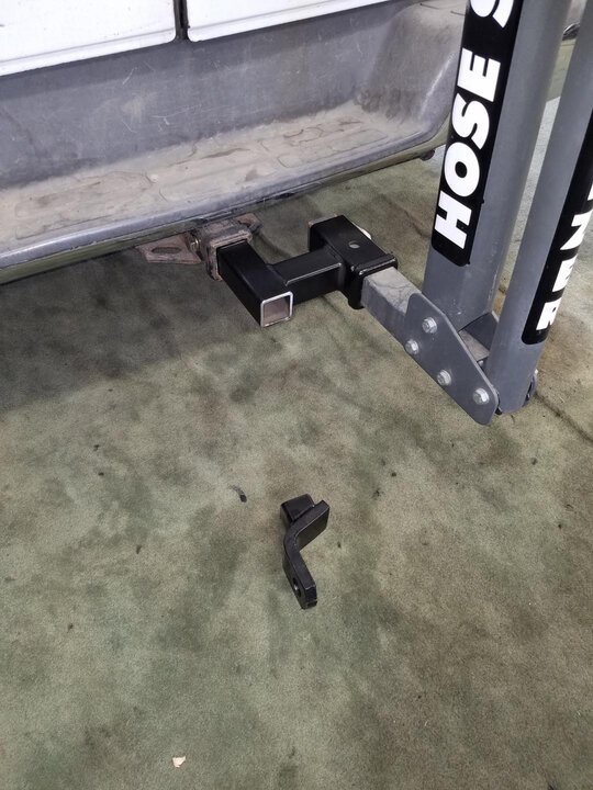

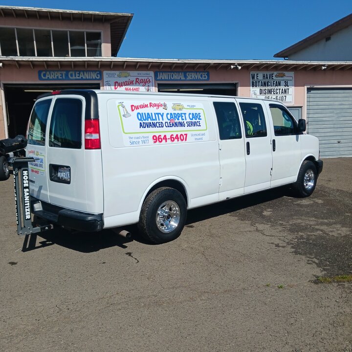

I built 4 of um outa a hoser, a ball joint, a parallelogram bicycle carrier and a few assorted parts. It mounts on the back of the van . I can automatically clean hoses when i put um in or when i take um out. I have one on each of my vans. Its simple to setup and use . I use it on every job, every time i put my vacuum back in the van sometimes 3 or4 times a day. I have dedicated hoses so setup take no time at all, just connect the solution& vacuum hose. It works best with an electric hose reel but can be used manually. I made a YouTube video search "hoser gimble mount "to see a 4minute video. It attaches to the van thru a 2" receiver trailer hitch. I even made an 8" offset because my hose reel isn't centered. Added benefit is that i had it lettered to imply that i care this much more than competitors. I clean my hoses, i get alot of comments and compliments on it even more than the iklean2 and iclean2 license plates on the vans

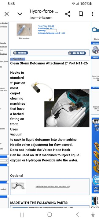

an inline defoamer tank should be on our wands.
I hate hitting a foamy area and going through the process of stopping to get the jug and sprinkling it everywhere.
Just turning a valve on the tank to get it sucked in our hoses would be nice to kill the foam quickly to prevent time loss.

This has been attempted in the past.
I forget why it didn't continue; it was either:
1. The vacuum was too strong and it overcame the needle valve and collapsed the bottle
2. Few cleaners at the time were experiencing foam problems.
3. The manufacturer didn't sell enough of them and lost interest.
Today, with the amount of VLM being done with high foaming products (you might be surprised the crap that is being used out there), and the increase of wool carpet and rugs that might require a higher foaming product for preconditioning, this might be an idea worth revisiting.

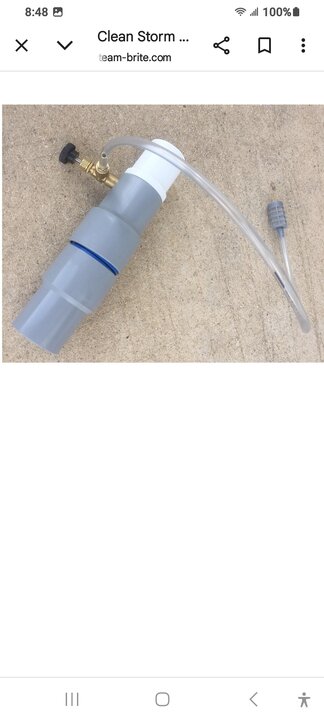

The wand mount defoamer attachment worked basically the same as this pictured below but incorporated a 12oz bottle and bottle holder. You had to drill a small hole to allow the defoamer to be applied. The draw backs were that the bottle had to be constantly refilled and it did address the problem of foam in the tank. However the problem of loss of vacuum was still there because the defoamer was introduced a couple of feet away from the carpet cleaning and you still had a wad of foam blocking till it reached the point of injection. I used one briefly on a drag wand in the early 80s
with the drag wand the weight of the defoamer was not an issue neither was laying the wand down and having it leak out . they still have versions of the inline defoamer attachments available if your looking for something to waste money on. A bit of advice, a better use for that money would be to light the charcoal for a barbecue 🫡🫡

Defoamer leaking out when you lay the wand down.

I made one out of PVC with 2 valves on it. One to supply the hose to the vac hose connected at the wand and the other to open at the bottom to feed the defoamer when the feed hose valve is opened.. Very simple and effective. Mine was just bulky and I put it together with what I had on hand in my storage building. If I had time to mess around again, I would find a something to connect and be mounted on the wand better

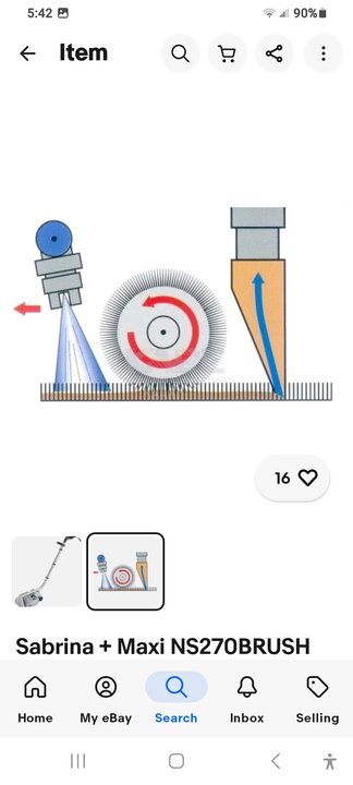

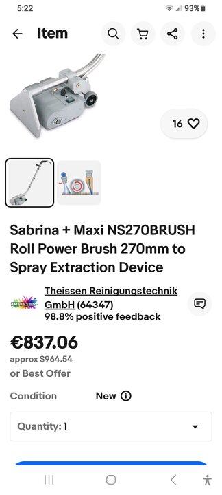

first glance i said "i want 1!" I thought it would be great in tiny homes, travel trailers & 5th wheels at the present time i use eighter my rx20 oe scrub wand to clean and a special 12"-5jet drag wand to rinse ive been looking for a good used roto vac for cleaning when i came across this i thought even better, till i looked into it first problem is its Italian and supplier is in Italy so parts??? Next the spray jets are at the back of the motorized brushes and the vacuum is in the front , so in the video shows it cleaning from the wall back theres a strip the width of the brush not getting cleaning solution plus its a thousand bucks. So with that said, Anybody out there got a good roto brush there looking to unload. Im still looking for one
Screenshot_20250621_172253_eBay.jpg Screenshot_20250621_174205_eBay.jpg Screenshot_20250621_174756_Chrome.jpg
28,267
Would be better if it had 3 brushes, maybe 4. Honestly, power brushes have been around for ages. I used to use a Steam Valet power brush in the eighties. Cleaned the Olympic stadium with one after Expo 86. Terrific tool but slow and water hungry.
