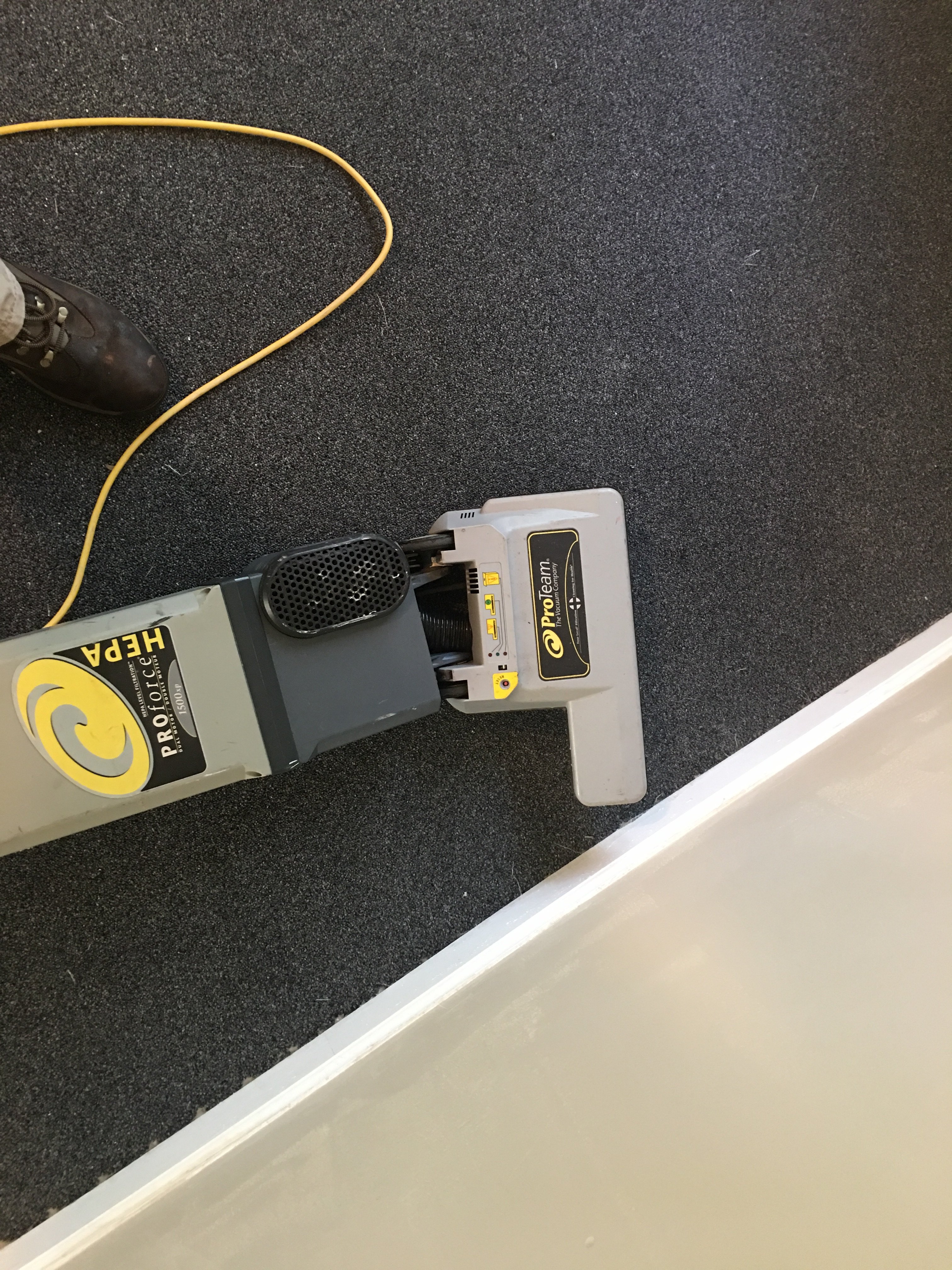

Yep. That’s Jimmy’s advice right there. It looks like I’m in the market for another residential vacuum. This happened about an hour ago
I should’ve used the ugly Hoover instead of this one

The thermal overload on the motor tripped. Remove the clog, wait about 30 mins and it will reset.
Yes that's what happened. I think the maintenance man was using it and we have several 17 year olds so I need to keep a closer eye on it I guess.
Unless it’s actually broken, ITS SUPPOSED TO DO THAT.... that’s how you change the power head, or put a different size head on... 12”-15” for example.....
