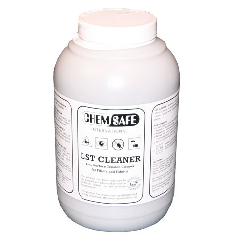

Its no secret the Silver Solution and ChemMax's "LST" are made by the same company...
there is some whispering going on about their similarities so lets do this...
LST is a liquid/sludge designed for use in soaking tubs or used as a shampoo through a 175/Cimex in a wash pit. The wide mouth jug is used to facilitate using a scoop as it doesn't readily pour out.
LST is 6 to 8 ounce a gallon. Cost is $40 a gallon. SS is $100 a gallon and is 1 to 2 ounces per...
LST uses different Fluorocarbons and far less of them
LST and Silver Solution will work equally on light soil situations but SS will outperform LST in heavy soil, and leave less residue
Both share the same SDS legally but ingredients are not balanced equally between the two and nor do they need to be to share the same SDS
This stuff has been around the 70's and was an Ed York fave.
