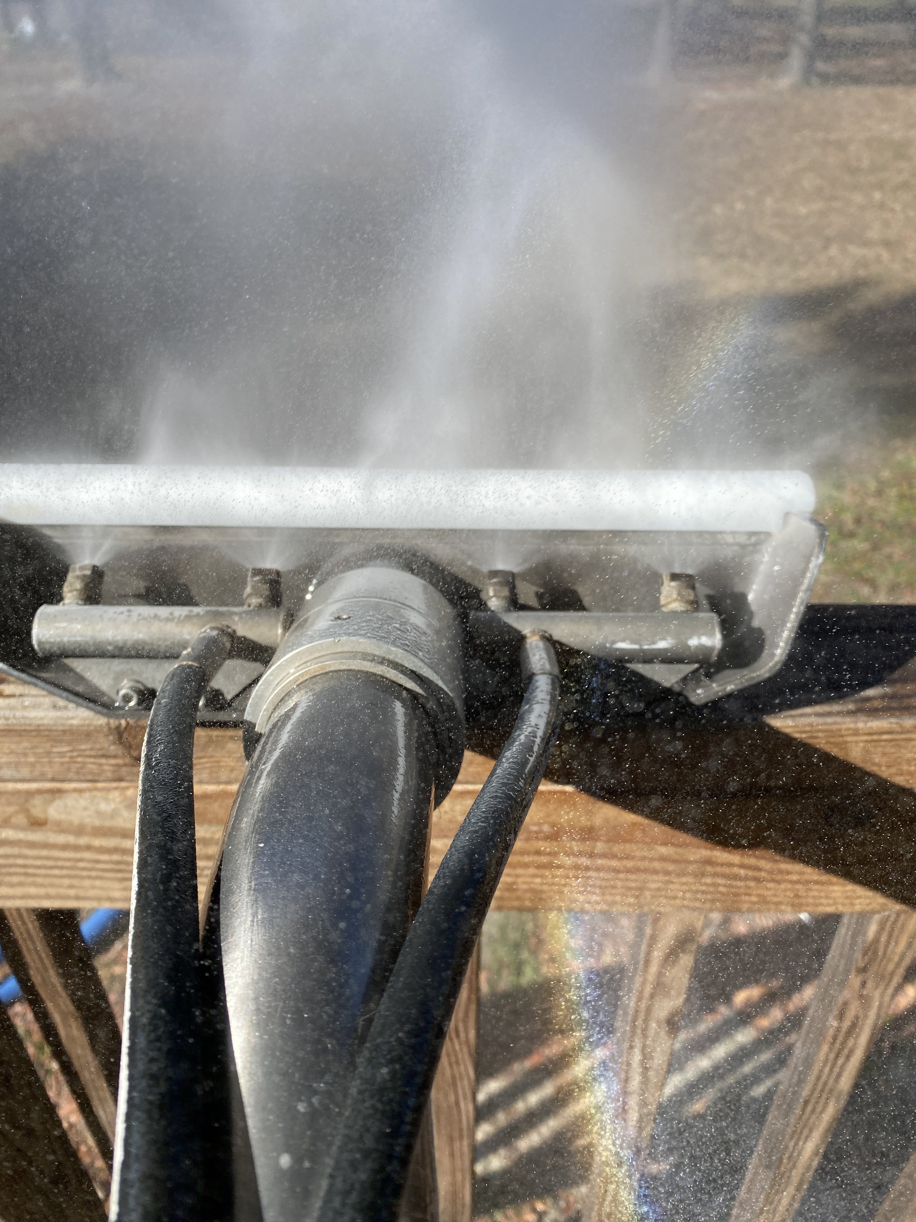

It’s working awesome
AADFE49C-9D03-4A63-B893-5EFEFBB16EDF.jpeg 929685EF-A798-4700-B91C-FC6B00B05CA6.jpeg
