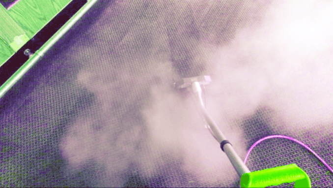

Will you Show me the water spray on the two middle jets? I’m curious if the vac tube interferes with the spray like all the other 4-6jet wands
Have you ever used a devastator? I have...I'm a believer...all your questions has already been answered and implemented...
