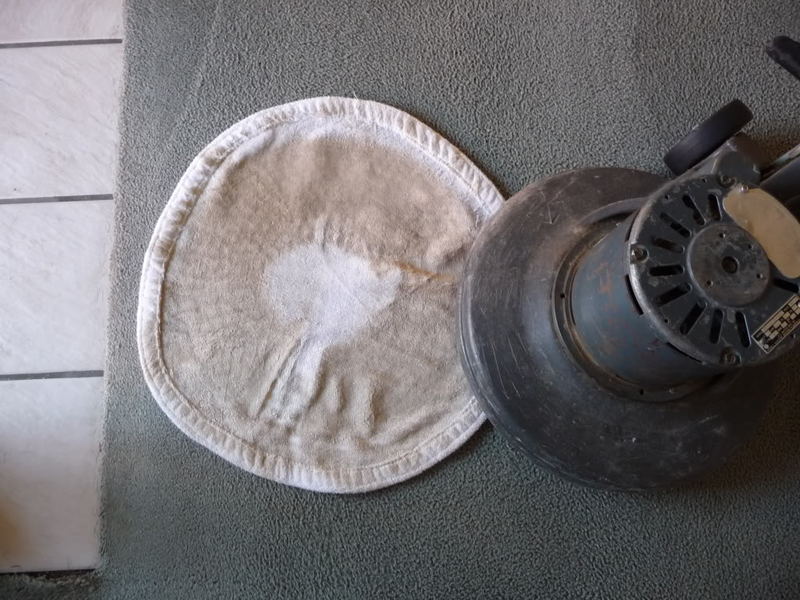

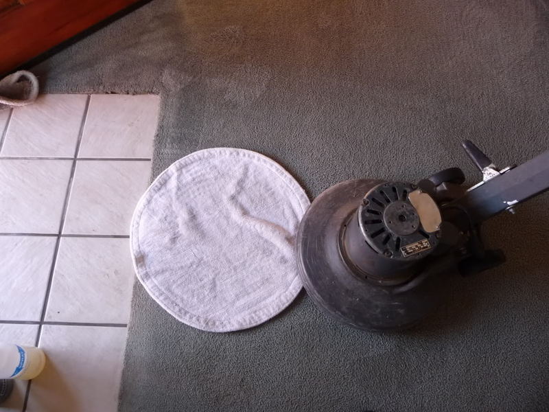

Back in the mid 90's SS ran a campaign stating that if Mrs Pifts could get dirt on a clean white towel from the freshly soaked carpet, the SS chimp had to reclean the area.
I see SS cleaning a ton of rentals and dumps around my parts. These carpets are usually loaded with embedded dirt. Considering SS's quick one step process I would guess that if (IF) the towel was not soaked in Teflon like some claimed, there was no way in hell that the towel would come up clean.
I think most of us know that if' you've already soaked a soil impacted carpet, more prespray or more wand strokes ain't gonna accomplish anything but more wicking. By now I've flushed enough rug in my pit to fully realized just how long it can take to get a rug/carpet fully "clean". And the sad fact is. Most low end/apartment thrashed carpets will never come more than 30 to 50% "clean".

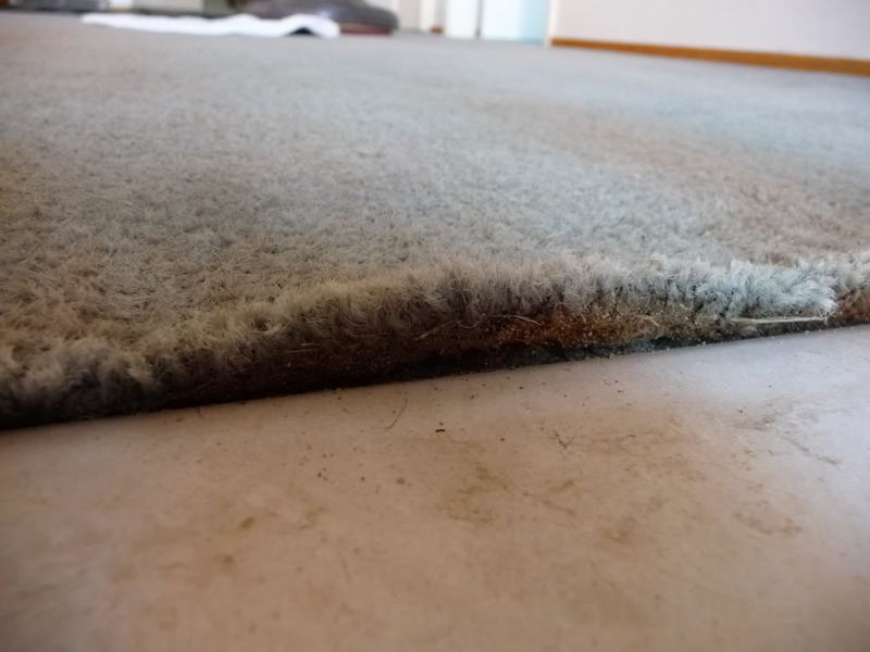

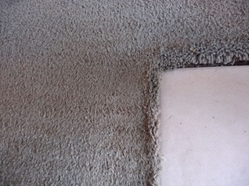

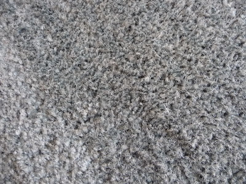

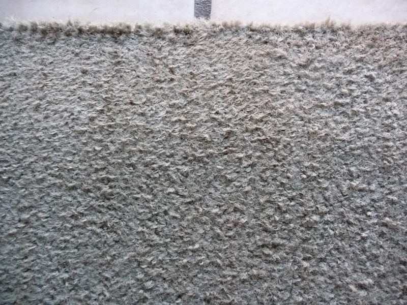

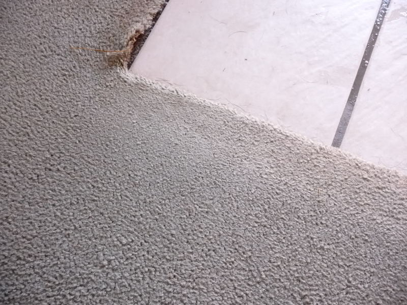

Below are some pics of a dump we "cleaned " today. After "Hello" the next words out of my mouth were, wow! time to replace this one!.
The new tenants accepted it as they have two cats and know that they will be destroying it.
We pre vacuumed, used Redline boosted with DD12 and 40 vol and scrubbed with a Tan pad. Wanded like mad with O2 rinse and post padded with a 40 vol/encap misting. Looked better but still was so impacted by the front door you could knock on it and it sounded like wood.
Cleanest/ least worn area I could find..
After wanding , before padding
New pad..
After 9 feet of entry area..
Done and looking like Vawter's lung.

A stiff bristle brush on the rotary, a slot glide and some Esteem CBS in the rinse would have cut your time down,reset the nap better and left a better appearance.
You could maybe even have been profitable at less than the cost of replacement. :shock:

The last shot was not groomed and yes, I do need a shampoo brush for garbage like this.
Who said it took long?
.48 was worth it to both parties involved.

Didn't say it took long just know it would have taken less time with a good emulsifier and a slot. I do quite a few of those types. Not proud if it but not ashamed either. :wink: A slot with the suction you have will rip more soil out of the backing n stuff like that than one can believe.
IF, your biceps are big enough to handle it. 8)

Have to disagree,I have used both and using a pad on pile carpet is like using a loofa on your hair opposed to your fingers(which would be the brush)
G
What your talking about is just changing the coarseness of the pad,which works great on commercial and hard surface,but it cannot reach the bottoms of any pile 3/8 or better in lenth.just like it isnt really effective with inset grout lines.You really should have a brush ,you hack

Shampoo brush may be too soft Mikey. Suggest you also get a tile brush for real grotty polyprop carpets - don't ask how we found that out :oops:
