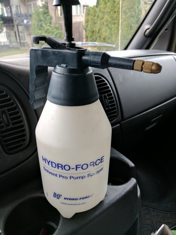

Cleaning out my shop. Found this sprayer but doesn't seem to hold air. As you pump it up, you can hear the air hissing out. Does it have a gasket that can be replaced where it attaches to the filler neck, or should I just toss it.
it's just a viton O-ring isn't it?
well stocked hardware stores will have one
or just go to Home Depot and get another one for $12 bukz instead of $30
HM hasn't had a pro-grade 1/2 gal sprayer since they discontinued the wide mouth one years ago

Thanks, I'll check next time I'm at home Depot. 2 local suppliers haven't a clue even I know I bought it from one or the other.

The sprayer you have is a B&G model similar to the one in the Amazon post. The Solvent Pro model had Viton gaskets and seals instead of the buna rubber that is in the Amazon sprayer.
I agree with finding a Viton O ring at a local hardware if you can.
