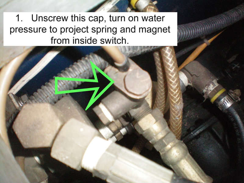

Jayhawk is talking about the brushes in the generator, but that's not your problem since your heater turns on when you pull the trigger
Here is your problem

This worked for us now our heat is better than ever
on second thought, it may not be your problem because your heat kicks on but it's still good info and worth the Tat's

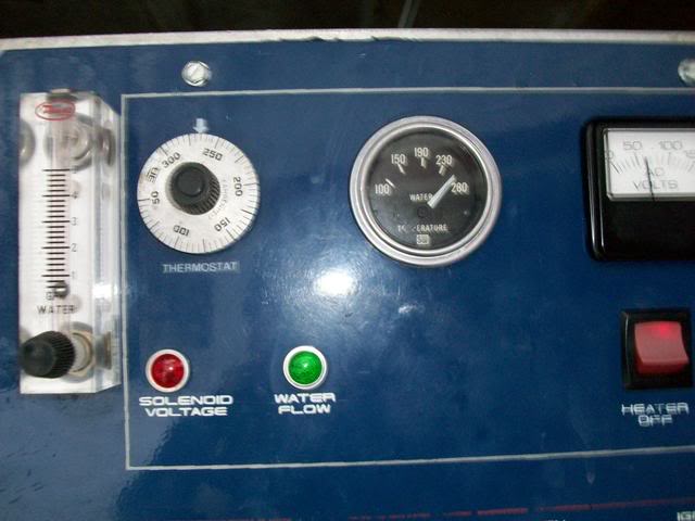

I bought an igniter for the re-TIRED PM once at the local HVAC supplier and saved a few bucks
Since vEEgs had mega heat before, then didn't, and now has mega heat again.
I'll chock it up to OPERATOR ERROR and figure he just didn't know wtf he was doing......
Damian must of found the red rocker "on-off" switch of the front panel...
Yo vEEgs, it's the little red thingie on the right in this pic
Mash on the top part of it when you want heat.
mash on the bottom part when you want to stop
:mrgreen: :mrgreen:
