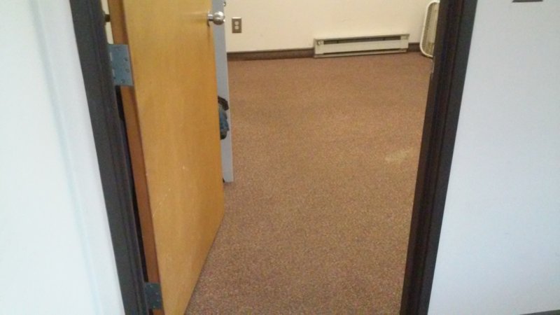

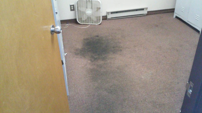

I relied on a wand to clean this last month at a factory. This carpet is older than the walmart's carpet.
No hack here.

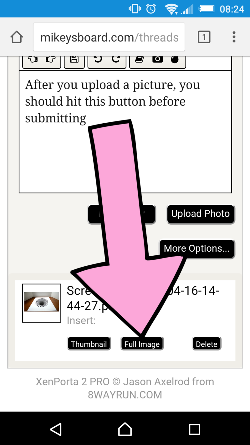

After you upload a picture, you should hit this button before submitting:
That wasn't my problem. It was how it recorded it. I laid the phone on it's side to make it record full screen, instead of laying it upright, but it still recorded like it was on upright position
Zee
Nov 2, 2007
6,162
SoCal jungle
I meant for you to show your pictures... I didn't even look at the video.
